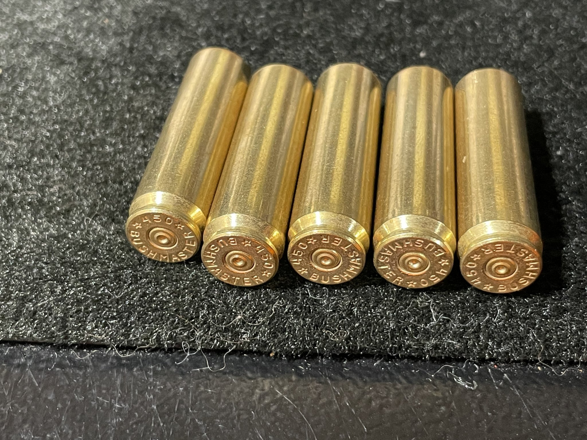

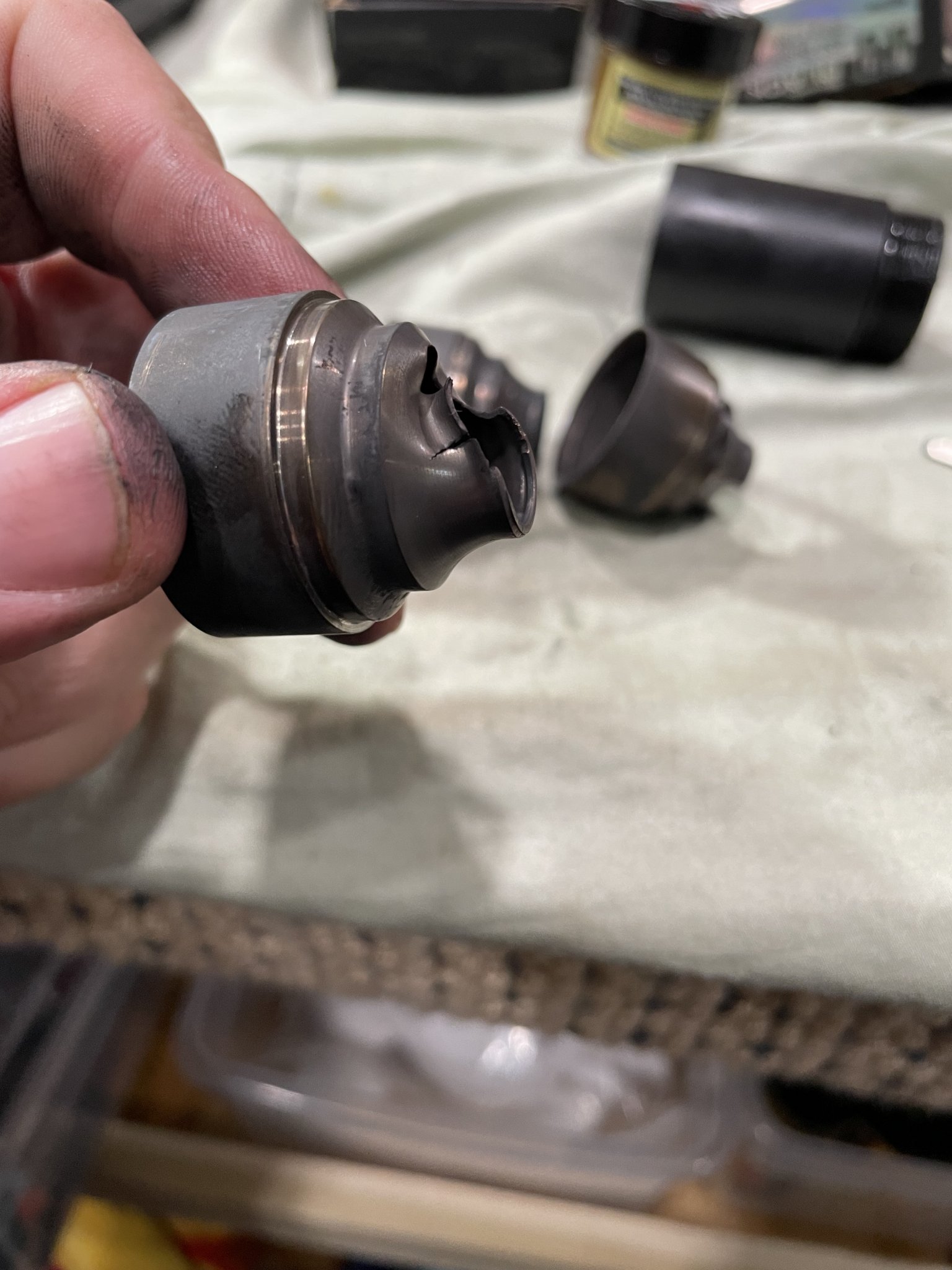

Had the new DT SRS Covert out the other with the Bartlein 450 Bushmaster barrel.
Gun wasn’t consistently shooting. Could’ve been me (I suck) but normally I can shoot some good groups. This thing was shooting well but maybe within 4-5” at times throwing shots.
I was shooting Bear Creek Ballistics 459 bushmaster 240gr copper projectile moving at 2590fps (which is cooking for 450bm) I chrono’d mine at an average of 2515fps

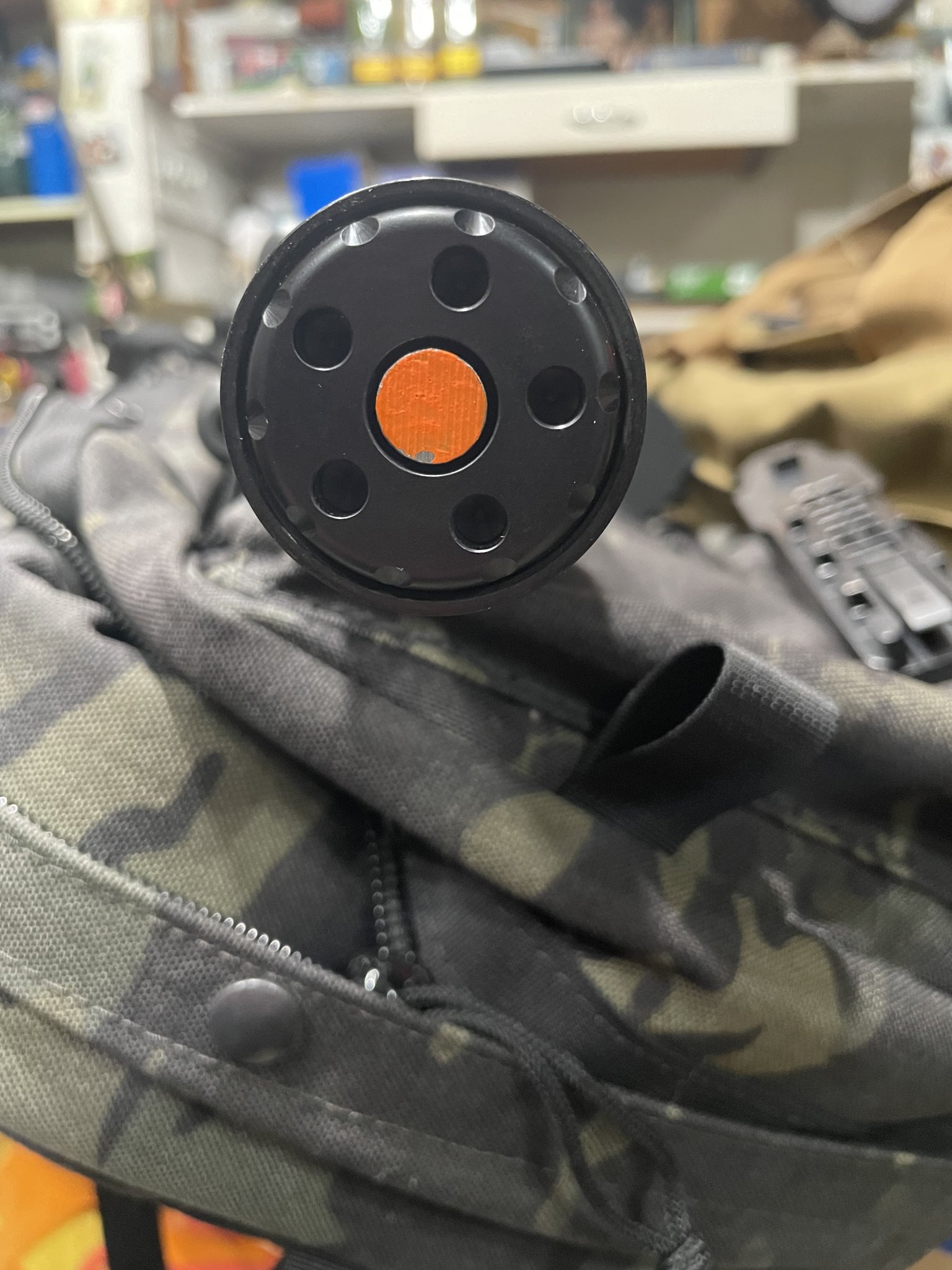

Anyway I was using a Rugged Obsidian 45 silencer. After taking it home and cleaning it I noticed the front baffle was completely destroyed. Doesn’t look like a baffle strike to me but almost a pop can being crushed. Maybe that had to do with accuracy inconsistencies??

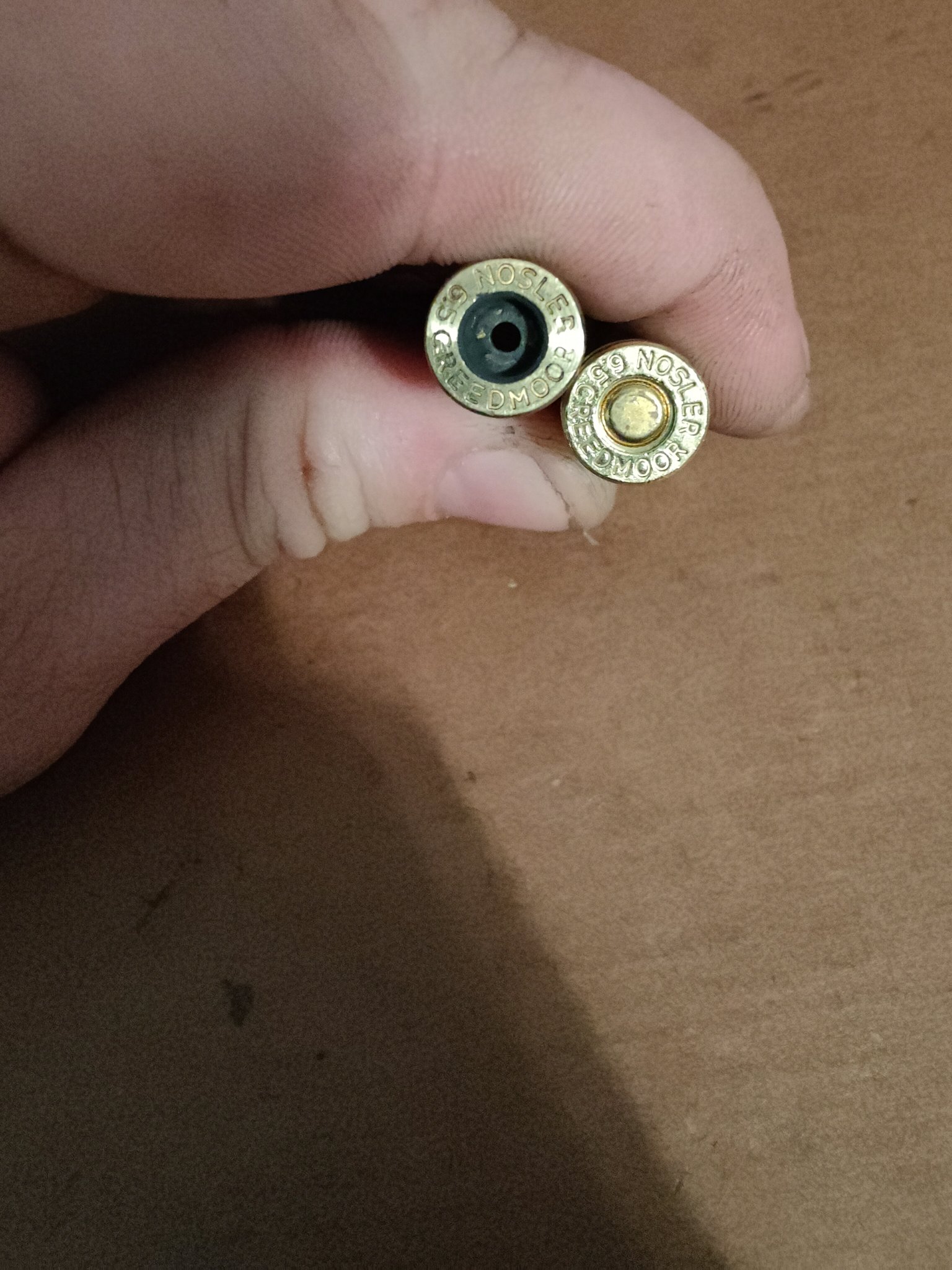

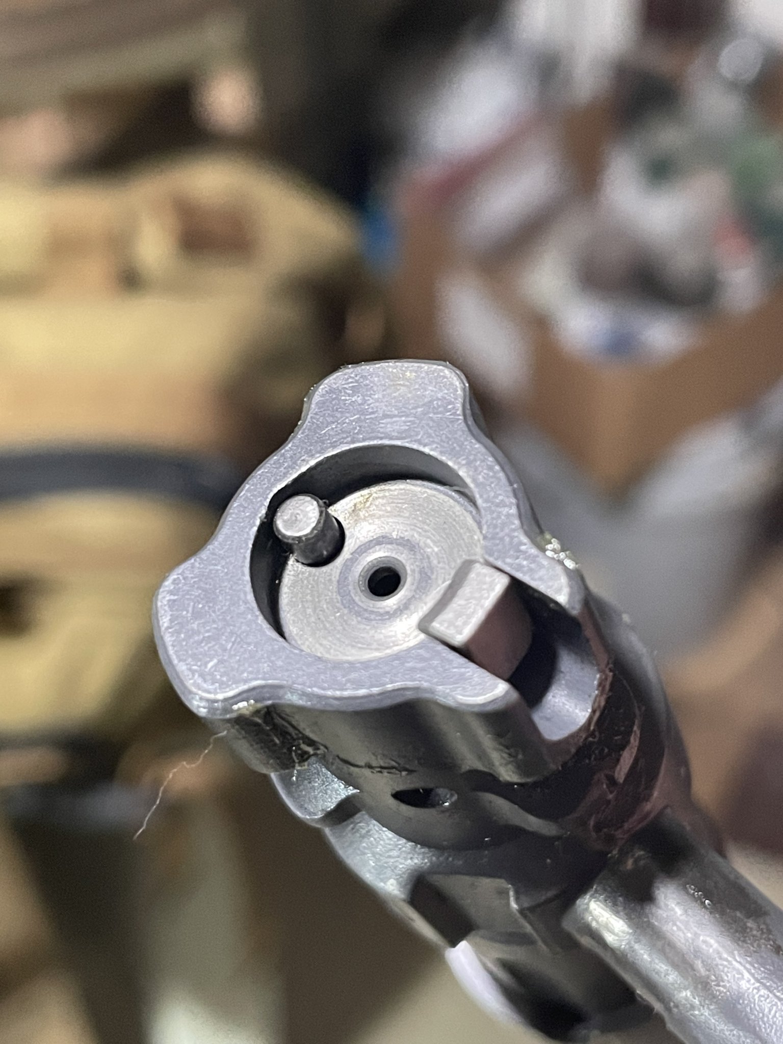

Then after further examining my brass. Every single primer is protruding out. I contacted the ammo manufacturer (Bear Creek Ballistics) and they seem to have never had these issues using a variety of different firearms.
He pointed out that the chamfer on the firing pin hole is extremely large. Thinking that maybe it’s out of spec or the chamber pressure is extruding the primer into the chamfer into the bolt face.
I have not shot the firearm with the 6.5cm barrel due to wanting to sight it in for gun season here in a few weeks. Planning on hitting the range in a few days and trying some factory Hornady 250gr ammo along with no silencer or maybe my VERS 458 can. Bullets were not keyholing. View attachment 7731114View attachment 7731115View attachment 7731118
I‘d definitely shoot it without anything on the barrel with the same ammo to see what happens. the loads don’t look over pressure because the edges of the primer are rounded. Primer is just flowing into the chamfer. No idea why the new boly is like that.
Do they all have that big of a chamfer on the new A2 firing pin hole bolts?
That's a baffle strike. Did you shoot any rounds without suppressor or check concentricity of threads?
I did not shoot any rounds without the can. I will this next time out. How do you check concentricity of threads? I just looked down the barrel with the can on and used a mccaster car steel rod as my suppressed alignment rod and it seems to line up fine. Wouldn’t it be odd to have a baffle strike on the first baffle but not the other ones further down the line?
Used my homemade mccaster card alignment rod which fits snugly in the 450 barrel. Looks lined up to me. I make sure every 1-2 shots max using direct thread to always check and make sure the can is secured tightly so I know it wasn’t loose on there.
I had a strike on only the 5nd baffle of a can with 15 baffles. Anything can happen. Mine was chocked up to an unstable round per the suppressor mfg
Interesting. Anything can happen is right. Anxious to get this thing back out either Sunday or Monday and shoot some normal Hornady rounds and this high loaded stuff. See wtf is going on and if I can get it to shoot better than a shotgun
.452”vs .458” .45 Caliber? On the the baffle strike?
Surely the exit hole is .460” or better.
I don’t own any .45 caliber cans but my first muzzle brake (brake: as in “stopping” recoil) split on the first Federal Gold Medal Match 168 Sierra HPBT factory round fired from my Ruger 77V .308 Winchester.
Turn out the exit hole was for a 7mm (.284”) projectile….Company installed another brake.
Can’t deny the OPs primers match the chamfer on the firing pin hole.
I’m not thinking they’re over pressured. Shot 3 rounds of hornady 250gr FTX factory loads. The primer is flowing into the chamfer on them as well slightly. Will get out next week to do some accuracy testing without a can on
I'd check with DT as to why there is that chamfer on that bolt face - it is unusual, and manufacturing "irregularities" are well documented on these guns.
As to the baffle strike, I'd worry about instability of the copper solids and check length and twist.
Reactions: HenryTheAce
My lapua size bolt also has that chamber around the fp hole. No big deal, just have to push primer out if you're checking fired headspace.

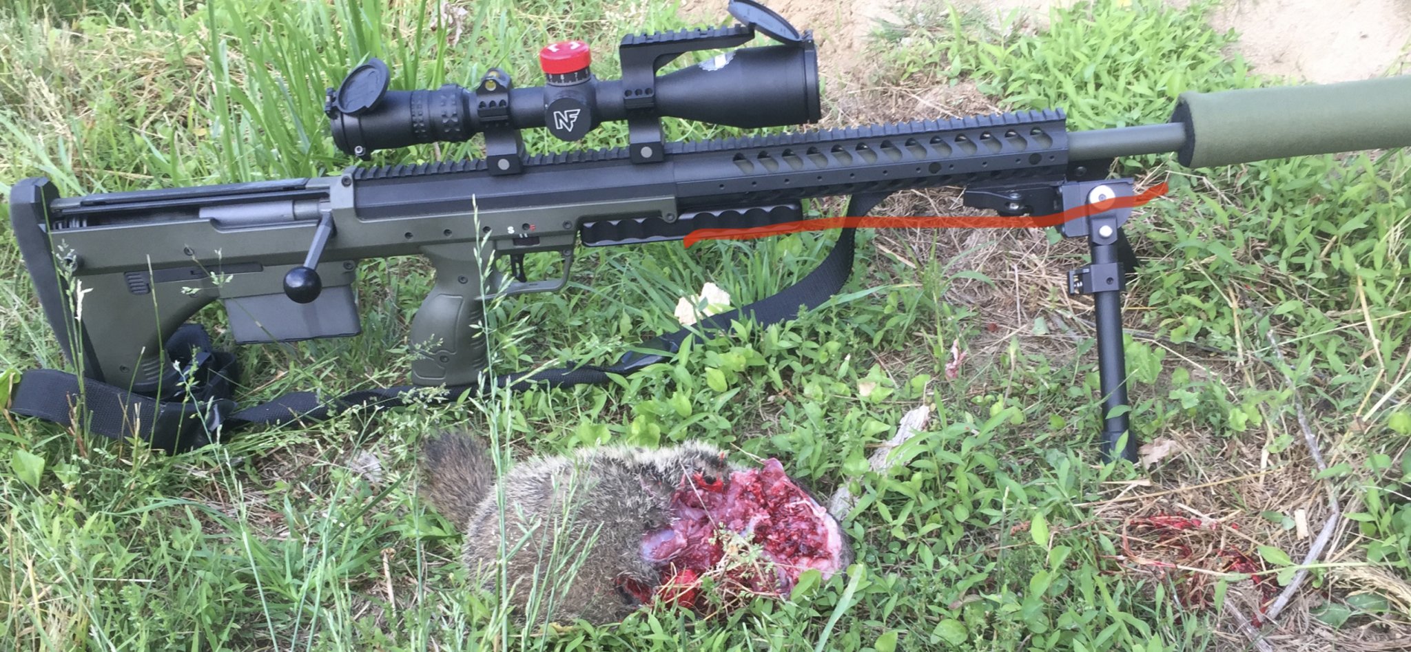

On the cue of @deersniper I went over to check out Salmon River Solutions and got in contact with him about making an SRS for SRS rail. Sent him a chassis to work with today. We'll see what he turns out. I was sure to make it very clear we wanted Arca ALL the way back to the trigger guard in addition to a few other features that I would have liked to see.
Anything y'all want me to add as far as requests go before he gets to work?
I fbi n
I think back to the plastic would be fine
Back to the trigger guard would cause a high bore over rail height
I actually asked him to step it down. So, in theory, the rail rides close to the handguard the way to the plastic and then drops down to the chassis panel bottom, if that makes sense
what about if the plastic was cut in front of the trigger guard?
