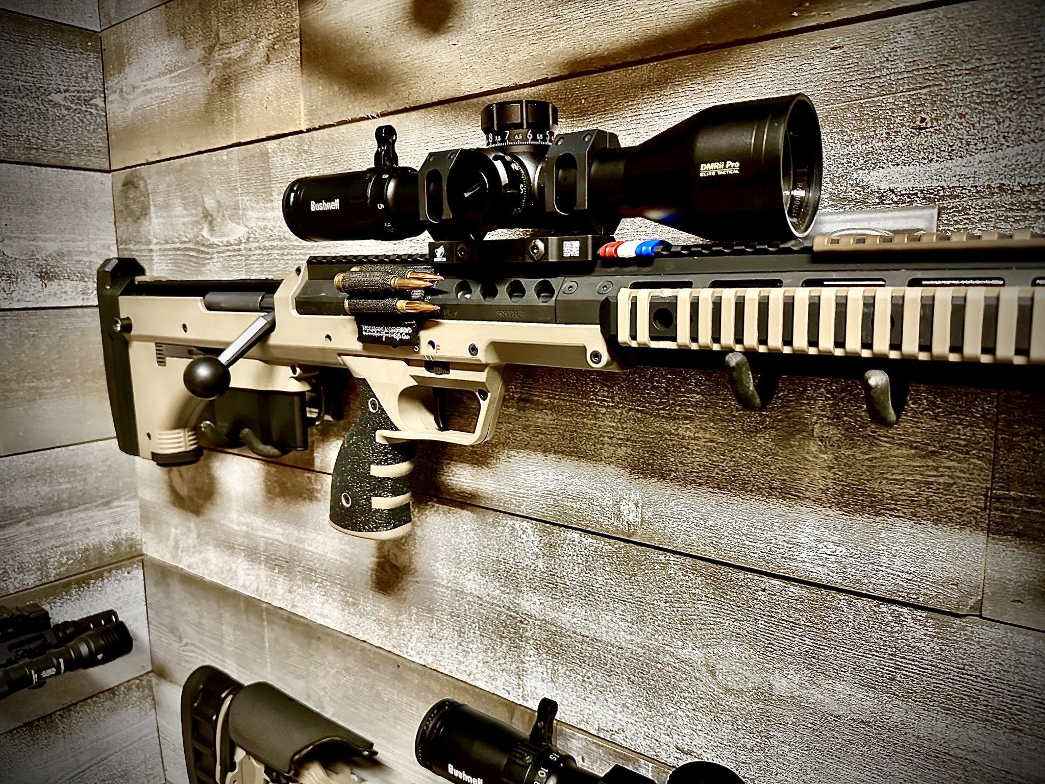

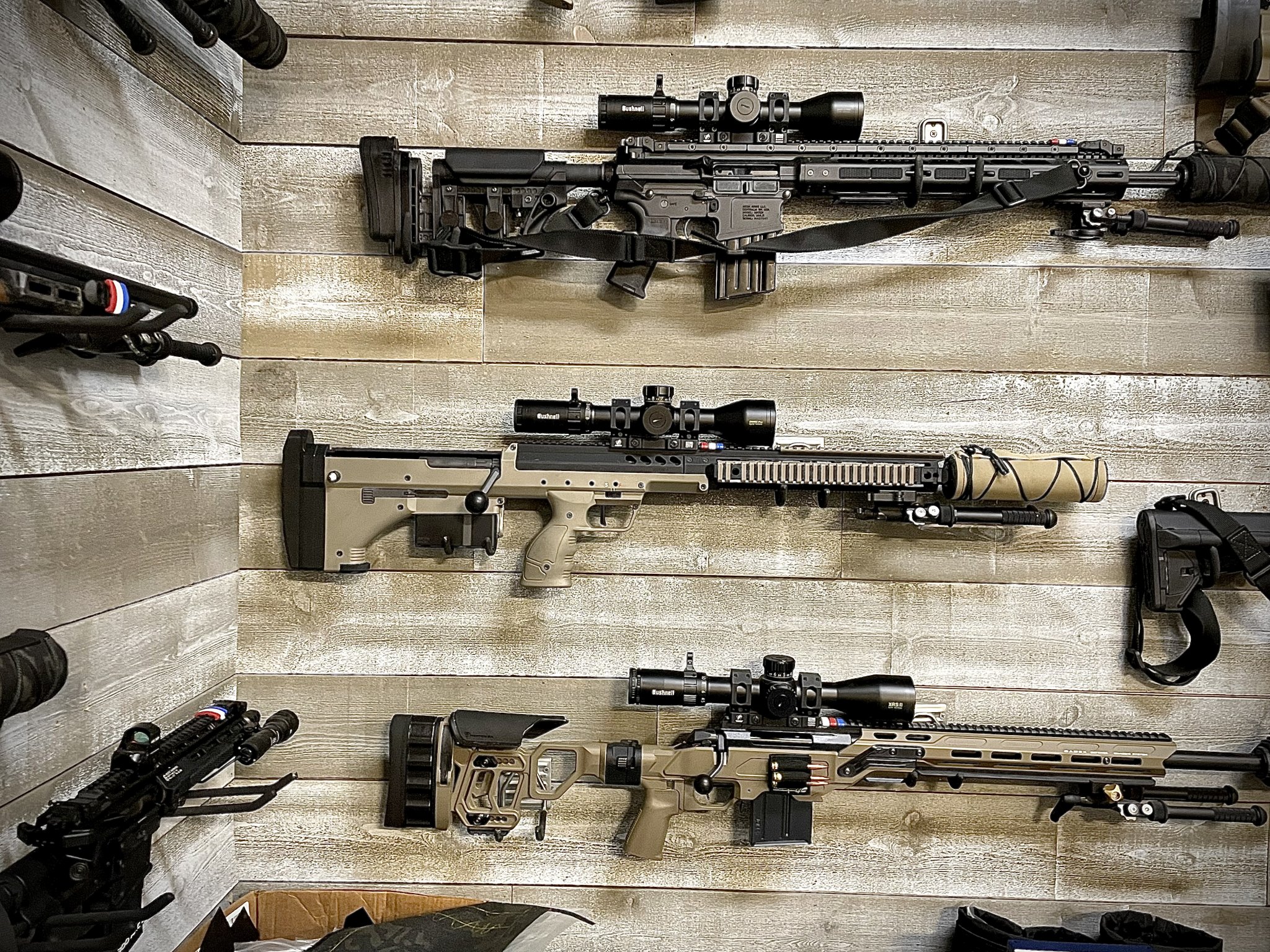

I like the way you did your safe room walls!
Looks classier than slat wall.

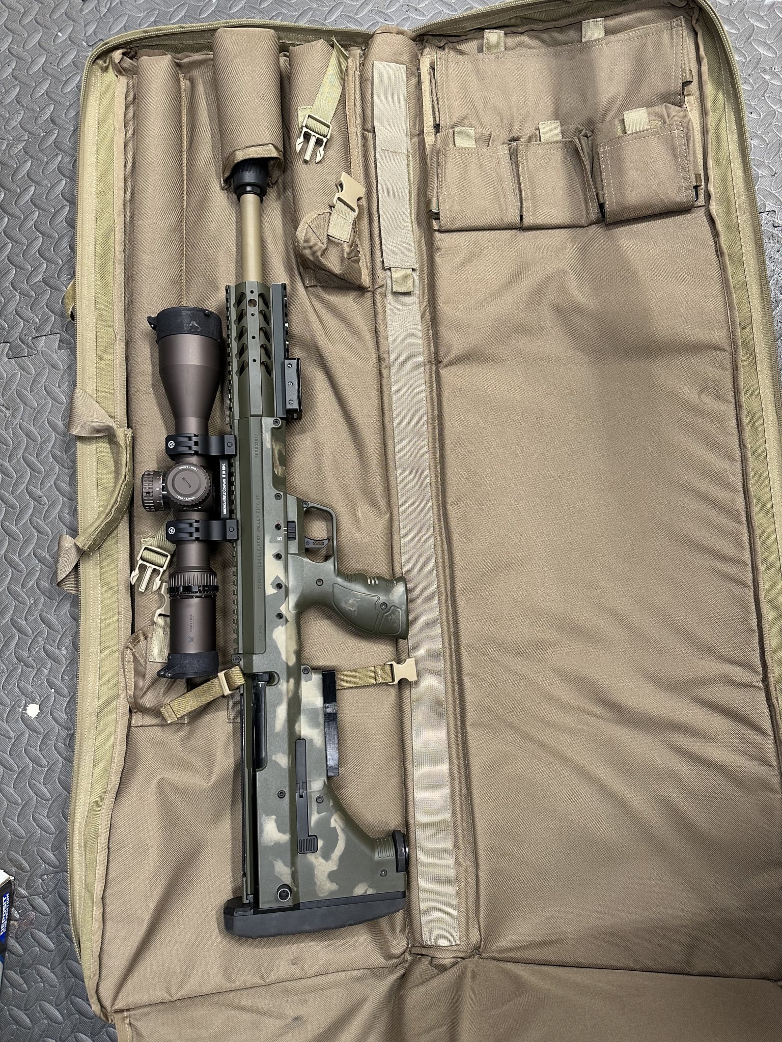

Here’s the DT Soft Case with a 19” barrel and a 7” can. I measured a little more than 2” to spare so the shooting mat would fold over and close. Looks like you would have an inch to spare if you wanted to use the soft case and keep the suppressor attached.

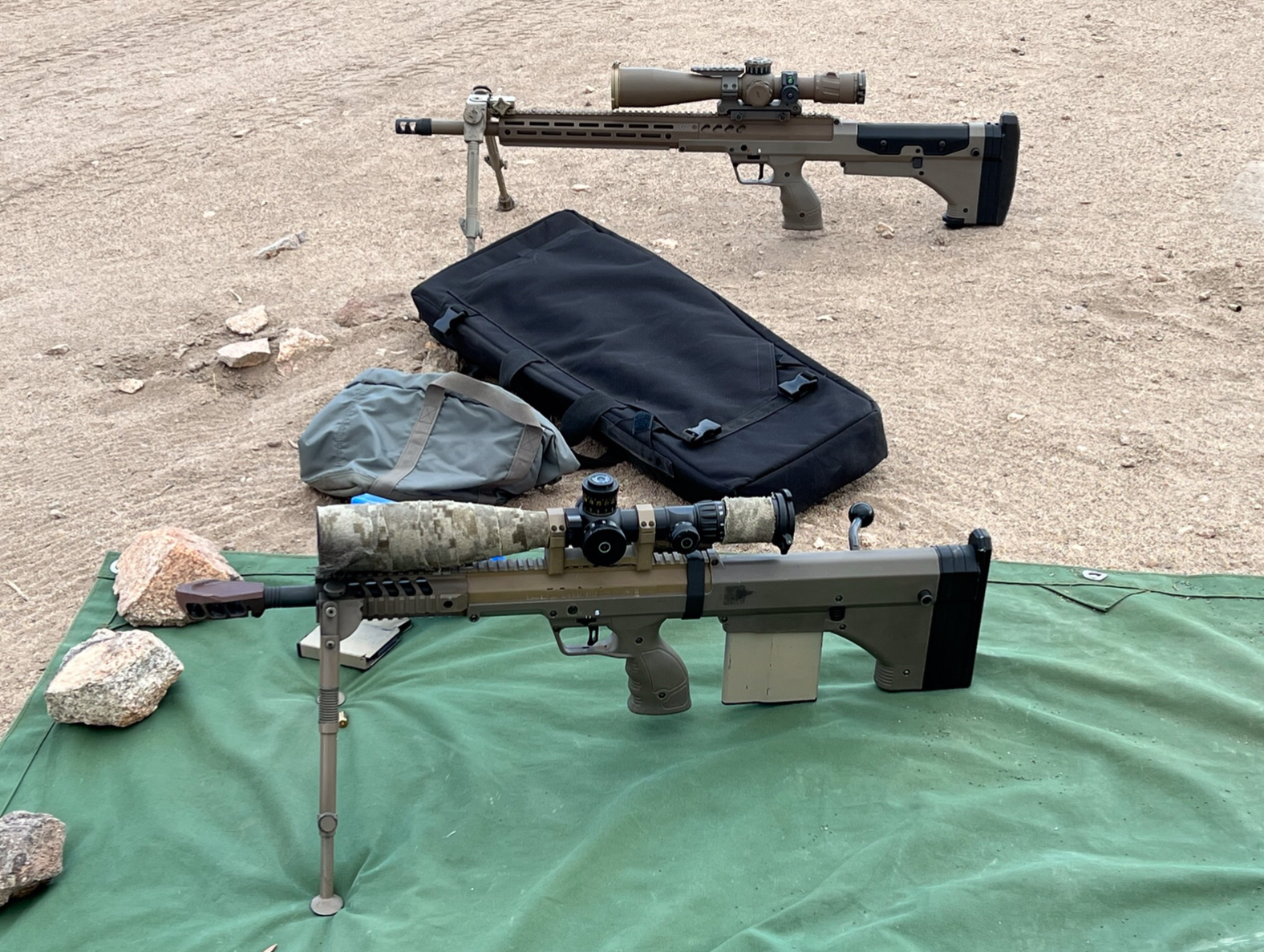

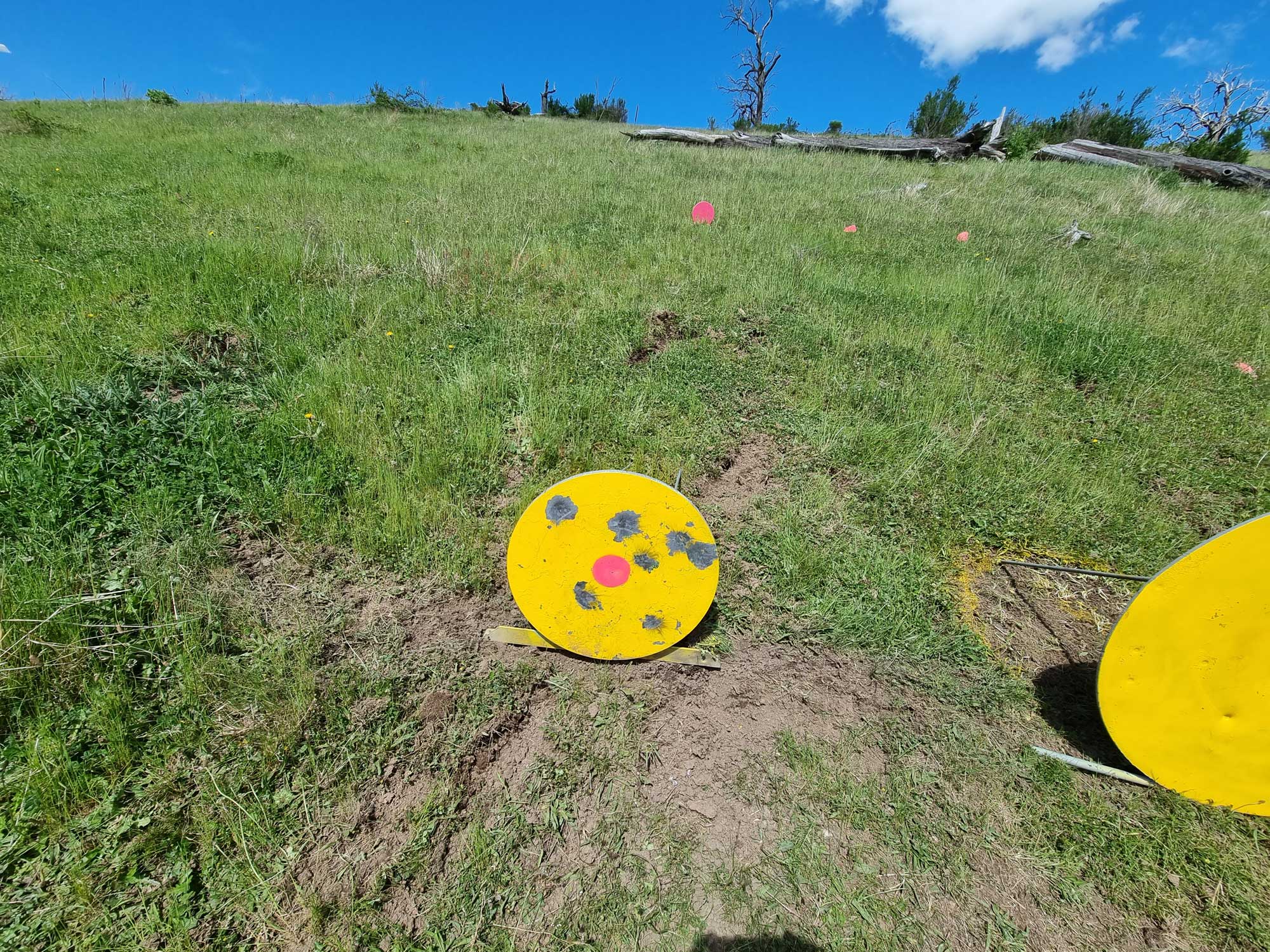

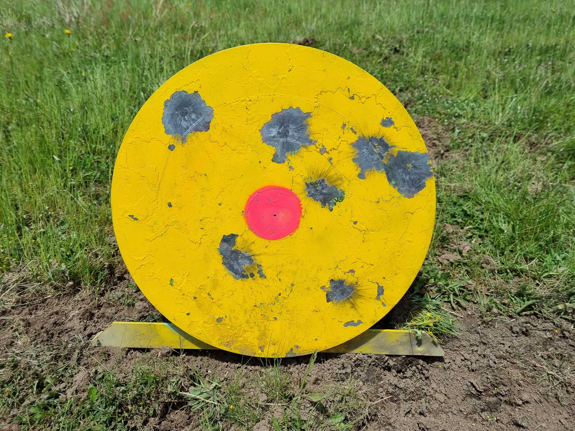

Today we did the 1 mile ( 1760yds) thing....... of ALL the rifles and calibres i have ever used at this distance the 50bmg was by far the easiest to get consistent strikes on the plate!!
8 shots fired...7 hits.. ( plate is 22" dia)
BIG is BEUTIFULL !!! :LOL:

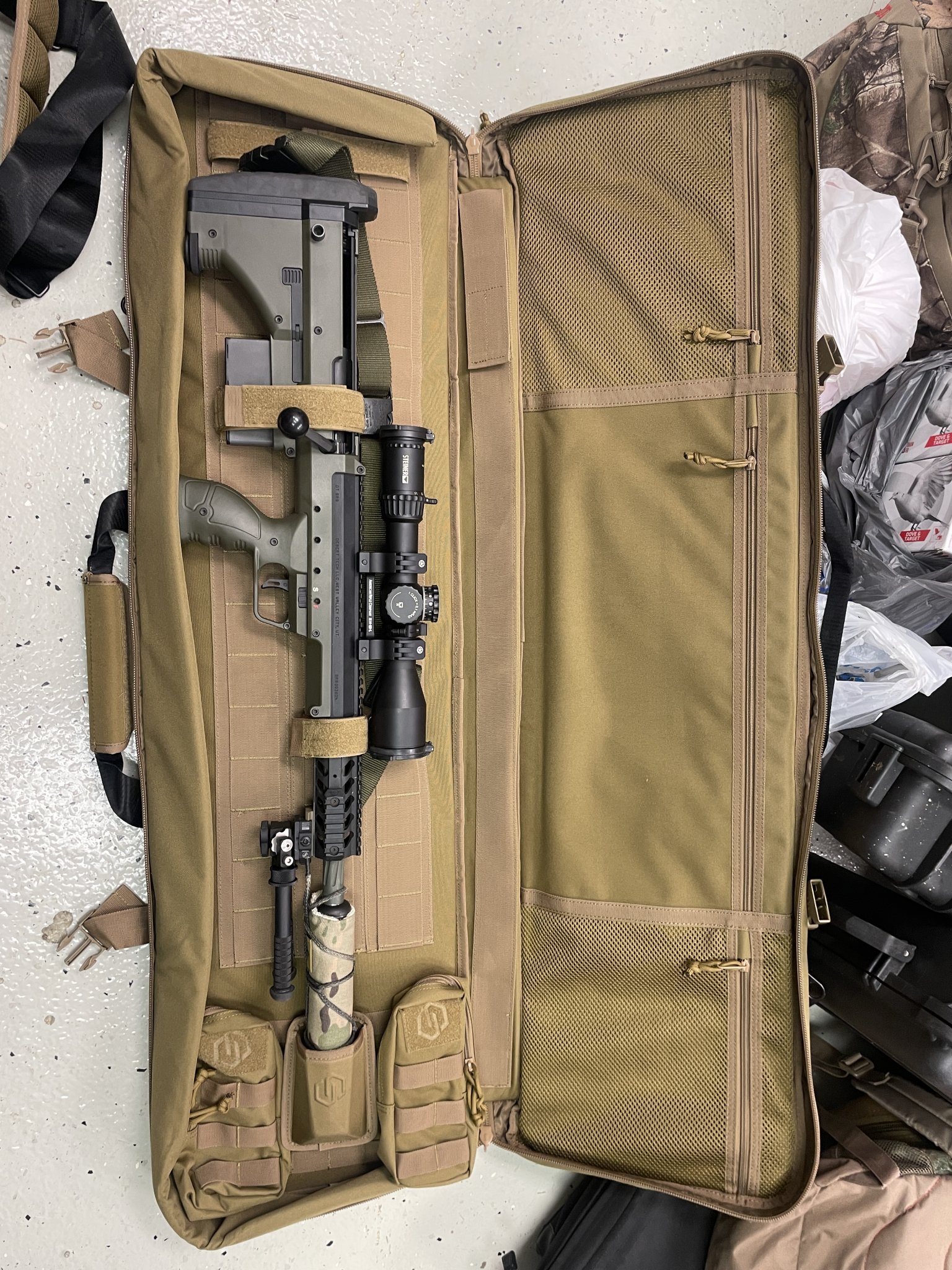

Just got this 47” savior specialist lrp in Friday. It looks real nice and rifle fits good.
The outside pocket is like 36” so i can put barrels there.

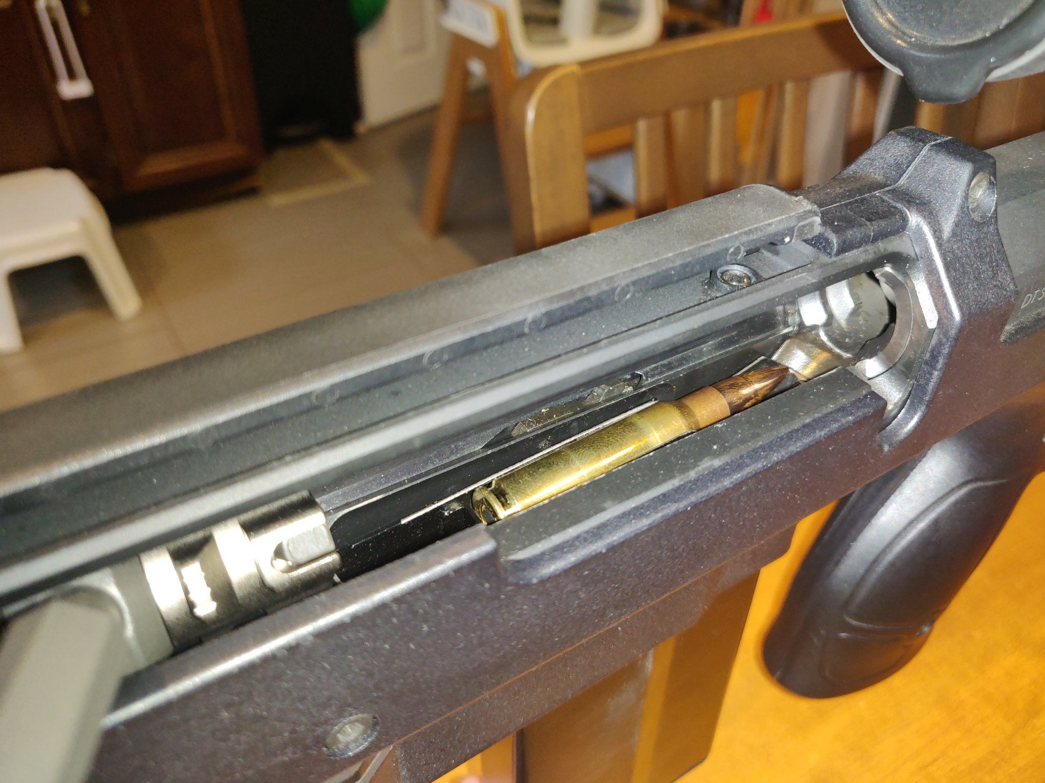

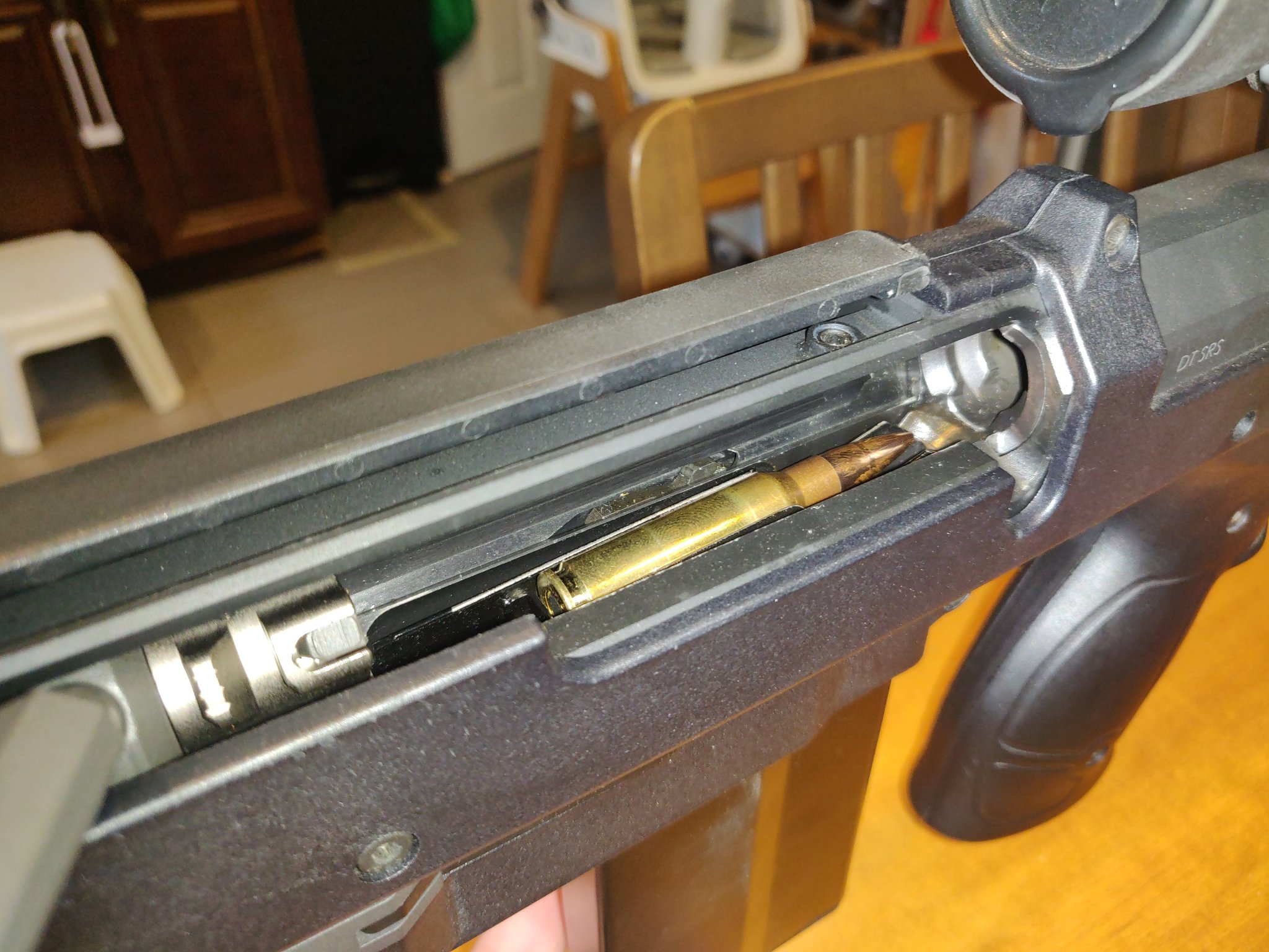

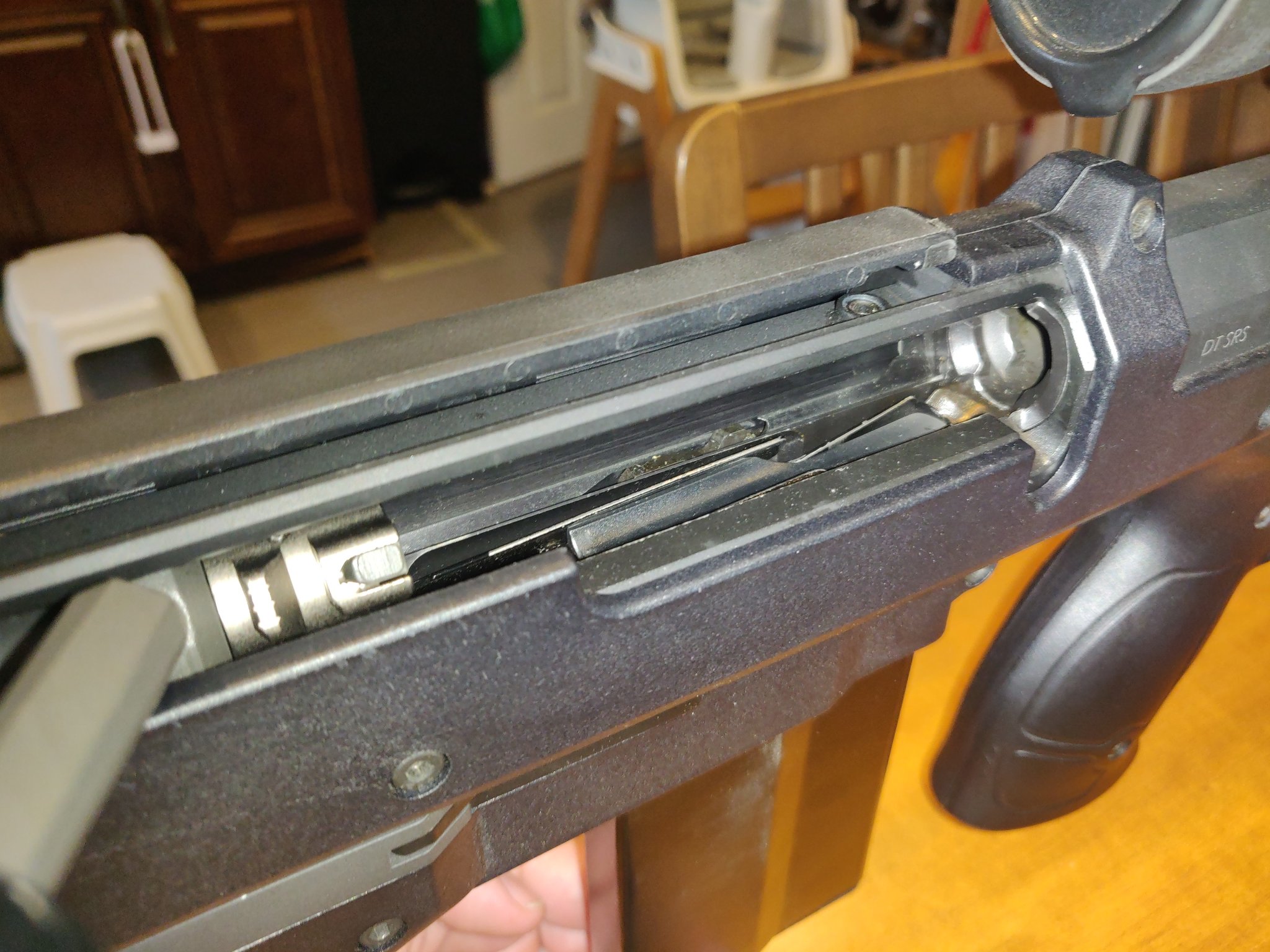

Are they hitting below the feed ramp? I think I had some doing it and just opened the lips up a little.

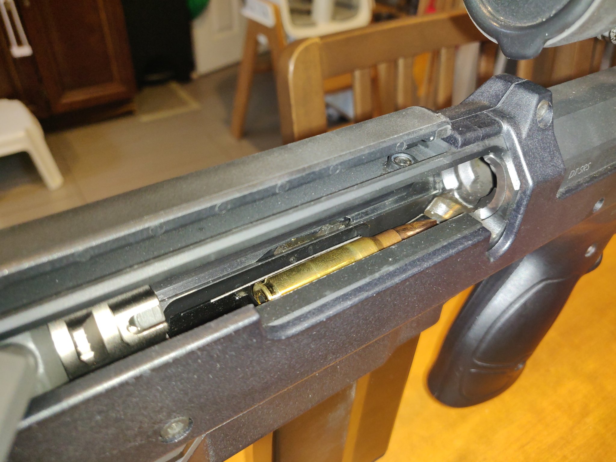

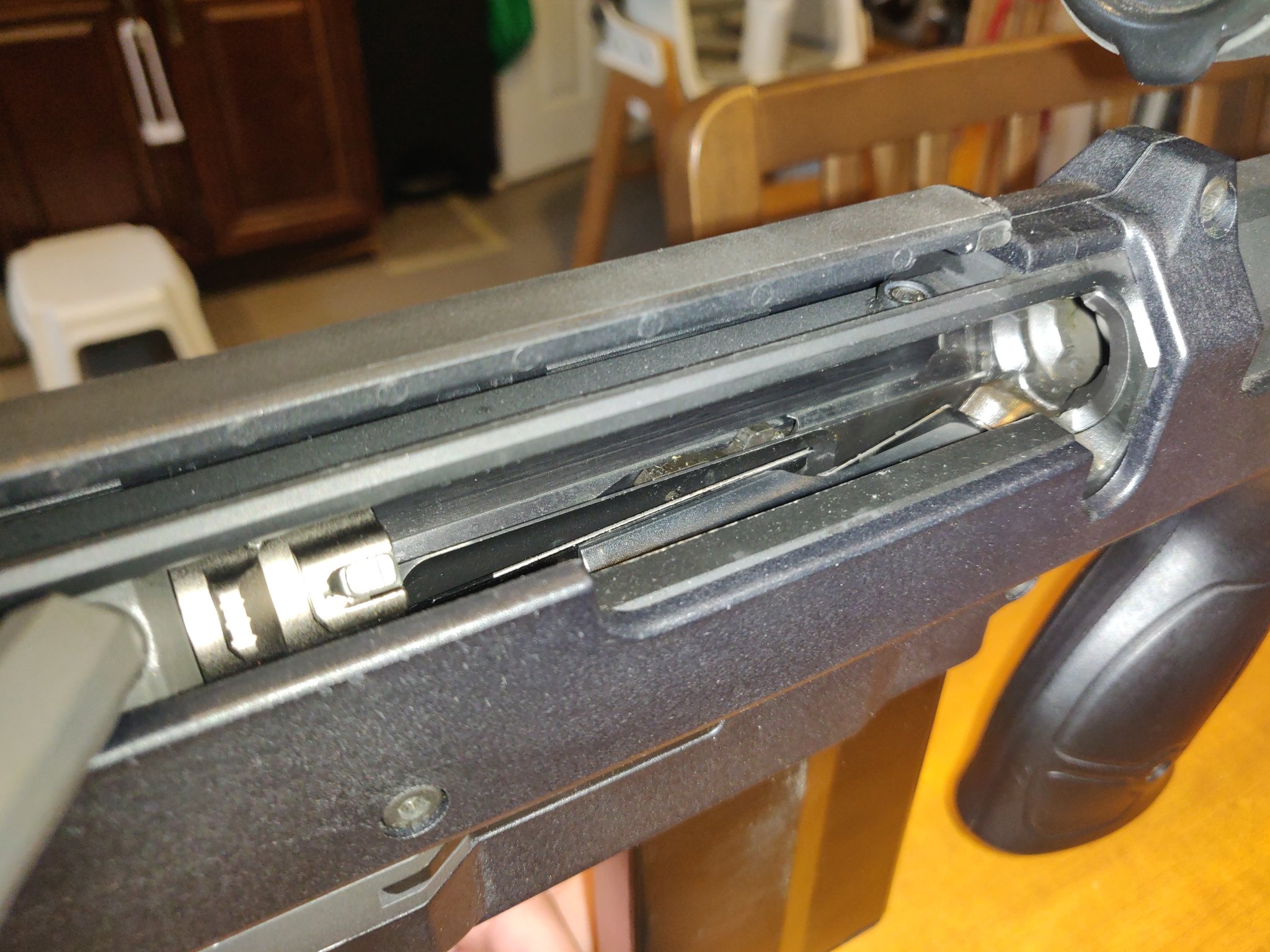

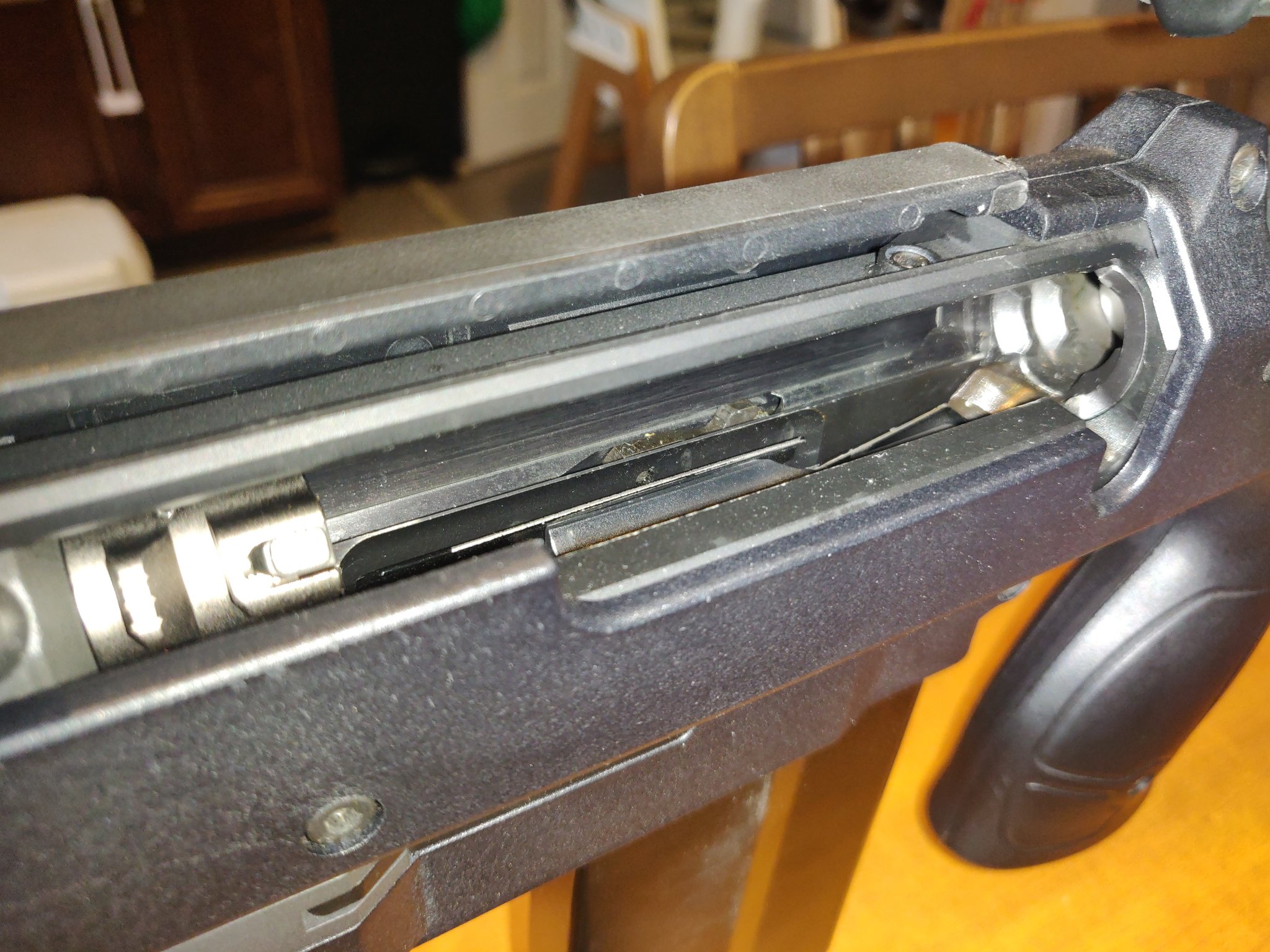

Tightened all of the screws and have the three pictures:
First picture how it is when inserted.
Second picture is how I have to adjust it to feed correctly.
Third picture is pushing the magazine all the way up.
Let me know your thoughts.
Really need a round or rounds in the mag to see what’s going on. The weight can affect how it sits also
First picture how it is normally.
Second how I need to modify it to feed.
Third: how far I can push it up.
Does it do this with all of your mags or just this one? Could be the mag is just too far on one side of a set of stacked tolerances. Or, the front end of the feed lips is maybe a bit snug. A little judicious bending will let the round pivot upwards at the bullet end. Be careful to not overdo it. I'd be more prone to replacing the mag. Mags seem to be a kind of a weak spot with the platform between not feeding smoothly and (especially) nosedive issues, etc...
Does this with all three of my short action 10 round magazines. I have a 5 round long action magazine and that works well
Have you tried disassembling the mags ever? I wonder if it's just the spring being in backward or being weak. The front of the mag should act as a sort of feed ramp. I get the occasional nose dive especially when loading the mag which I attribute to follower design and insufficient spring pressure on the front of the follower. Time to disassemble johnny-5.
