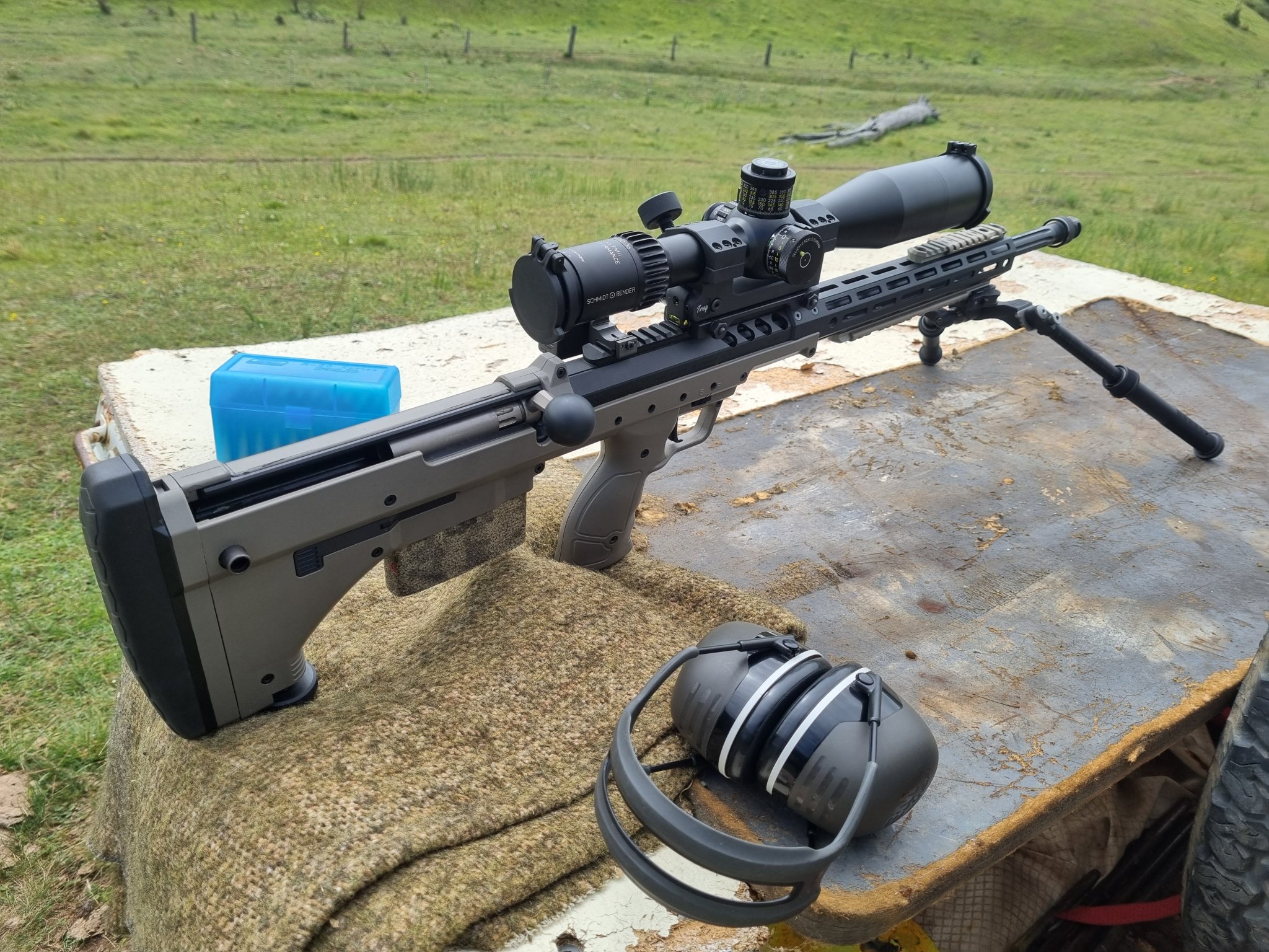

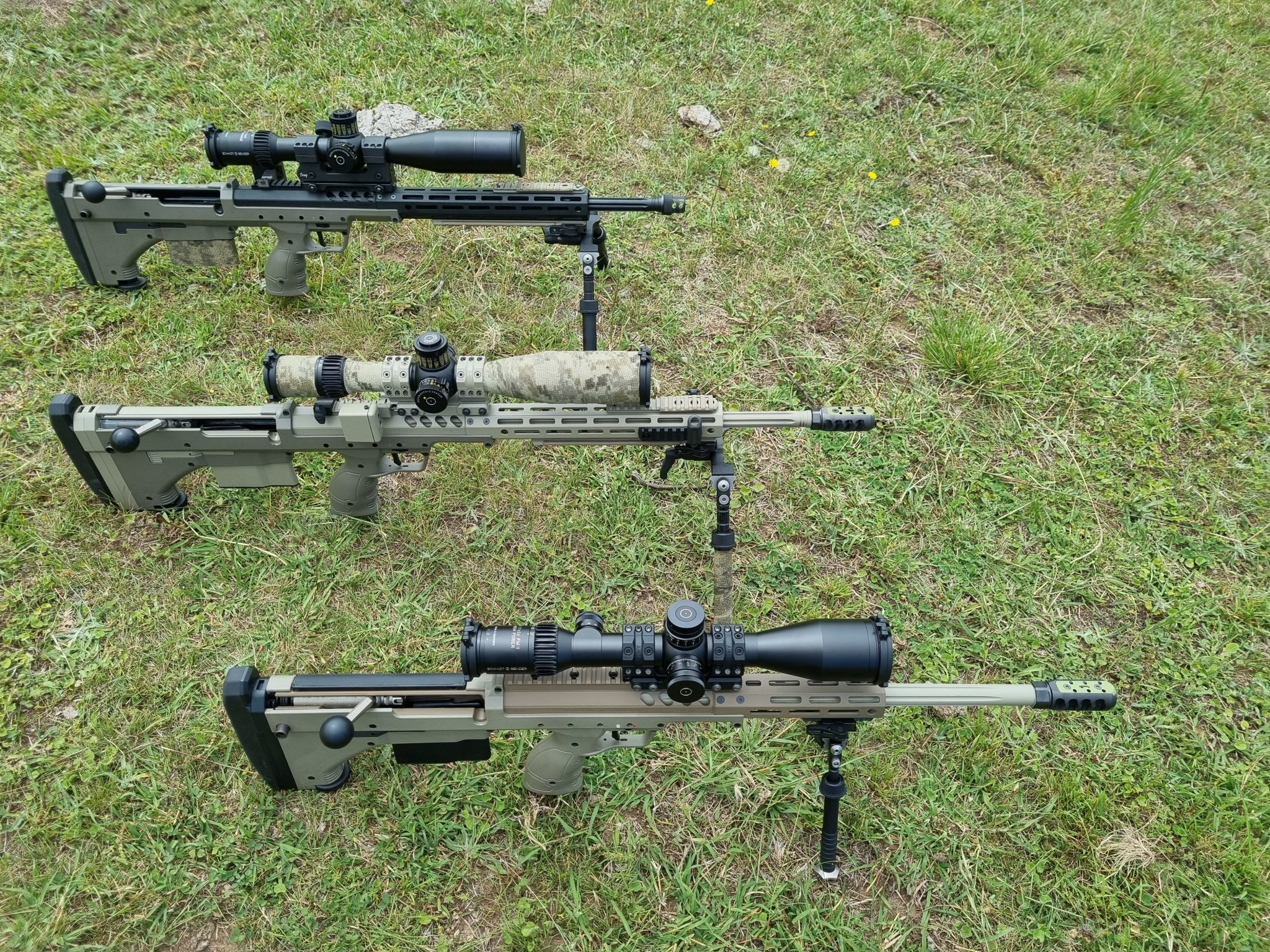

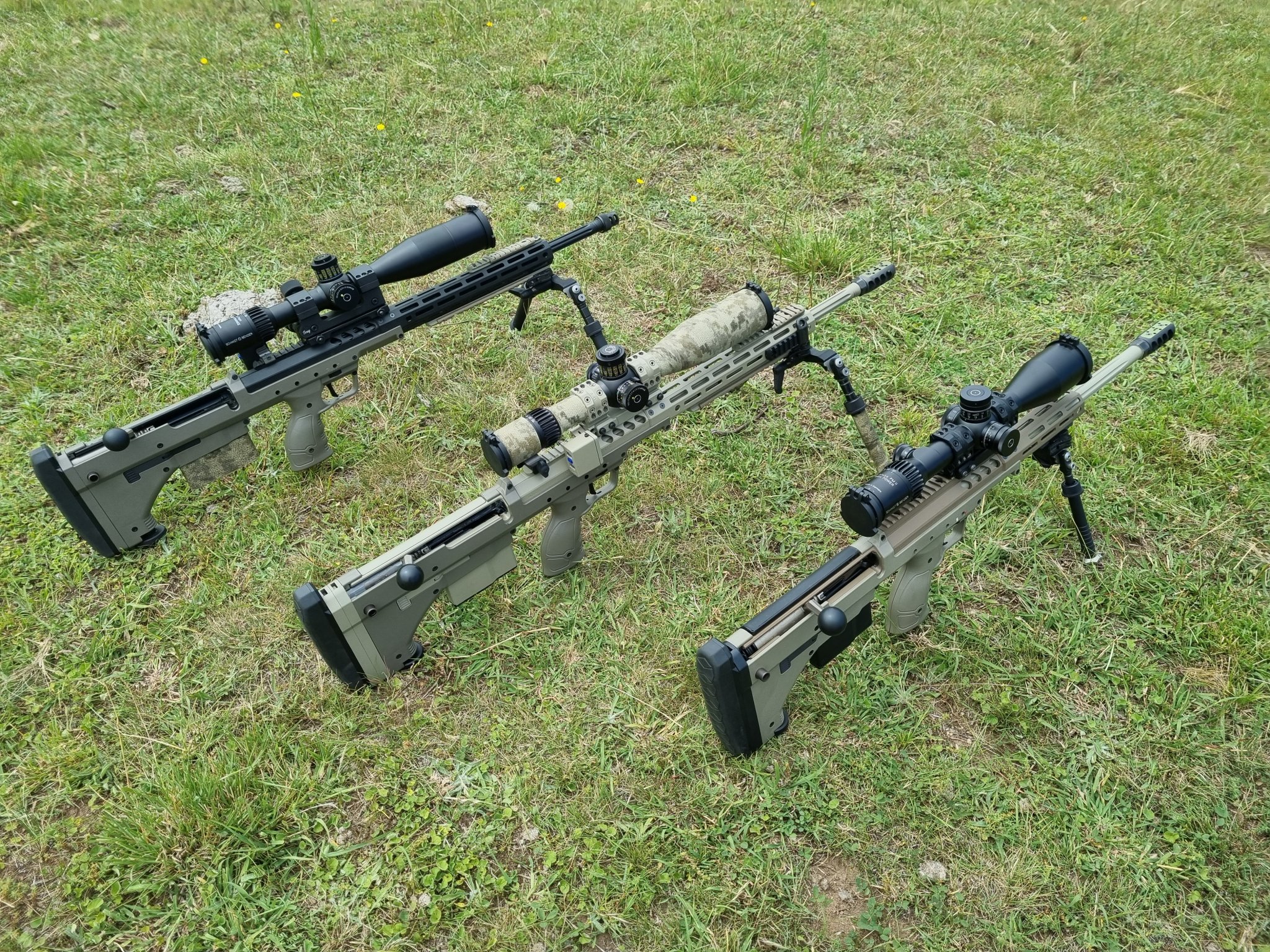

Do i detect a 6-36 in the wind?
Succumbing to " Peer " pressure.... :LOL:

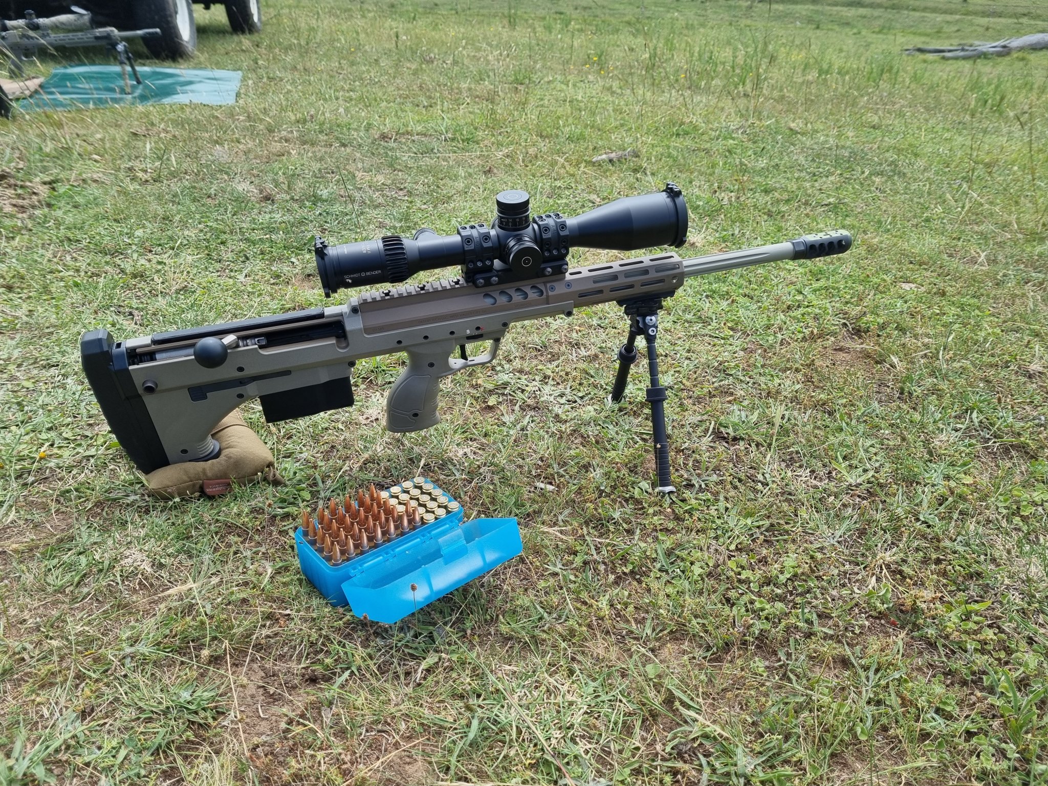

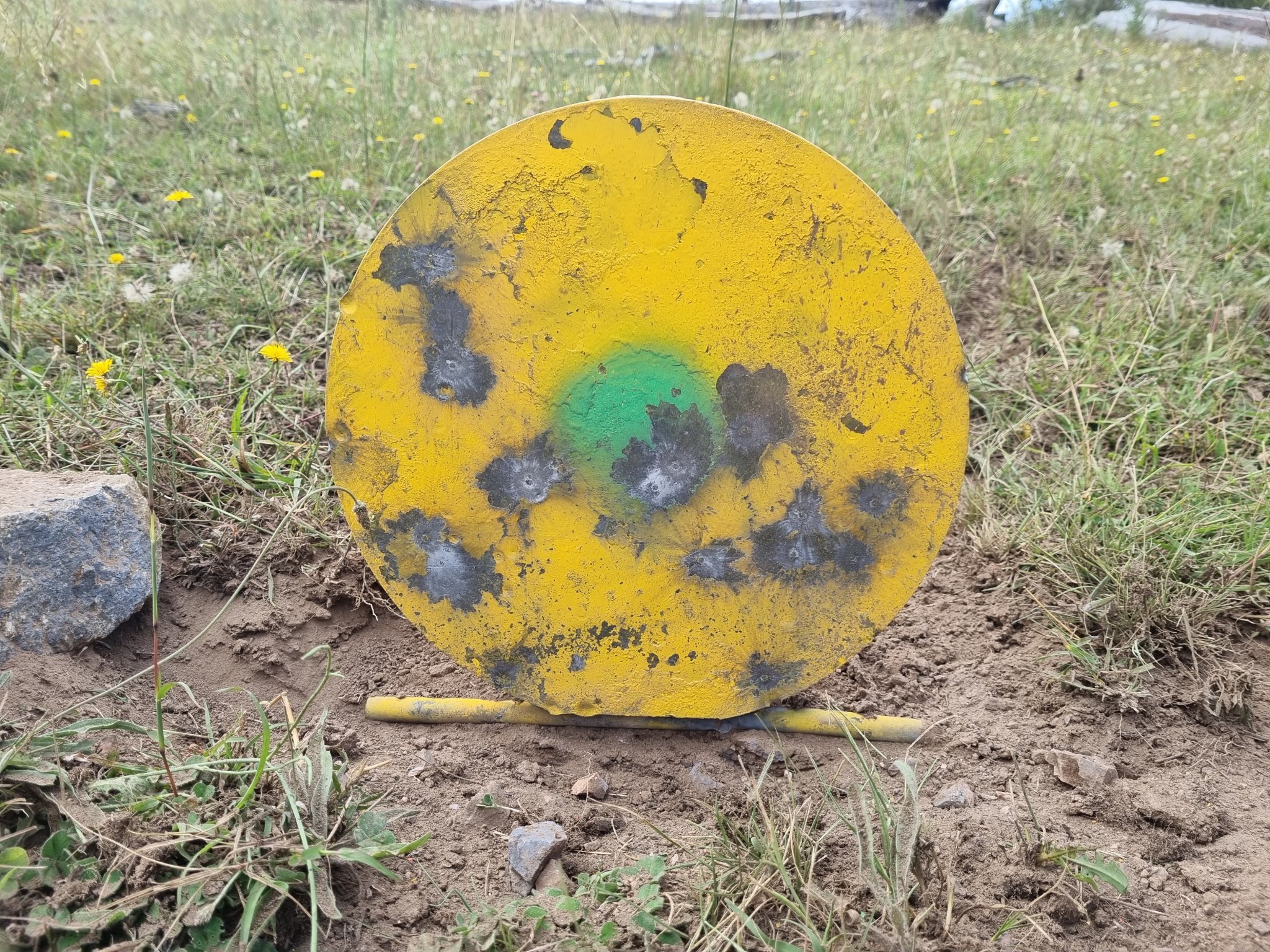

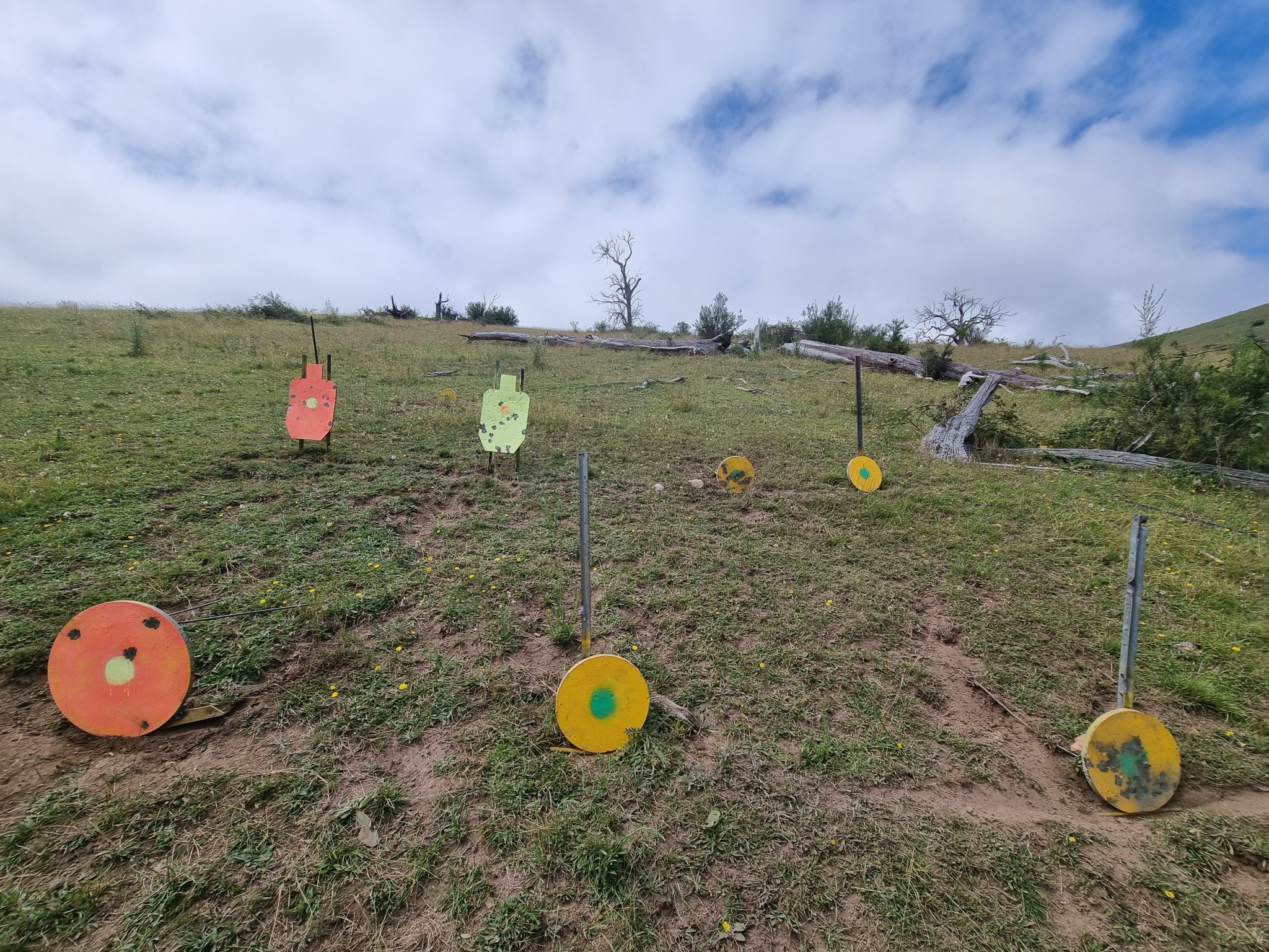

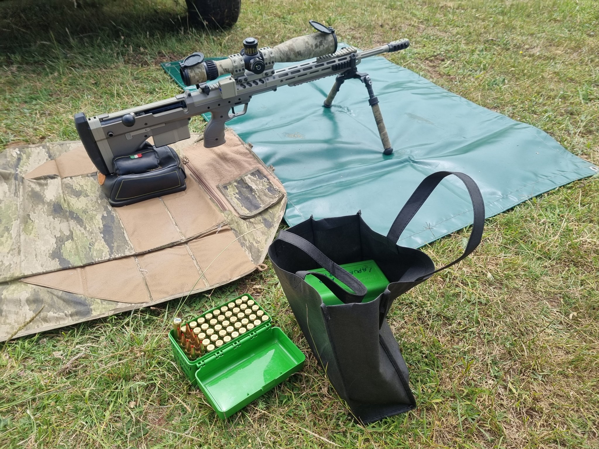

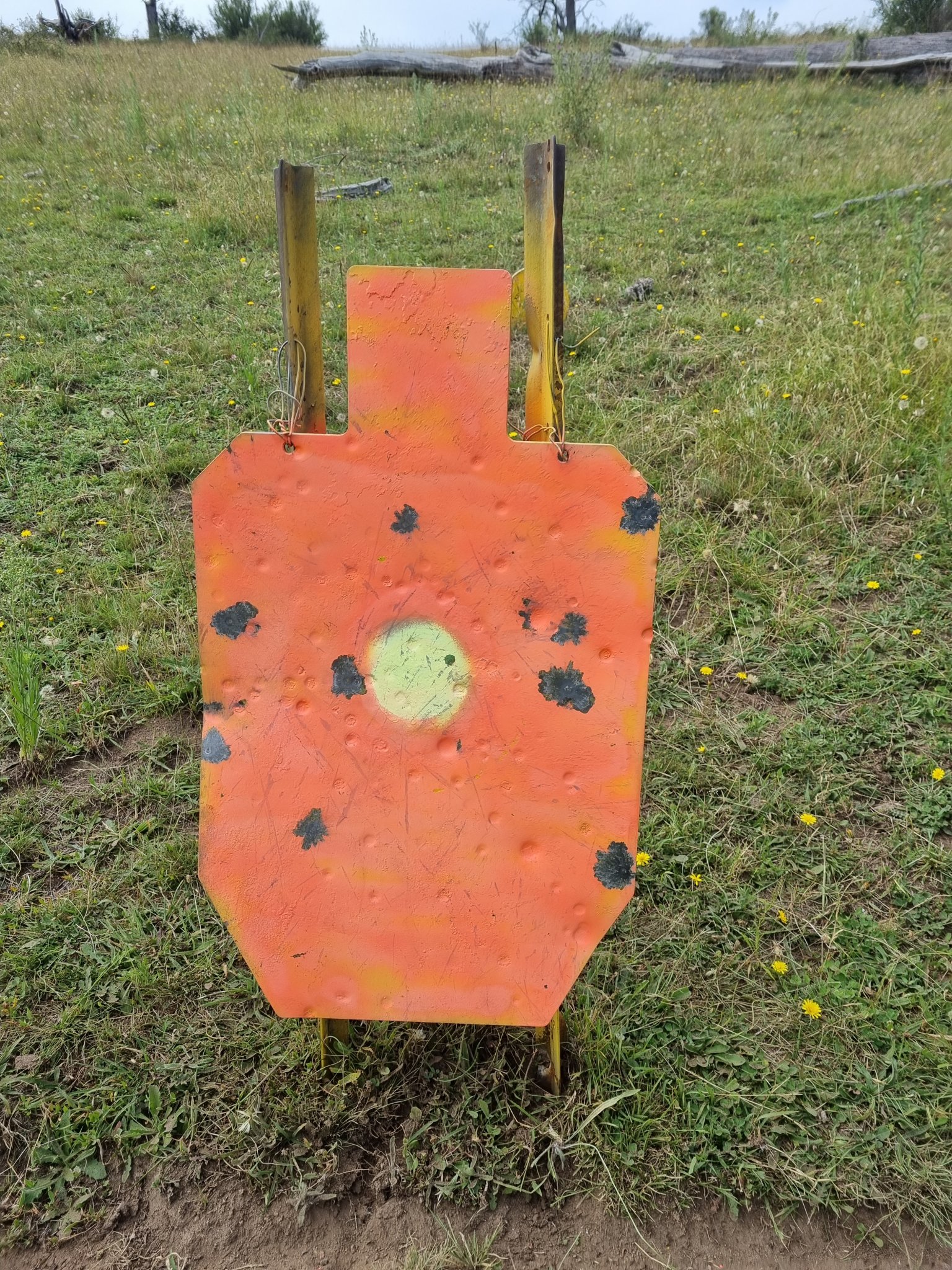

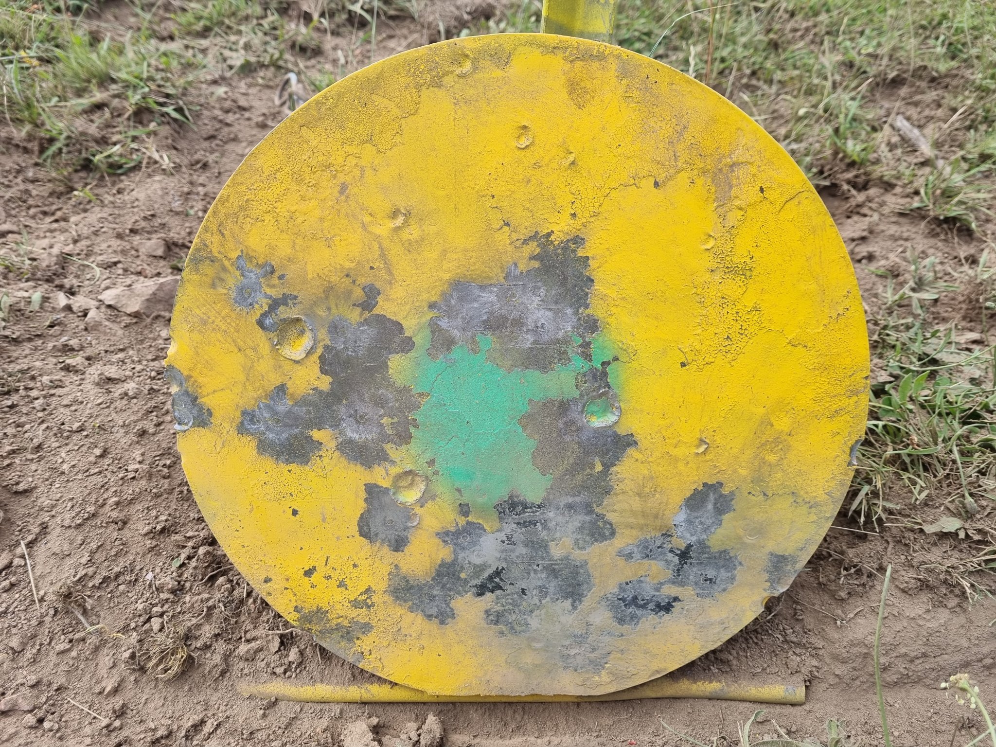

Great shoot today...
Myself and a couple of friends..
300Win mags and trusty 308..at 1200yds....varying wind left/right..( strong at times!!)

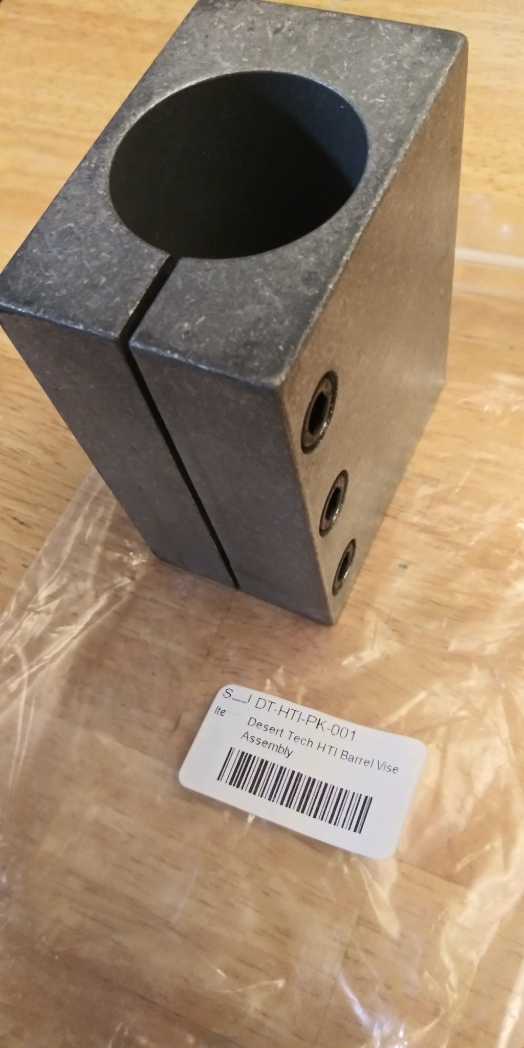

Thank you. I bought this to hold the barrel in the vise as well.

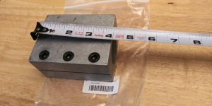

I upgraded to an Orange vise with the Area419 jaws, because I hate money. That comes with a series of barrel inserts and the 1.25” inserts fit the SRS barrels perfectly.
I looked at those a while back but I don't think I seen any big enough for the Hti barrels. They are a very nice set up and I'll probably add one in the next year or so. Probably need to get a job first though.
I love that setup but can't bring myself to spend that much. I had to laugh at your comment because I tell my brother all the time that he hates money.
