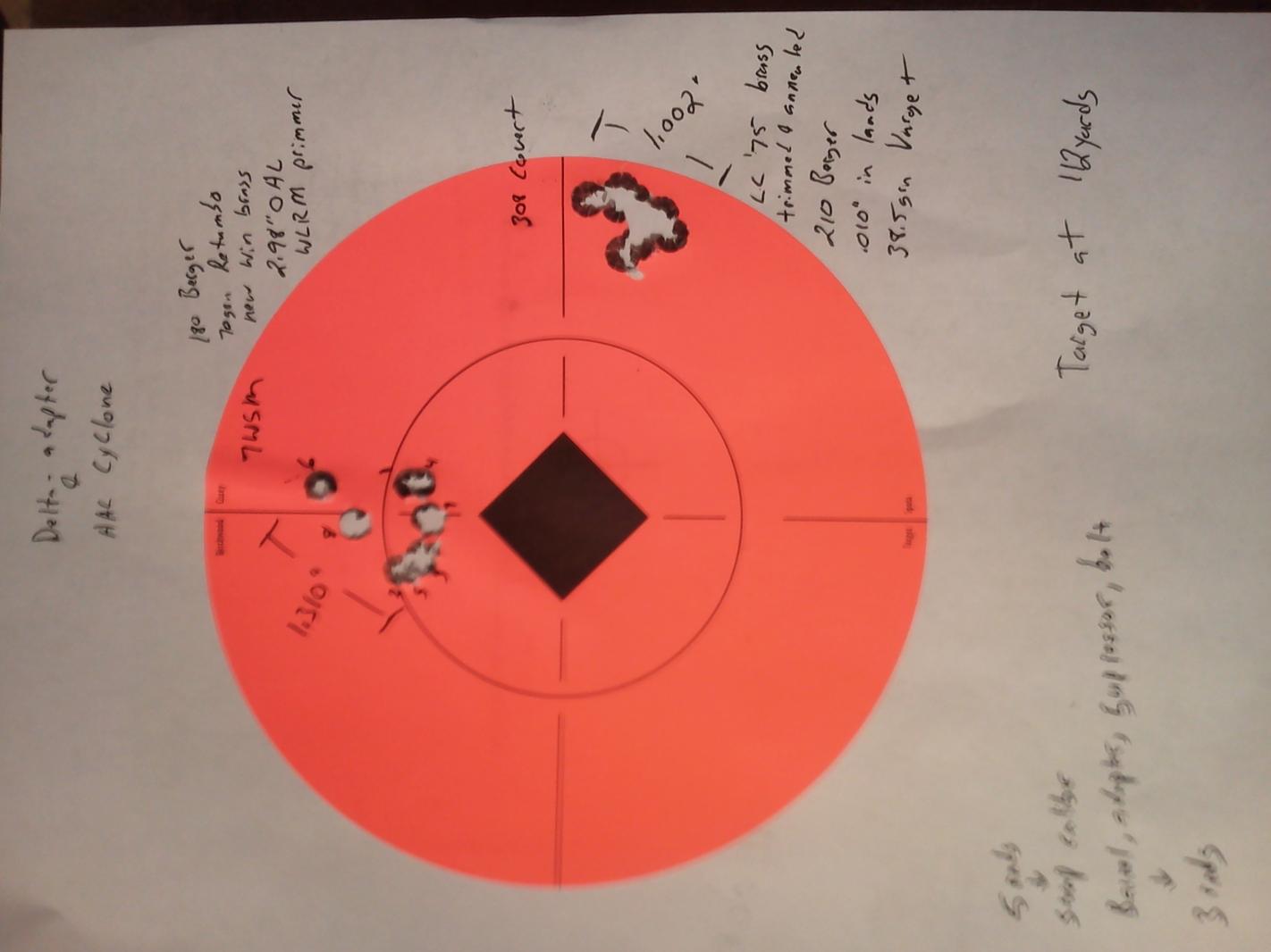

Did a little playing around to get my covert to shoot better after some adivse from Russ. FYI, they hate 155 lapua. I didn't have any 175SMK. I used some 210 berger VLD. Nothing special until I seated into the lands .010". That closed up the group. First 3 shoot group was about 1/4moa. 6 shoot was about 1/2moa. Problem is I can't mag feed them at that length. I will have to wait for some 175SMK to be available unless someone wants to sell me some?
After this was done I decided to do a zero test. 5 shoot group with my 7WSM barrel, 5 shoot with 308 covert, 3 with 7WSM, 3 with 308 covert. This was while also swapping bolt, delta 3/4-24 to 5/8-24 adapter, AAC cyclone suppressor. Worst groups I shoot all day with the 7WSm, but they were within each other, maybe moved a bit higher. The 308 covert. Not a very good group either for the day. Must have been time for me to quit. It was tight enough with 8 shoots I couldn't tell each hit apart at all. I cursed with 2 shoots knowing I pulled them. The target was at 112 yards. Here is a picture. I pulled the sticker off to bring in for a reference in the future. One more note. I did adjust the 7WSM 1.2mil up from the 308 covert.
At any rate, here is my fun for the day.
