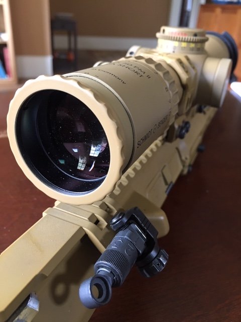

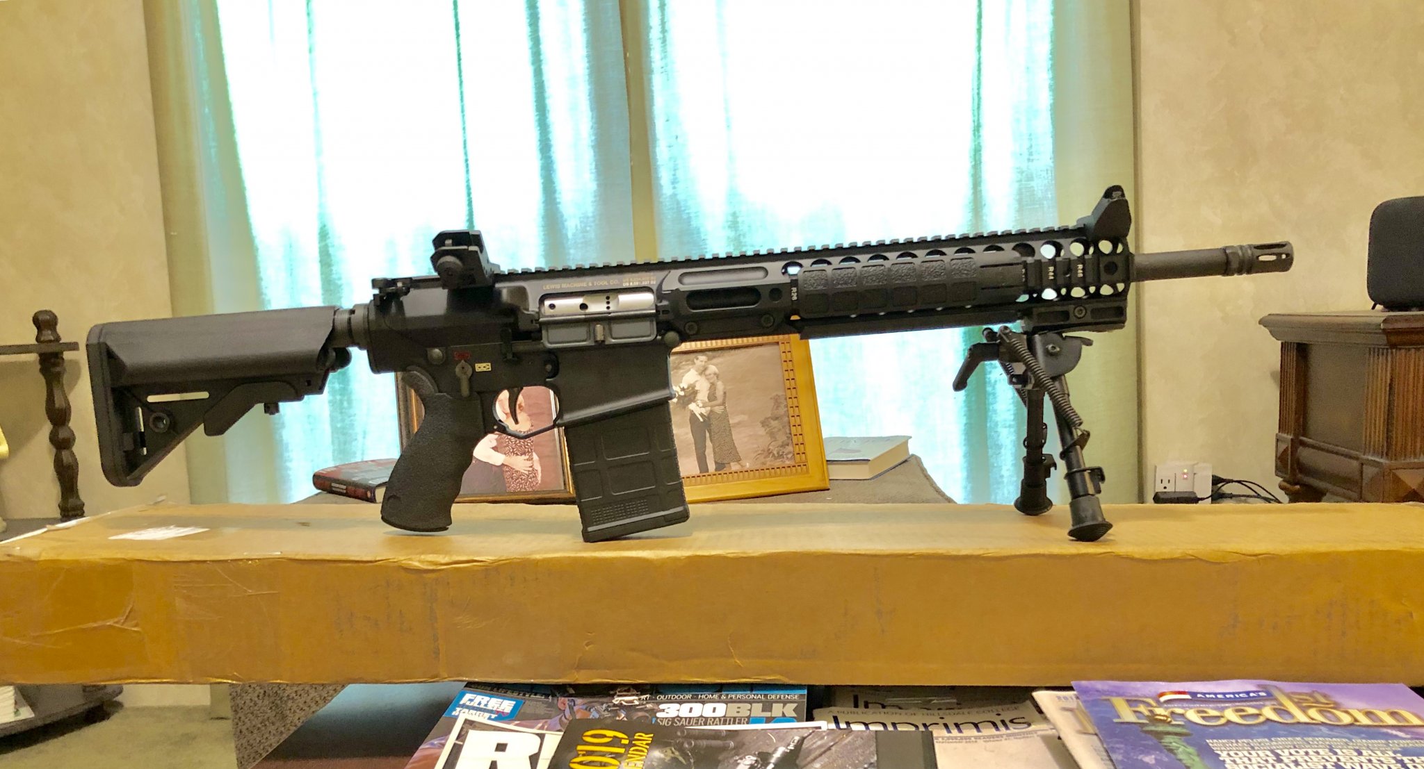

To the point, Right or Left side? Just starting out with a LMT MWS (picture below). Been reading, researching, and thinking through all of the details I can (still ongoing). Have not gotten my glass yet ($), so knew I wanted BUIS at the ready when desired. I’m right eye dominant. Went for DUECK DEFENSE RTS (Rapid Transition Sight
with Trijicon Night Sights - Set (Front & Rear) - Right-Handed, Mil-Spec Hard Anodized). After some thought and watching some videos wondering if left side might be better. Looking for other’s experiences with these choices.
Thanks for any.
Nice rifle. You have it correct. For a right hand shooter, the 45 degree offset goes on the right side. Rotating the rifle down under to the left would be pretty awkward. I went with an older set of KAC folding 45 degree BUIS on my LM308MWS.

I cant imagine that working well going on the left side. I would play around with it different setups to compensate for the left eye dominant thing..maybe a red dot piggybacked on a scope would be smoother backup for you.
from the pic, it's set up correctly. more ergonomic and logical given the way the wrist moves and being able to put the stock on top of the shoulder in close quarters(if that technique is what you like)
