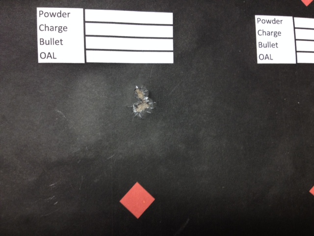

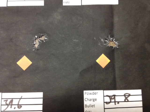

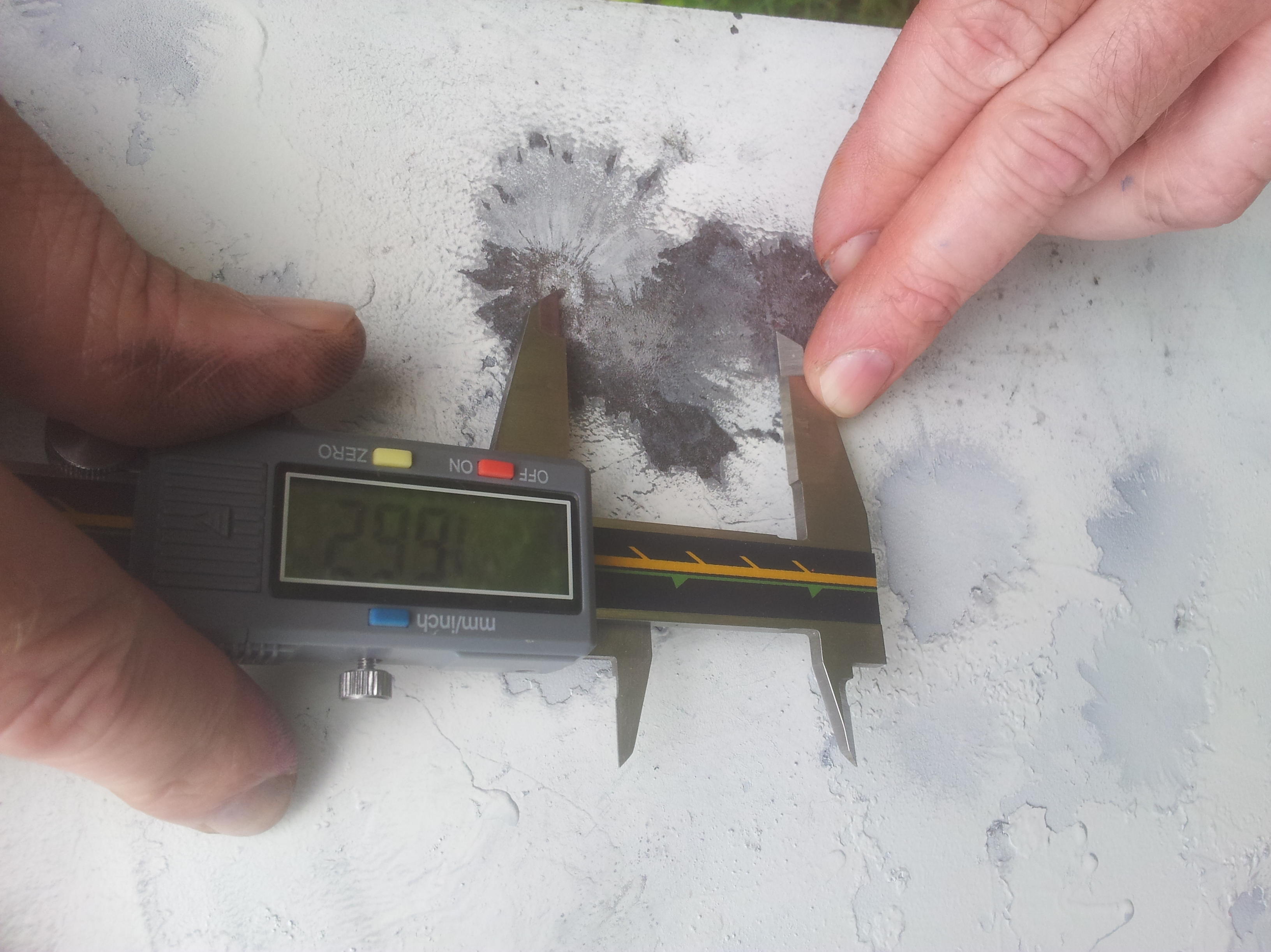

So gents here is the story of the 6xc woes. This rifle is a remington 700 remage build/manners t4 adjustable (glass/pillar bedded)/ timney trigger, criterion 26in varmint barrel. This rifle will shoot lights out on new factory norma brass as seen in the sample images (steel was 800yd 3 shot)loaded with either 105 hybrids or 107 sierras and 39.8gr of H4350 fed 210 primers. The problem occurs when i try to reload the brass being it will not group nearly as well(upwards of 1 MOA or more and really bad jumps at distance), and i have done this with about 5 batches of 100 brass now. My brass prep goes as follows:
Vibratory clean
Deprime/size .002 bump forster dies (not sized if i plan to anneal yet) (anneal if needed, i have tried annealing after first firing to no different affect)(bench source)
Ultrasonic clean (usually wait outside in sun for couple hours to dry or overnight inside)
Trim RCBS trimmer (within .001")
Chamfer inside and out using VLD inside chamfer and rcbs outside debur. (these are motorized)
Flash hole chamfer
Primer pocket depth uniformer
Hand prime with RCBS tool ( i actually notice the new 6xc norma brass is the tightest pocket of any brass i have ever reloaded for in my life)
Load using rcbs chargemaster and rcbs press.
My new brass out of box prep goes:
Size all (basically to just round out the mouths)
ultrasonic
quick debur inside and out
primer pocket
prime
load
I cant believe i am hurting these somehow on the second load that i dont on the first but i am open to any ideas right now. I do reload for other calibers and rifles (dpms lr-260/fna3g/various hunting rifles ) and i dont see these issues. One thing i do notice is the bullets seat as smooth as butter on new brass but on my first reload they do take more force to seat. It seems smooth, not like new brass but smooth enough however its just a little harder. Runout is good all under .003 most under .002". seating depth is uniform. The expander ball on my forster die is .2405" and leaves the inside case neck .240". I didnt measure any new norma neck size. Thoughts?

You surely put the work into your brass. I appreciate the advice. The only thing on my end that doesnt make sense to me is the fact they shoot great to start and then the reload gets worse. If brass was an issue i would think i would have an issue to start.
Fireformed and Virgin cases like a different powder charge. Work up separate loads for each type of case.
This guy is right, once you fireform your brass, most likely case capacity changed, so pressures changed, now you just somehow have to get to where you were to started=new brass.
Some rifles make the transition painlessly, others need tweaking.
It takes energy to expand the case and seal the chamber. A fireformed case does not need to expand. So the energy normally consumed to expand the case is diverted to pushing on the bullet, thereby changing the internal ballistics. If your load is fragile, that difference could throw you out of the node.
In my experience, new/fireformed case capacity doesn't matter all that much in actual practice. 58kpsi has a funny way of expanding brass with little effort. I've used the same loads in new and 12+ times fired brass and get the same POI, same accuracy, same velocity.
To the OP, one thing to remember is that ultrasonic and stainless media tumbling clean the case necks to levels vibratory cannot, so special precaution has to be taken after cleaning with these processes. The absolute bare metal in the brass has an annoying tenancy to gall against the copper in the bullet. This will leave long scores down the length of the bullet's bearing surface. To mitigate this, you need some kind of dry lube (graphite, mica, etc.) in the case neck prior to seating. Of course, then I would assume your first loads would be bad, as well, but it's something to consider for future reloads.
The other thing to check is neck tension. Preferably, you want .0010-.0015" neck tension for bare bullets, maybe a bit more for coated bullets. If you can, ditch the size/expand die and get a good bushing die.
In my experience, you often need to add powder to the load when using a virgin case to reach the same velocity as in a fireformed case, in factory rifles anyway. This is in low SD loads, where you can actually see a change in velocity.
STI, what Temp9 said about case necks and cleaning is true, Try skipping the ultra - sonic cleaning, don't even brush the necks untill they have been fired twice. Also fireformed brass "can" require a different powder charge.
My guess is that your chamber is a little on the generous side--which dimension I cannot say.
You have found a recipe for the interior volume of the virgin cases, but this charge weight lands on an anti-node after being fire formed.
Thus, you should take the fire formed cases and develop a load specifically for them.
Don't be surprised if it takes 0.3 gr to 0.6 gr more powder to find the accuracy node again.

I think maybe your die is causing too much neck tension. What is your sized empty neck vs loaded neck diameter?
.267" & .270" respectively. Still the virgin brass go through this sizing die and yet seating is nothing like the once reloaded brass. What could be the difference then?

Quick update. 39.8 is where the charge needs to stay, however the neck being lubed lightly with one shot and q-tip, as this is all i have on hand, helped reduce group size and keep it there. I have about 20-30 rounds left so after that the next reloading should be better with the lessons learned.
