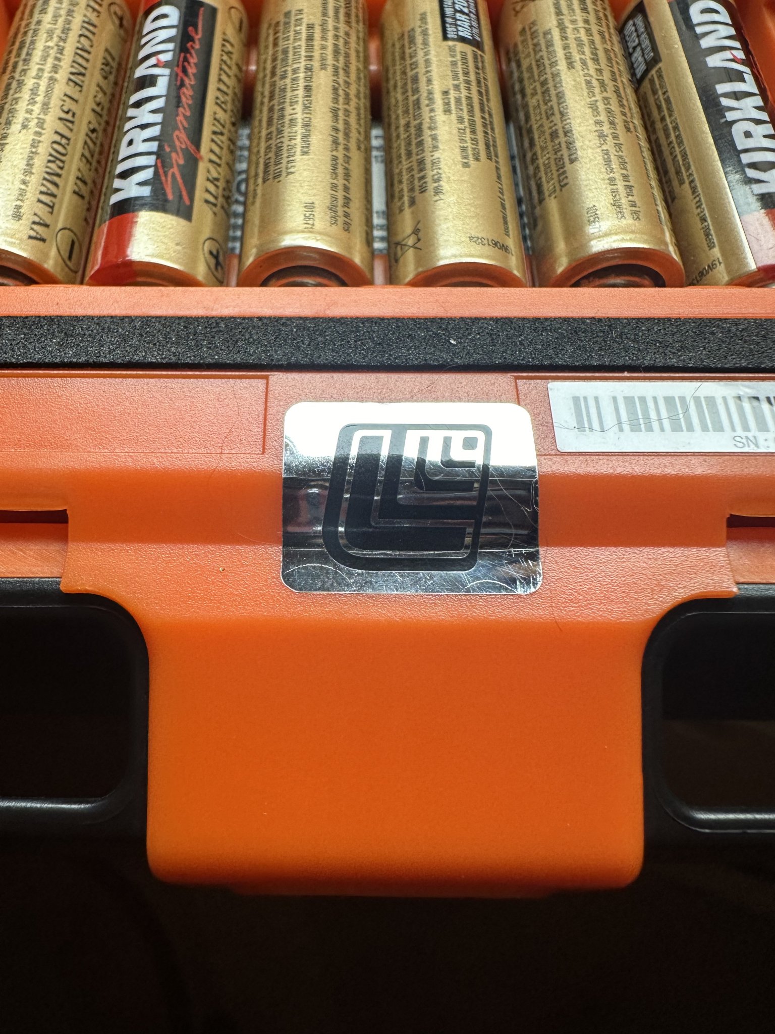

Has anyone opened a lab radar? After removing the 8 Allen head boots the area around the tripod mount is not wanting separate. Is there another bolt or a screw somewhere or maybe a clip? Just don’t want to brake anything.

Somewhere on SH, there is discussion where someone opened theirs up - IF - I recall correctly - there was one hidden screw that prevented it from just opening up after the removal of the other 8. I think it was under a piece of tape or similar. Might look around and see if you see anything like that. Good luck.

it's been a while, but 8 screws seems right, one under the tamper/warranty seal on the bottom. I does need a little work to wiggle apart. I installed a DC plug on mine to replace the silly mini-USB.

I've opened mine up. There is a screw underneath the warranty/void sticker at the bottom center (if I recall correctly.)
It then seperates easily. Be careful, there are wires that connect things on the back assembly to the PCBA that is screwed to the front assembly.
