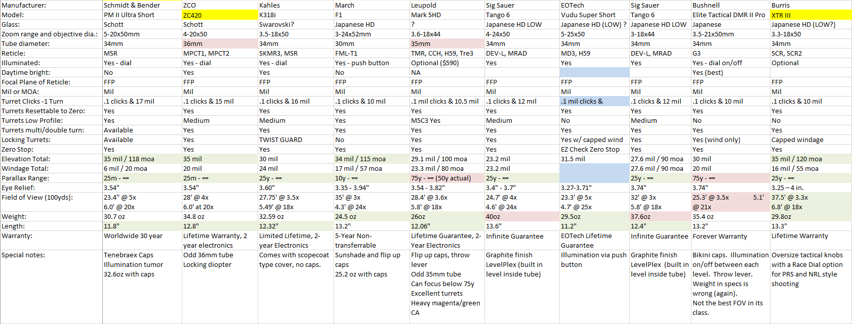

OP, since the majority of your rigs are large frame AR's I think you should consider a scope for those separate from the scope for the bolt actions. I am not sure what your budget is but the Schmidt & Bender 3-27x56 is pretty amazing and comes with a 34 mil option for your ELR setups. The Vortex Gen II 4.5-27x56 is a tried and true scope that won't break the bank and the new ZCO ZC527 5-27x56 promises to be pretty amazing and offers 35 mil elevation (but the ZCO suffers from an odd tube diameter at 36mm which is also shared by some Zeiss and Hensoldt scopes). Here's a spec list so you can see some of these side by side:
For your gas guns I'd suggest something shorter, along the lines of the Schmidt & Bender Ultra Shorts, you also list the Leupold Mark 5HD 3.6-18x44, the Eotech Vudu 5-25x50 super short, the Bushnell ET DMR II Pro 3.5-21x50. Consider the ZCO ZC420 4-20x50, the Kahles K318i, the Sig Sauer Tango6 4-24x50 and the Burris XTR III 3.3-18x50 which appears to have the greatest FOV of the bunch. Here's a spec list:

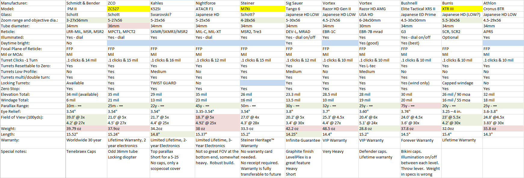

Also a Steiner M7XI 4-28x56 could be a nice option. Good FOV at 4 power and should be interesting at 28.
The specs are in the first table Wjm308 has posted, though it differs a bit from the specs you want
(50m parallax not 25m, a more traditional 26Mil elevation and 6Mil windaged is less than a lot of other scopes if thats ever worried anyone?)
