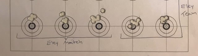

I find my shorter barrels tend to have a finer node and can be more picky in regards to what Rimfire ammo they like. My 26” RimX and my 28” Remington 40x seem to shoot most decent ammo ($5-$8 sK stuff) good and really shine with the ($10-$17 high end ammo). Once you find what they want you to feed them they all shoot tiny bugholes. Aside from the long vs short barrel, just purchase whatever fits your needs. I like mine to match my centerfire rifles in weight and length for training purposes. If I just wanna go out and mess around offhand or to teach someone I bring out the shorter barreled rifle.
Here’s some preliminary groups out of my 26” RimX Chambered with win 52D Reamer with mid grade ammo shot with rear bag and bipod and a slight breeze. Still waiting on some midas and RWS ammo. Groups are 5 shots per group at 55 yards.
Here’s some preliminary groups out of my 26” RimX with mid grade ammo. Still waiting on some midas and RWS ammo. Groups are 5 shots per group at 55 yards.
This is what I have found as well. Lower SD's, broader range of ammo shoots good or great. Only downside to 26-28" barrels is the handling, if you don't like longer barrels. I like them so no issue.

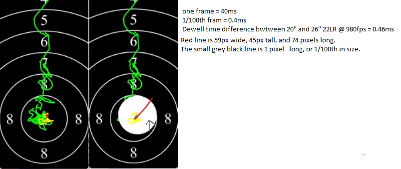

The below video is a SCATT trace that precisely shows the aiming point before during and after a shot. Note the different colors represent: before the shot= Green trace, 1 second prior to = Yellow and after the shot =Red.). While this is a world class shooter shooting an air rifle off hand, the jump you see after the shot is typical and even more pronounced with a .22 in the prone position. Note how much the muzzle moves after the shot (red) and this is with a recoil less air rifle. With really good shooters the direction and distance of the point of aim is repeatable. With lesser shooters like me, not so much. The velocity of 10 meter air rifles is about 550 fps and while the barrel looks to be long, it's actually counter bored (in my Fienwerkbau air rife about 10") to reduce the time the pellet can be affected by the barrel from this after shot movement. My small Bore 3P rifle has a nearly 28" barrel and a 9" bloop tube. The challenge with all of these rifles in not holding the X ring, it's managing the recoil after-shot movement to be consistent and to fall back into place confirming the natural point of aim is good. We also haven't talked about moment of inertia which is a big advantage to longer heavy weight barrels. Things really get ugly if the shooter flinches!

Just calculated the "Dwell Time" difference between a 20" and 26" barrel. At 1080fps the additional time the bullet spends in the barrel is .46ms (milliseconds) That's .00046 seconds! In my job I do a lot of latency testing on electronics that we develop and design. From a human user POV, .46ms is insignificant in this application.

In one of the above videos, it gives us a time stamp of 2 seconds in yellow, for the line trace.
1 frame (of video) is 40ms long. So 1/10th of a frame is 4ms, and 1/100th of a frame is 0.4ms.
If someone had some half decent video editing skills, they could dissect one frame from the video, work out what 1/100th of the movement is. The target and resulting impact have a known diameter, it's also a known distance.
Anyone up for a challenge on a rainy Sunday Arvo ?
