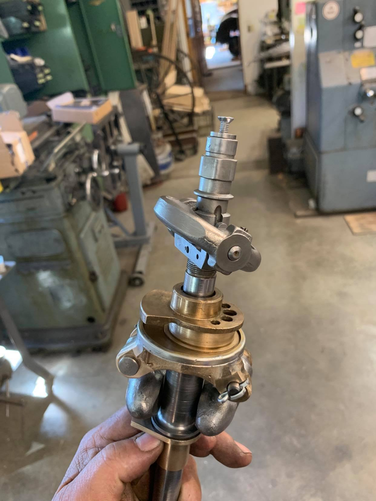

Here's a little non-CNC project I did yesterday. The piece next to my thumb... the shaft... and the hex cam... scratch made. in a day. To restore a centrifugal advance unit in a 1922 car. Adapted some parts from a 1920's Essex to another distributor. The parts that weren't essex (the flyweights, the pump cam,0 were original. All made in a day. You don't have to be a CNC machinist to do what guys in the 1920's did... daily.
