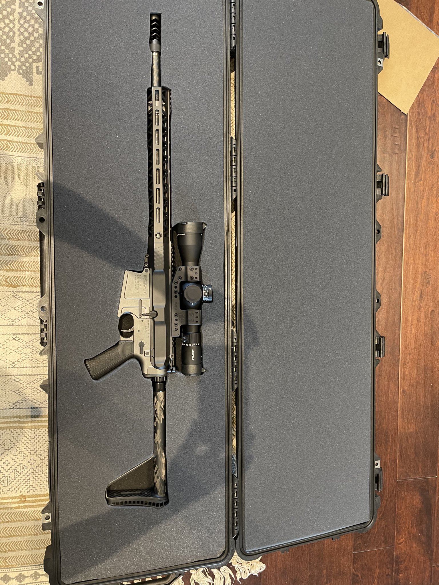

I used roam receivers and handguard, proof barrel, and JP BCG. Definitely wasn’t a thermofit but it seems to shoot better than me.
