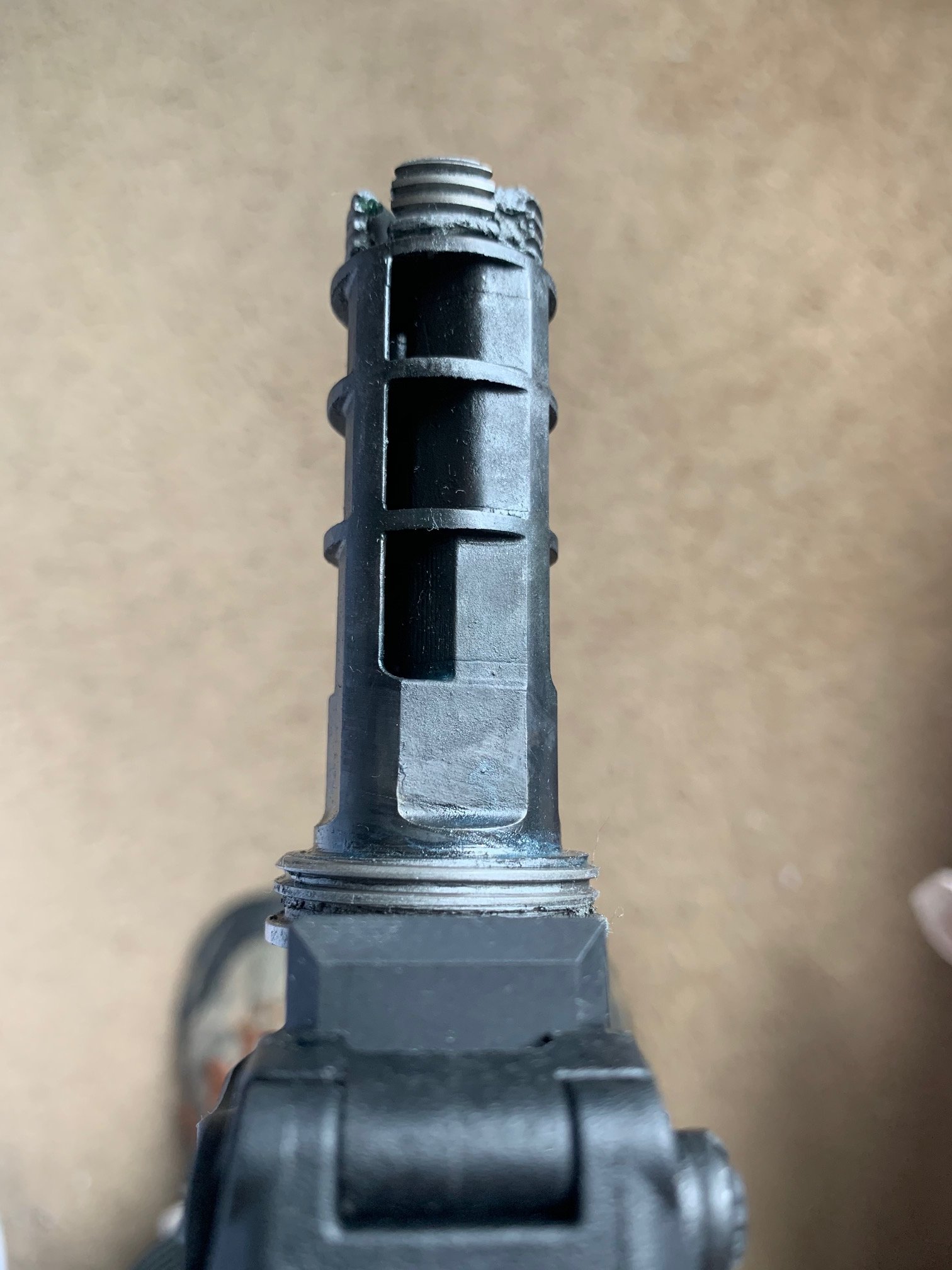

    My suppressor finally came out of time out today! I've converted the other rifles over to the OSS muzzle brake and am converting the POF as we speak.
    Is there any reason I can't use the POF lock/timing nut in place of the archaic washer system? Drives me mad trying to time the muzzle brake so the flat side is at 12 o'clock. Did that on my 5.56 and 300 Blackout and it took forever to find the right combo.
    I have it on and basically screwed it on the end of the barrel, as low as it would go, then timed it by backing it off and made it snug with the locking nut.
    I can't think of a good reason but maybe the more experienced would know. The POF lock nut, backed all the way down, actually slides over the barrel so there's a ton of thread for the OSS muzzle brake to screw on. In fact, I only turn it about 1/8 of a turn from locked all the way down to square up the flat face and lock it down with the locking/timing nut.
    What do you think and thanks in advance!
    Never use a locking nut with a suppressor, you are asking for a baffle strike.
    For the suppressor to be concentric to the barrel, the back of the muzzle break needs to be parallel to the shoulder behind the thread. Great care should be taken when installing a break for suppressor use, use the shims and Rocksett and carefully inspect the finished product with suppressor installed for alignment.

    Without any washers or lock nut in place, how far out of time is it?
    Not too far to be honest, bout 1/8th of a rotation. I'll screw it on without the lock nut or washers and take a pic. It was pretty much like that on the other two barrels (both Faxon match-grade barrels.
    I used the supplied washers on all my other uppers as they didn't come with a lock nut anyway. I was aware of the need to be perfectly perpendicular with the bore but figured the threads would determine that more than anything. I'll start from scratch and see if I can even rock the mount back and forth once mostly threaded on but not snug. I thought (hoped) the threads were precise enough to do it this way (along with the lock nut).
    Appreciate the answers guys! Saved me from a potentially very bad day with my first ever suppressor.

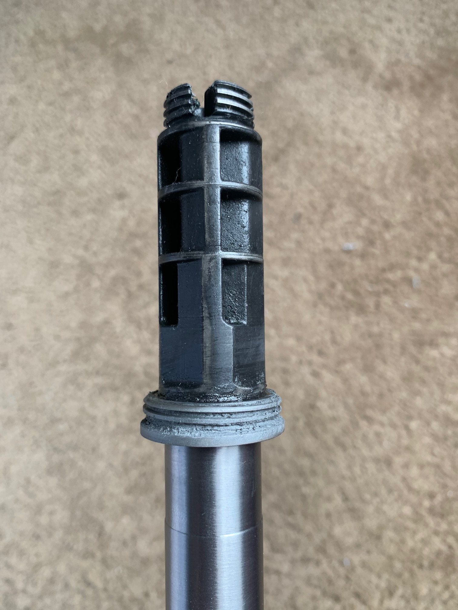

    One thing that I learned when I took the OSS brake off of my .22-250 to get rebarreld was what a PITA it can be!
    I tried just about everything to get that brake off and nothing worked. Since I didn't care about the barrel because it was going to get changed any way, I put it between the teeth on the bench vise.
    Those are the teeth below the jaws that are used to grab pipes with. That kept the barrel from slipping and I was able to put a big crescent wrench on the brake and voilà, problem solved. The outside of the barrel was buggered up but it was getting replaced anyway.
    I tell you all of this because red LocTite or Roc-set isn't necessary to keep the brake on. None of mine have come off of any of the AR-15s.
    So my suggestion is to snug up the brake without going full "Mongo" on it and try it.

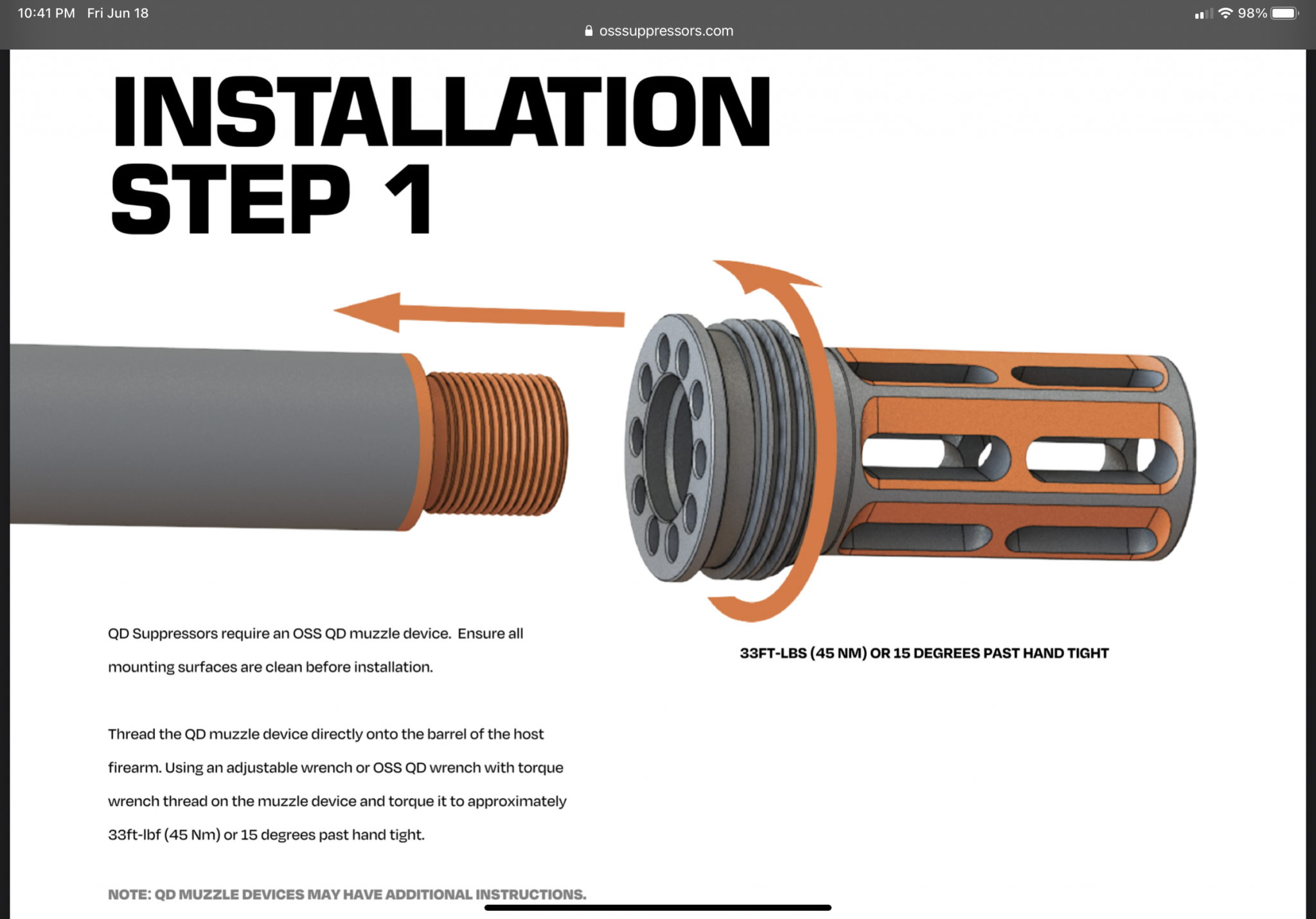

    I have a torque wrench and they want the mount to be tightened to 33ft. lbs which is pretty snug. But duly noted! Another reason why using a lock nut would be a good idea...I guess the entire "system" would have to be machined to tighter tolerances to do it that way though. I may buy some alignment rods if they're not too expensive just to check everything.
    If I remember correctly, the force of the gasses exiting the OSS are counter to the direction needed to remove the suppressor and muzzle brake so it cannot come loose while shooting.

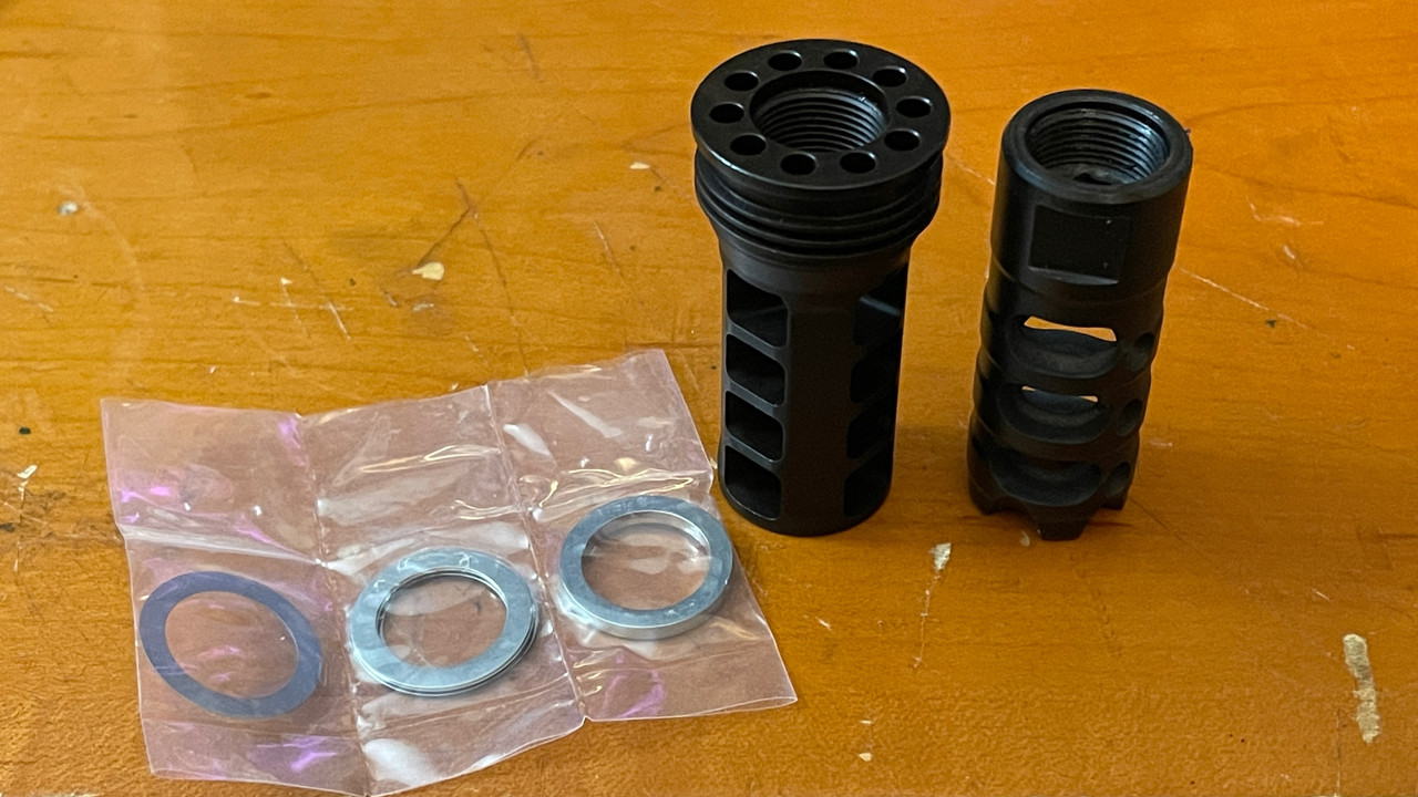

    You may know this, but just to put general knowledge out there:

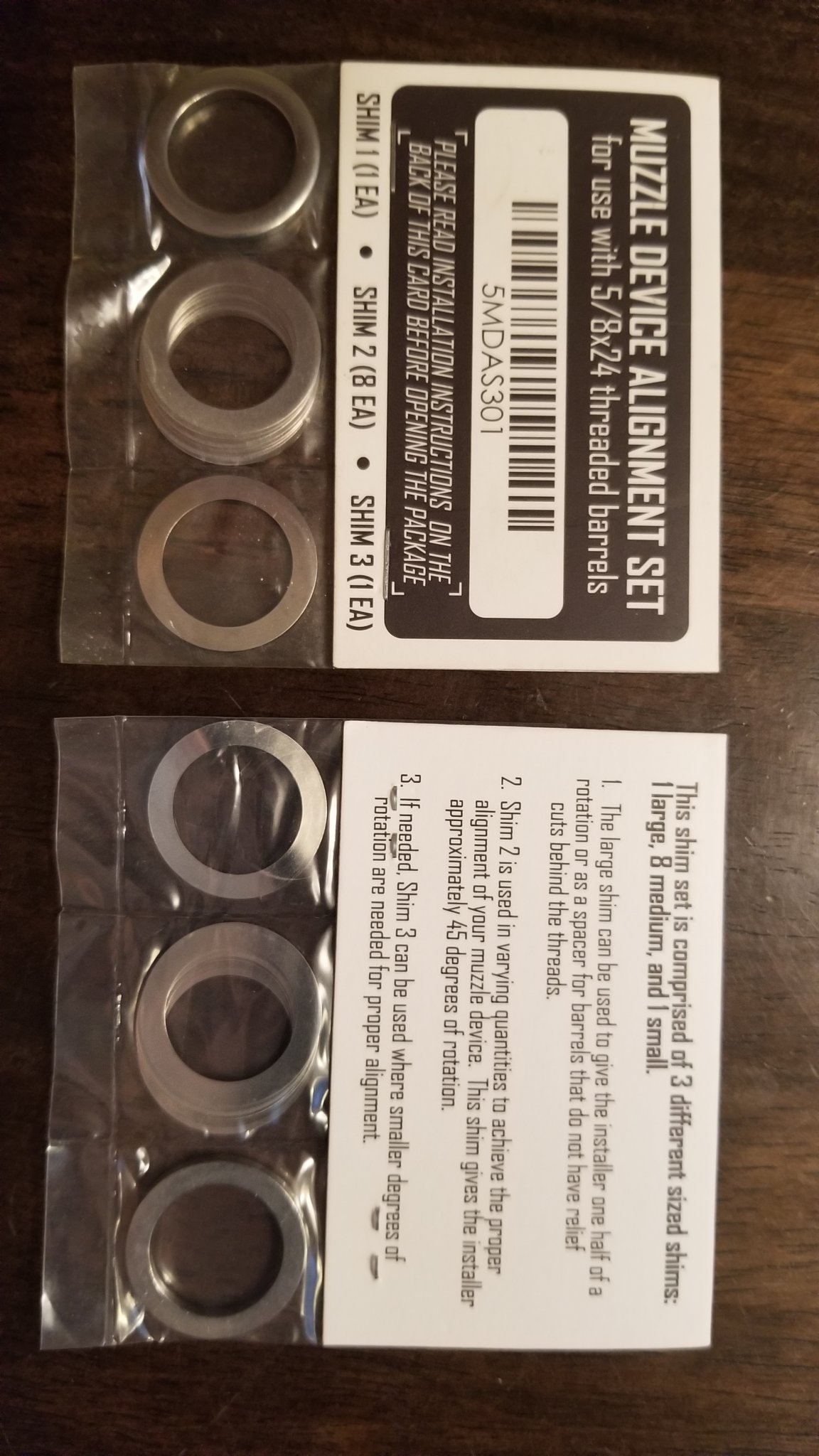

    Shim sets have different thicknesses, each thickness represents a different amount of rotation. Use the minimum number of shims to get the job done.
    TBAC and maybe some others ship a peel washer instead of a shim set. These look like a single washer, but are actually a bunch of thin shims and you can peel off a thin layer at a time until you get the desired rotation.
    Some breaks like 3 prong flask hides do not need to be indexed, and will ship without.
    It is important to have a solid shoulder for the muzzle break to sit on. If the shoulder doesn't make contact or the shoulder or is barely there (like when someone threads a thin barrel profile), bad things happen. Over time the suppressor puts uneven forces on the threads that can make them sloppy and out of alignment.

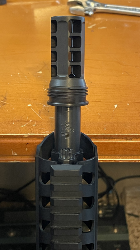

    I took the mount and lock nut off the end of the POF barrel and threaded on the mount without washers. See photo below, you can see the gas adjustment block which is at the 12 o'clock position. I need one of the flats to line up with that. Loosening the mount, but threaded almost all the way on, it definitely wiggles on the threads so it's seating against the ledge on the end of the barrel.
    So...I took the thinnest washer because I'm a weight weenie. This did not do the trick for either Faxon barrel but lo and behold, it was about 20 degrees off from where it needed to be. OSS's instructions are 30 ft. lbs or 20 degrees from hand tight. Man that was easy! Lined right up. I may go back and look at the other two barrels but honestly, they're lined up and tightened to spec and I'd rather not touch them. I'll check everything for alignment before I go shoot.
    And Old Man with Gun, I did not know some of that so the knowledge is very much appreciated! On the not using a rod, these are all gas guns so it makes it sort of difficult with hand guards, etc...I've literally "blueprinted" all the uppers, a semi-precision build (pun intended) and gone over every measurement/torque spec on each of them so I do not want to take them apart.

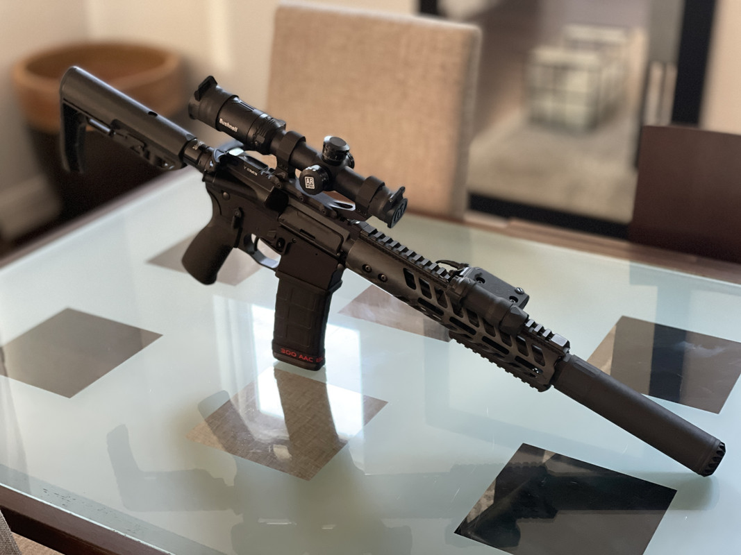

    ONE other issue I had was with the 300 blackout. I designed it and selected parts so that the suppressor starts to sit within the hand guard. I figured a thin wrench would be fine for removing the suppressor when hot and I "assumed" the wrench flats of the OSS at the rear of the can would be a normal, commercially available wrench size. Not. As best I can tell with calipers, it's about 33mm, maybe a hair over. So a 34mm flat wrench (sometimes referred to as a tappet wrench) would work. Can't find one anywhere. OSS lists a tool on their website which looks like it interfaces at the front. I've also seen an OSS "wrench" listed on various web storefronts but no photo. I'm a little wary of ordering it and finding it's just a wide wrench and won't work in my situation.
    You can kind of see how many shims I used to align it properly on the 300BLK.
    And an overall of the rifle because why not? Sub 5 pounds without the accessories, nothing super exotic other than the Smoke Carbon hand guard and buffer tube. I use the same lower with a 5.56 upper and matched the BCG's so no changes have to be made. Slap on the upper and go! Same lower function, same trigger, keeps things nice and consistent. When crazy ends I'll purchase another lower and build it up.

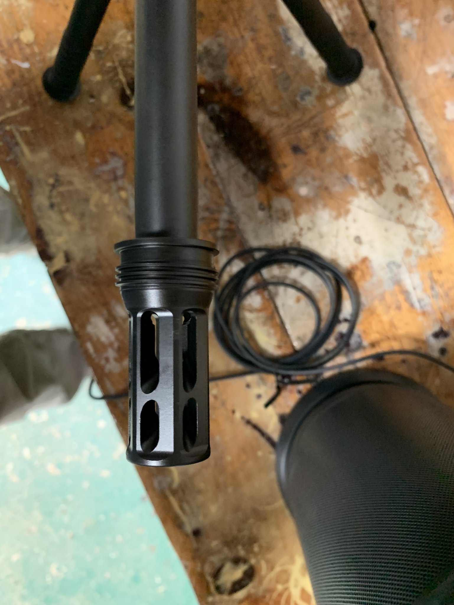

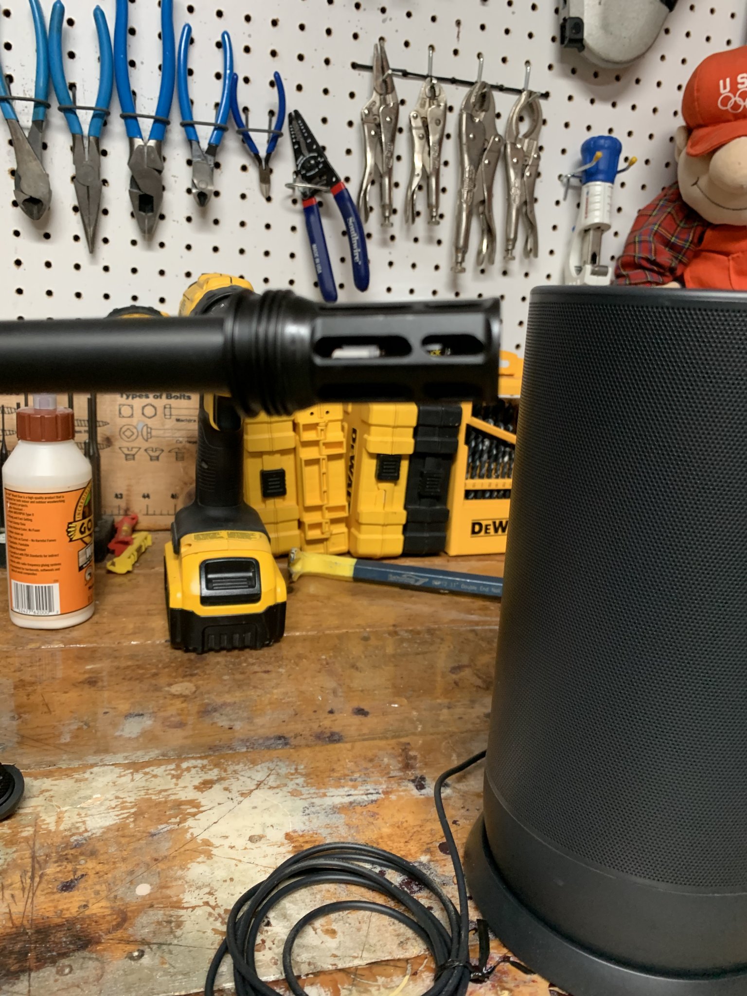

    IMHO, the timing of a brake is only important whenever the firearm is used without a suppressor. Think about this for a minute. If you were not firing the rifle with a suppressor then the direction of gasses escaping, and resultant force vector, would be a critical factor in the alignment of the barrel with the target when the bullet exits would be important.
    The suppressor will only permit the gasses to escape in one direction. That direction is forward with the bullet.
    Below are two brakes from the OSS Gen 5 suppressors. As you can see, one is a little off and the other one is way off.
    The only problems that I encountered were with the rifle that has the brake that is way off. That was when I tried to zero the weapon. Without going into detail, the errors were all my fault. I zero in the prone position with bipod. I forgot to extend the butt pad because my head moves far forward in prone.
    I got frustrated but decided to take it to a long range shoot anyway. After shooting at a 200 yard target with winds DEAD calm I could see that I was .2 mil right on windage. I dialed in the correction and with the exception of a couple of my errors in wind estimation, the rifle exceeded my expectations. I shot at targets that day out to 900 yards and without bragging too much was able to hit steel consistently. Any misses were due to incorrect wind estimate as my elevation for the shots was correct.
    I tell you this because I don't believe the timing of the brake is important unless you were shooting it without a suppressor.
    I only fire these suppressed. I can imagine the problems I would encounter without the suppressors but I'm not concerning myself with that. If I were taking these rifles into a tactical situation then I might put some peel washers on the threaded barrel to time both brakes.
    I don't envision myself taking my toys to the sandbox to play with. Even if I did, they will be wearing suppressors for obvious self-interests.

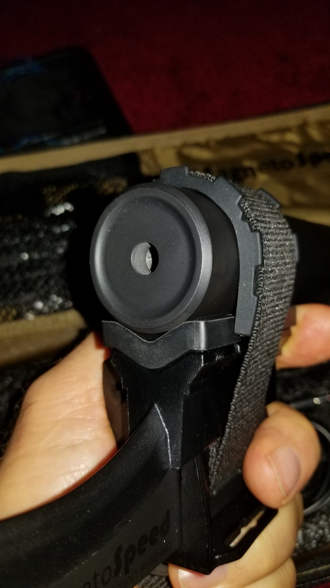

    I'll likely shoot suppressed but when I'm developing a load I have a Magnetospeed attached to the rail on the bottom of the hand guard. It wouldn't extend out far enough to take readings without strapping it to the suppressor which would NOT be a good idea, LOL. Luckily I'm only developing two 300 BLK loads and I pretty much have all my .308 and 5.56 developed.
    I had been shooting the 300 with the OSS muzzle brake prior to the suppressor's arrival and it does project quite a bit of blast back and to the side. Never felt a thing with the POF muzzle brake.
    I attach my magnetospeed to my suppressors all the time. I start cold and either keep the round count low or rate of fire slow. Never had a problem.

    Here’s a video from OSS on installing the muzzle brake. Notice that he doesn’t say anything about timing.
    IMHO if you’re going to shoot without the suppressor then time the brake. Otherwise if using suppressor 100% of time then it doesn’t matter.

    Agreed about the timing on these muzzle breaks/flash hiders
    I have used accu washers
