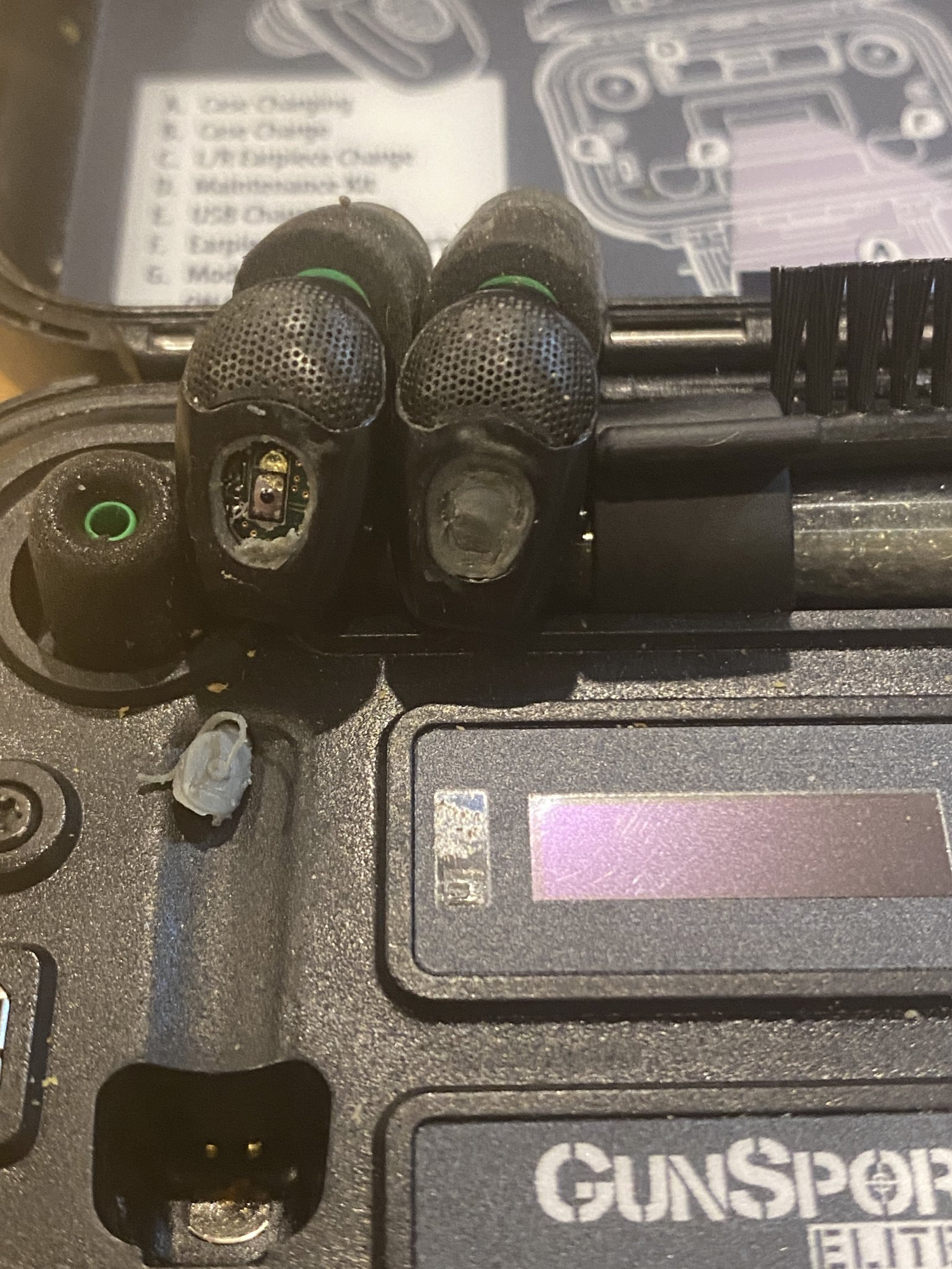

Rubber cover fell out of the left one. The right one is still there but the rubber is soft and runny.

Looks to me like chemical damage possibly. I would guess from sunscreen or deet.
ETA- I have had mine a couple years now and no similar issues but after having lots of plastic or rubber items melted from chemicals used to protect when outdoors I have become extremly careful about the products I use.

Hi Silverjay, I'm an engineer at Etymotic Research.
What date/lot code is lasered on the underside of your earpieces?
The original material for the button covers was replaced in mid-2020 for a material with better chemical resistance. Since the change, we have not seen any new earpieces returned for disintegrating buttons. We consider this a design defect and will honor warranty replacements for this problem past the factory warranty period. I will make sure that customer service is aware of this warranty criteria.
If you want, please message me an email address and I can get you in touch with someone to start the return/credit/replacement process.
