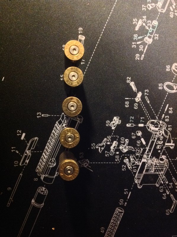

I am having over pressure signs with my 5R .308 with an 18" barrel using a YHM Phantom Ti Suppressor. I'm using Winchester brass and 168 gr Amax loaded with 43.5 Varget. I have backed all the way down to the lowest powder charge in my hornady book and still get pressure signs with 32.6 grs of Varget.
I am thinking the brass is the reason unless you all think it could be something else? Just for grins i bought some factory winchester 150 gr power points and still got the pressure signs.
Any help would be appreciated. Thank you
what pressure signs are you getting? If you are getting it from factory ammo then you may want to have a smith check the chamber. Can you post some pics of the pressure issues you are having?
Remingtons are pretty known for showing primer cratering. You can't use that as your only indicator. My spare cratered everything I put in it. The edges were still round though and not at all flattened.
Top to bottom grains of varget. All primers showed the same signs. I'm wondering if it's just my gun and not an overpressure issue.
32.6
35
38
40
43.5
Tough for me to see any detail but the one thing I can see if the primer cratering and that’s about what mine look like out of an unbushed bolt. If the edges of the primers are still rounded and I f you don’t see any round marks from the ejector then I would say it’s a false sign and due to the chamfer and generous space around the firing pin.
Those are not pressure signs. Look at your firing pin hole. The primer is going to flow and confirm into that dish like lead flows into a mold. Pressure gonna show itself as ejector marks and or heavy bolt lift with sticky extraction. I load 46grs of Varget in that brass under that bullet.
