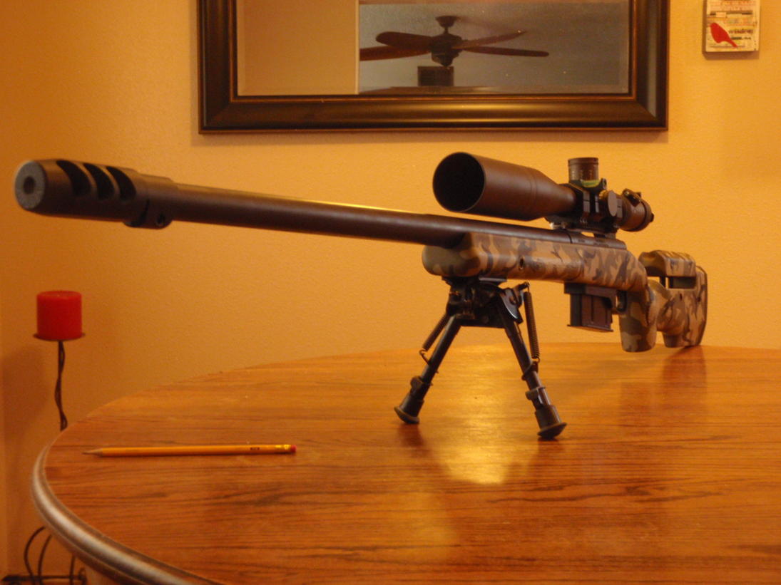

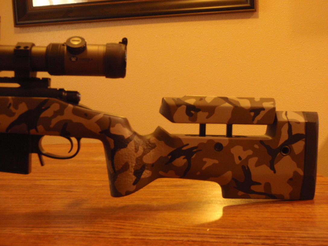

My stock is just a Manners T4A stock on a Remington action with a HEAVY Varmint profile Bartlein Barrel. The Muzzle brake is a Big Chubby. The recoil really isnt all that bad with the muzzle brake on. But for some reason The sharp/peaky cheek riser seems to cause my cheek some discomfort after 30+ rounds. My origional stock had a Eagle buttstock cover in place and it was padded, so I never had this experience. I did site down the barrel as you described. The cast of the stock appears centered to me. If its off center at all, I dont notice it. Hopefully My picture loads OK.

Nice stick!!
Without a ruler to see length of pull, it looks a little short to me but I'm not you. Might be cramping you a bit.
Zero cant is usually fine on a stock like that. What you don't want is cant the wrong way i.e. into your cheek.
The top of the cheek pad on the stock does look almost masochistic to me. The little cheek pad should go a long way towards helping that.
I don't know the center to center dimensions of those posts holding the riser up but they look really similar to the ones on my AI AX folder chassis. You may want to see if you can get dimensions from somebody. The AI cheek piece is much rounder and that may be all you need. I'll measure mine in the morning. Reason I suggest that is the little pad is gonna offset your eye from the centerline of the scope and you may have to force your cheek even more into the cheek piece which will kinda defeat the purpose. I'll measure my posts tomorrow and let you know.
