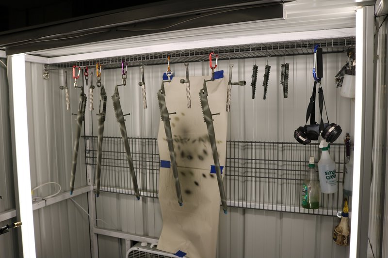

A few years ago, I built a roll-around coating booth out of square tubing and Polar White colored R-panel. Put a butt load of LED panel lights (roughly same style and shape as the old 48" double fluorescent shop lights.) LEDs above and on each side of my work area inside the coating area. The light is very even with no shadows. Also, the LEDs produce no heat!
