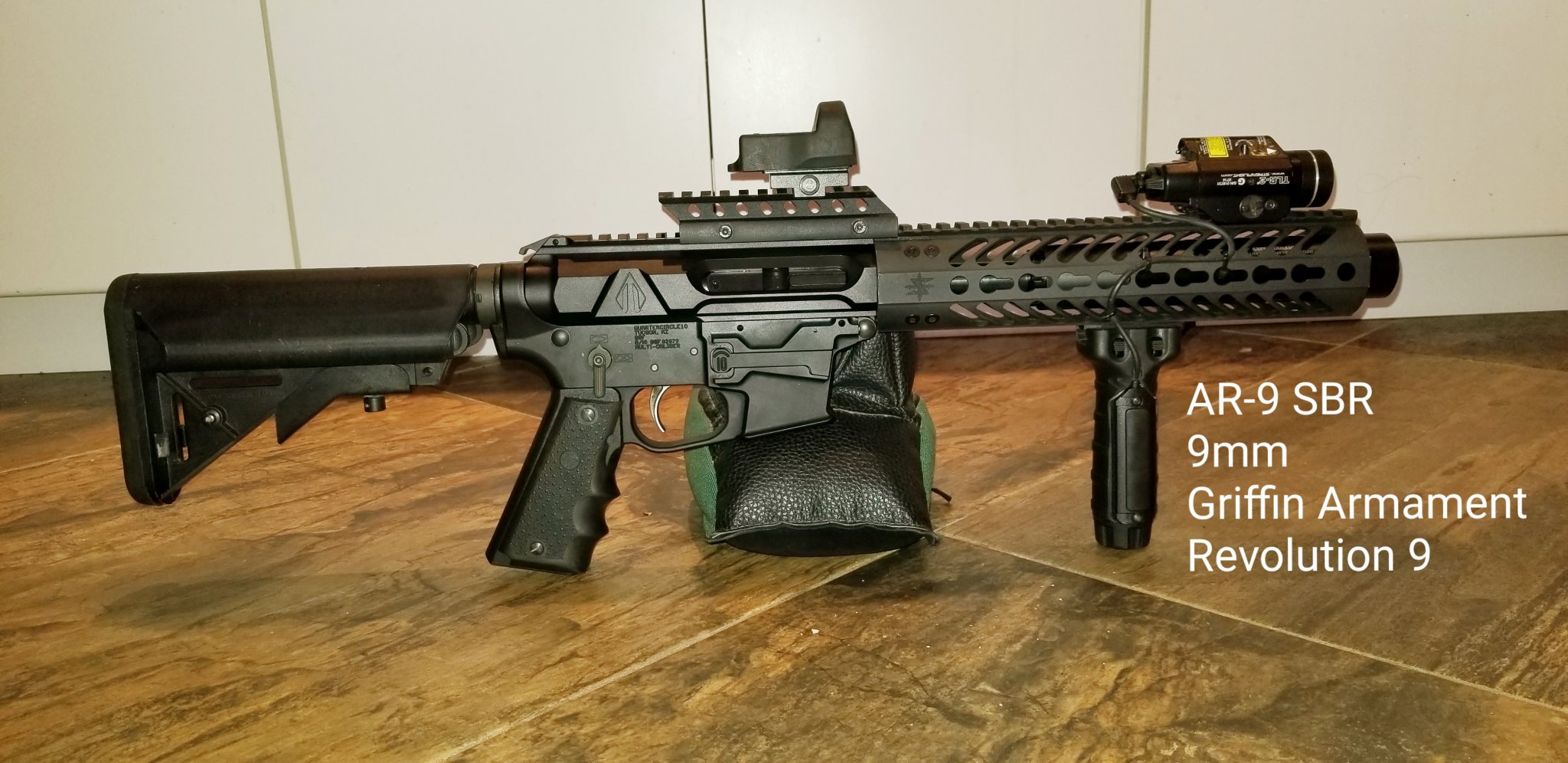

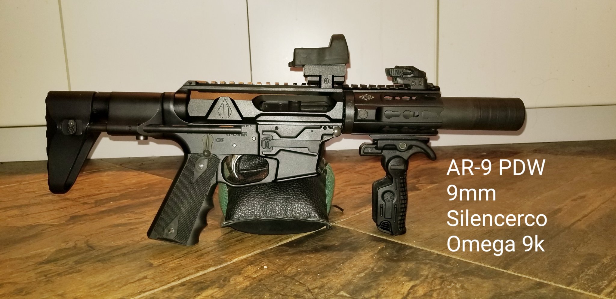

I have 2 QC10 and love them both. Not all triggers and buffers work with PCC so watch that. I'll post the specs on these when I get home to my notes.
CMMG has a delayed action that is probably safer than straight blow back. I built mine before those options existed.
Not all triggers and buffers work in PCC. Avoid bump stocks as they can cause out of battery detonations.

Here are my builds:
QC10 lower- Glock, B5 Sopmod stock, blitzkrieg hydraulic buffer, ALG ACT trigger, Gibbz side cocker upper, QC10 bolt-Glock, 5" Tros 3-lug 1:10 barrel, Seekins MCSR v2 10" handguard and SiCo Octane 9 suppressor.
QC10 lower- Glock, MVB ARC stock, MVB 9mm buffer, ALG ACT trigger, Gibbz side cocker upper, QC10 bolt-Glock, 5" Tros 3-lug 1:10 barrel, YHM 4.25" KR-7 handguard and SiCo Omega9k suppressor.
