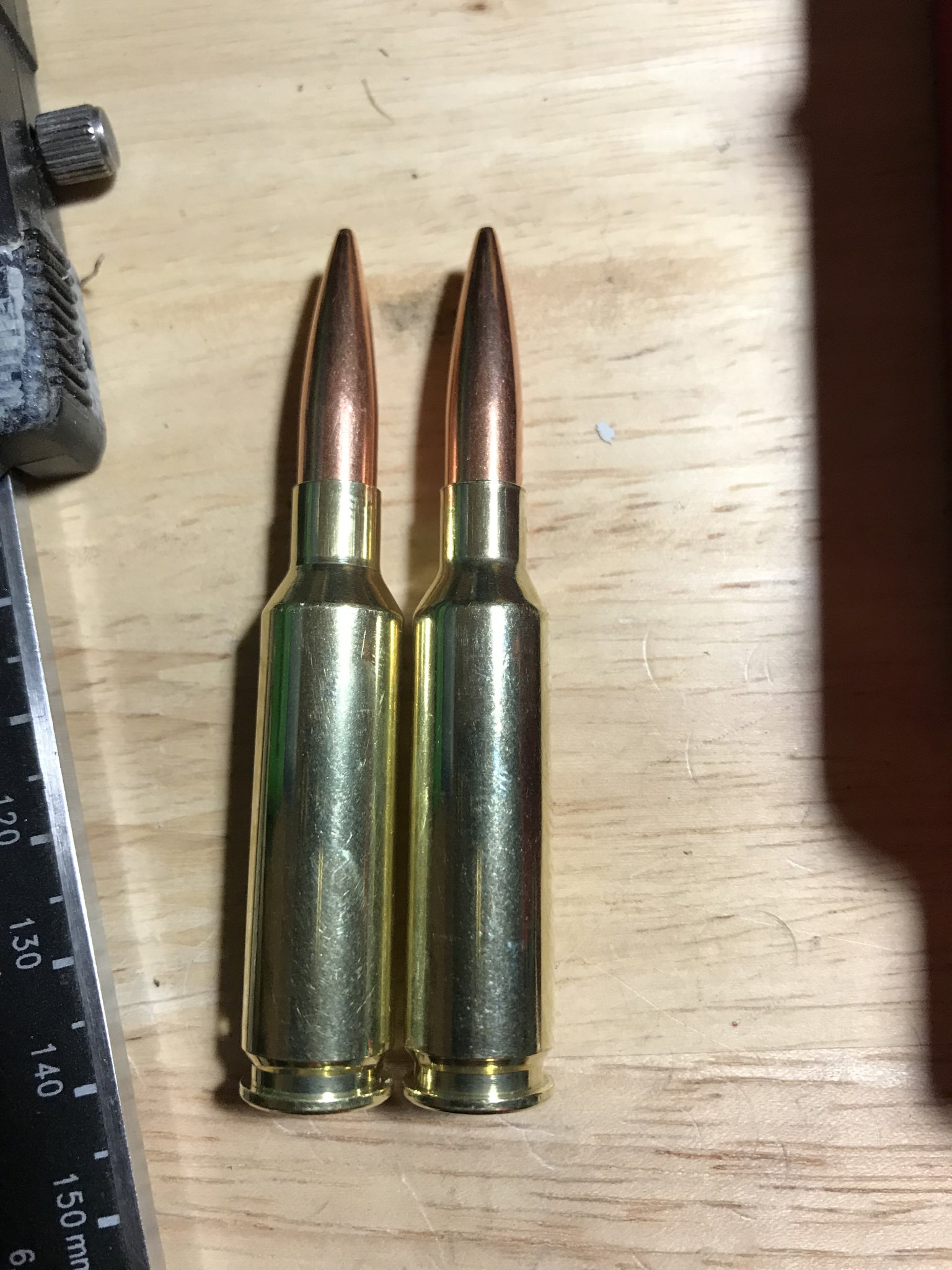

So a couple weeks back I purchased some once fired Peterson SRP (Palma) brass off the PX..
I currently shoot a Bergara lrp elite in 6.5 cm
Have loaded new in box Peterson SRP and have had no issues chambering rounds...the difference with this brass is it says (Palma) on the bottom and that is the Only difference (by eye) I could tell
My process on the once went as follows....
Full length size
Clean
Trim/chamfer
Prime
Powder
Seat bullet
I went thru a random 40 of the 200 I loaded and maybe half the bolt wouldn't close
Btw I loaded the same load in the other Peterson brass last week and it was fine
Same base to ogive... same exact process
Any ideas on what the issue is?
Btw I shot the same exact loan today except with starline brass

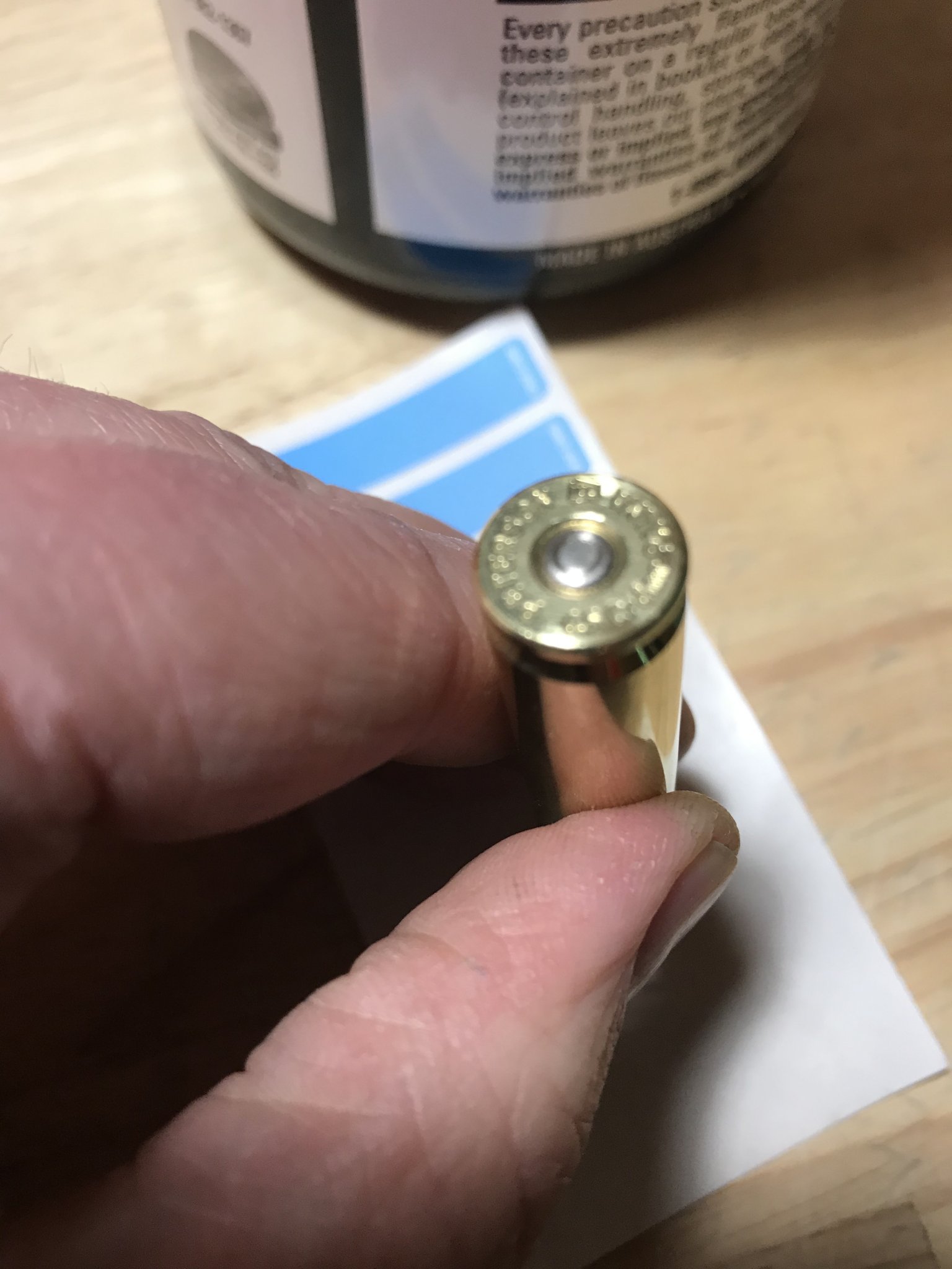

I did get a weird mark on the primer...see pic.. also included a pic of the starline load right next to the Peterson load
Please help! I hate pulling bullets!

It is possible that your fl die did not push the shoulder back far enough on the brass when you sized it. Screw the fl die in about 10 degreees or until it firmly touches shell holder and try again. If you don’t have a Hornady head space gauge set I suggest getting one. This tool is well worth the money and is simple to use and will also potentially make your Brass last longer.
They sell the Lyman version at my local gun store.. I'll pick on up for sure
I'll take a look at the die..
Usually what I do is touch the die to the ram then back out a 1/4 turn
Having the gauge will really open your eyes on how far you need to bump the shoulder back. I had to take the belt sander to some of my case holders to get the shoulder pushed back properly. Properly in my opinion is about 2 to 4 thousandth’s.
That mark looks like its from the firing pin hole on your bolt, probably from trying to close the bolt on a piece of brass that is too long (your resizing wasn't enough). That being said your primers also shouldn't be making contact with the bolt, probably a shallow primer hole on one (if not many) of your brass, you need to fix that. In your pic with two cartridges side by side the neck and shoulder on the right hand one is visibly longer than the left, that definitely speaks of a resizing problem, but you should pick a gauge and measure, eyeballing it isn't enough.

Are your primers just under flush with the case head? I had some Peterson SRP brass and had a difficult time seating primers to .004" less than flush, and most of the time, they sat proud of the case head.
Measure the depth of the primer pocket, and then measure the height of your primers.

Looks to me like your primers aren’t seated below flush with the case head. Either you’re not seating them deep enough or the primer pockets are cut too shallow to allow correct seating.

I'm with this guy, the first thing I would do is uniform about 10 primer pockets and get the primer seated deeper. If that does not work, start measuring the web area and above, do this brass and fired brass and see what numbers you get.

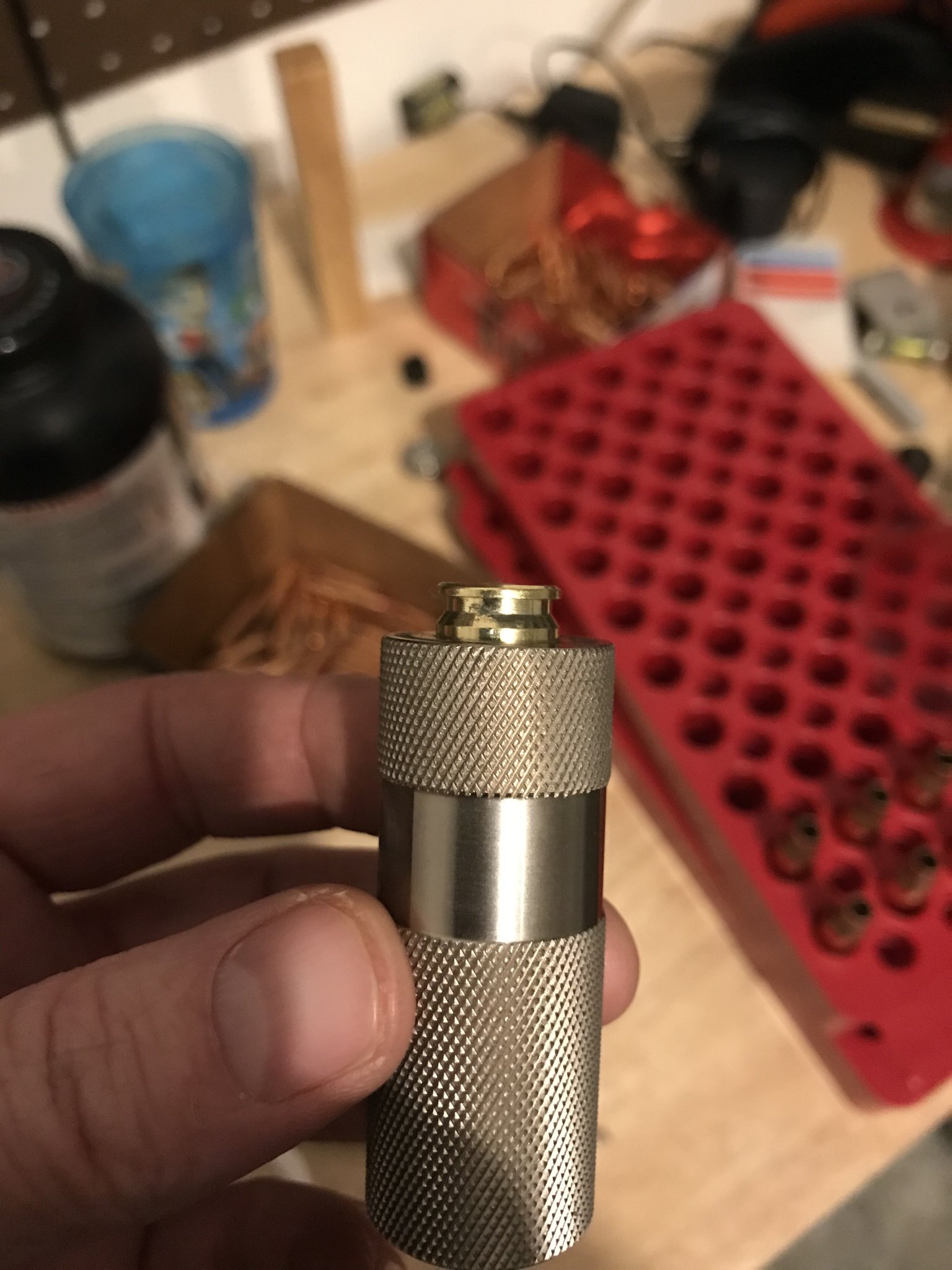

This might sound dumb, but do I turn the sizer in or out to bump the shoulder back... I would assume in
I've always just screwed in till hit the ram then backed out a 1/4 turn....also inspected my die last night there was a bunch of lube build up on the stem, so I put it in the ultra sonic for a few minutes
Thanks, for all the help guys.. I have a hornady headspace gauge on the way

There's a good chance based on your pictures that the primers not being seated flush caused your problem and that needs to be addressed also. Get a primer pocket uniform tool and use it, make sure you are bottomed out on the shoulder of the tool when you uniform the primer pockets. The above post should help you get your sizing consistent. Both of these fixes should help you make more consistent hand loads. Remember no two brands or even lots of the same brass are identical, go slow and measure anytime you are changing up any reloading component.

I had this issue with my prime one fired brass when I first started reloading. The primer pockets were way shallow. And I had to turn the FL sizing for right against the shell holder to get the shoulder bump that was needed. I think it was a little combination of both that wouldn’t let my bolt close easy.

I have all of them except the headspace comparitor..
I know I fucked up in not checking it in a headspace gauge first.. will not do that again and now that i wasted all that time and money. I'm going to stick with Peterson for match ammo and starline for my plinking ammo..
I'm going to try the base sizer if that doesn't work I'm trashing these...
