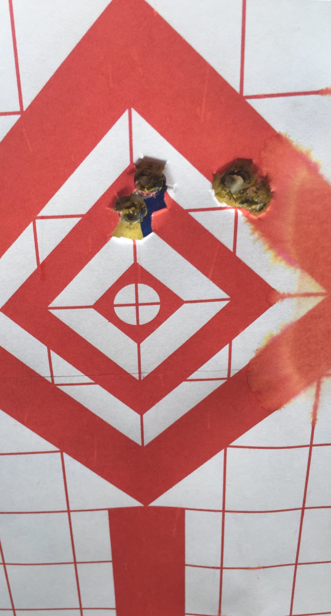

Finally got a chance to look at it a little closer. The weight variation for 50 was 1.2 grns. Had I kicked out the 1 lowest weight case, it would have been less than 1 grn. Length was within 3 or 4 thousandths. I loaded up 20 of them after running through my F/L sizer to set the neck tension the same and make sure all were round. Neck thickness was .013 measured in 4 different places around the neck. Very uniform. All flash holes were deburred and centered. We’ll see how they do after I put a little pressure on them.
Got a chance to heat up a few and I’m impressed. Cases stretched .002 and resized very easy. The necks seem pretty soft and don’t have very much spring back. Ran some through my concentricity gauge before sizing them new and they ran 0-.002. Found a good load at 72.0 grns IMR 4350 with 150 grain NBT in new unfired brass. May have to tweak it a bit after it’s fire formed. This is 2 separate groups shot before and after scope adjustment. I think it’s a keeper.
