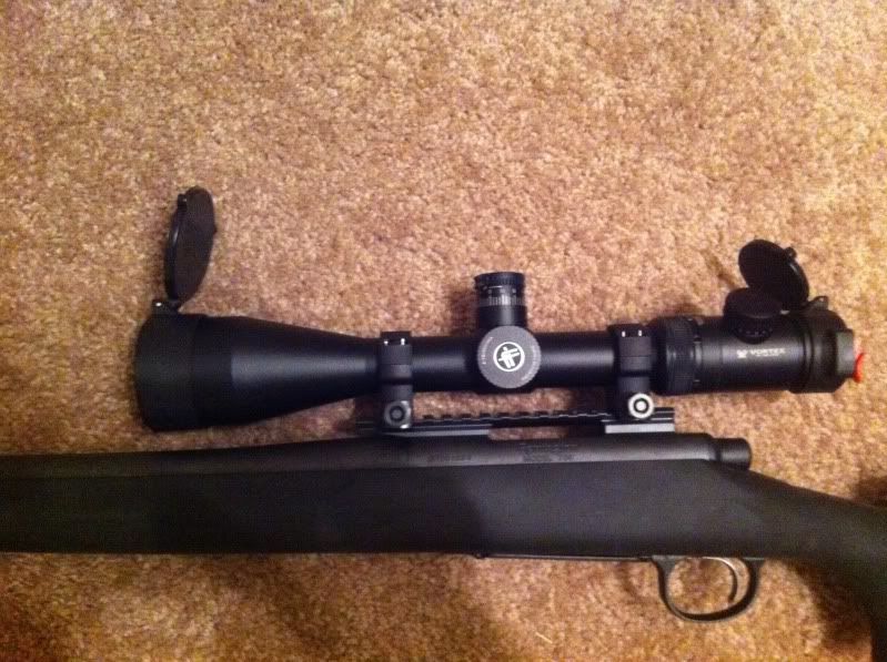

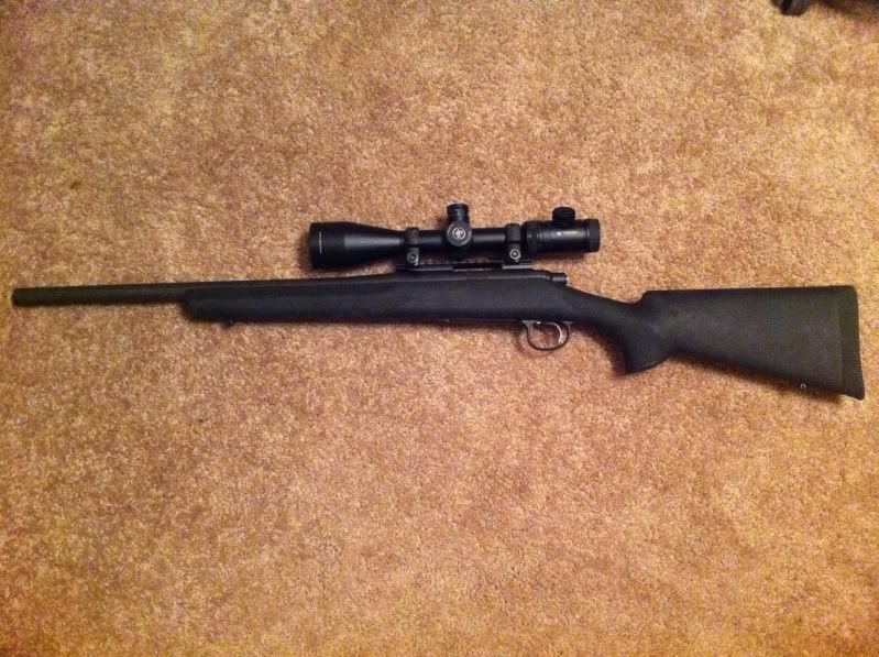

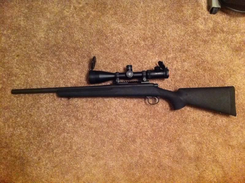

Hey guys. Wanted to throw up some pics, the scope came today. Thank you all again for your help setting up this rifle and putting up with my noob questions. I appreciate all the help. & Thanks to Mike @ CS Tactical for hooking me up with the scope. Check him out at www.cstactical.com; great inventory, great guy, great prices; fast shipping.
Remington 700 SPS Tactical .308
Vortext Viper PST 4-16x50MM
Nightforce 20 MOA Base
Leupold 30mm High Aluminum Rings
Buttler Creek Flip Caps

I have no way of knowing your body composition, but would suggest a stock pad/ cheek riser as it looks like you may need one to keep proper cheek weld with the stock/ring setup you have.

I believe you probably could have gone with medium rings, the scope is a bit high.
cut an old mouse pad in half and tape it to the stock with duct tape.
Get it thick enough so that when you get on the rifle in your natural position, your eye lines up with the scope.
The easiest way to check this is to get on the rifle with your eyes closed, once you have your cheek weld, open your eyes. If you are not looking through the scope, you need to sdjust the thickness of your "cheek rest".
A consistent cheek weld is important to consistent, accurate shooting.

Nice stick, Also you need Low Rings, the Highs are too high for a 50obj. Make that switch and get an Eagle stock pack your good to go.
