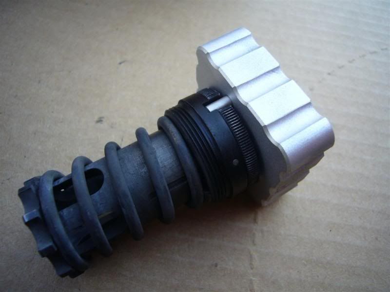

This is the piston housing removed from the suppressor body. There is a dis-assembly tool (the small shinny part in the pic ;-) that comes with the suppressor.
