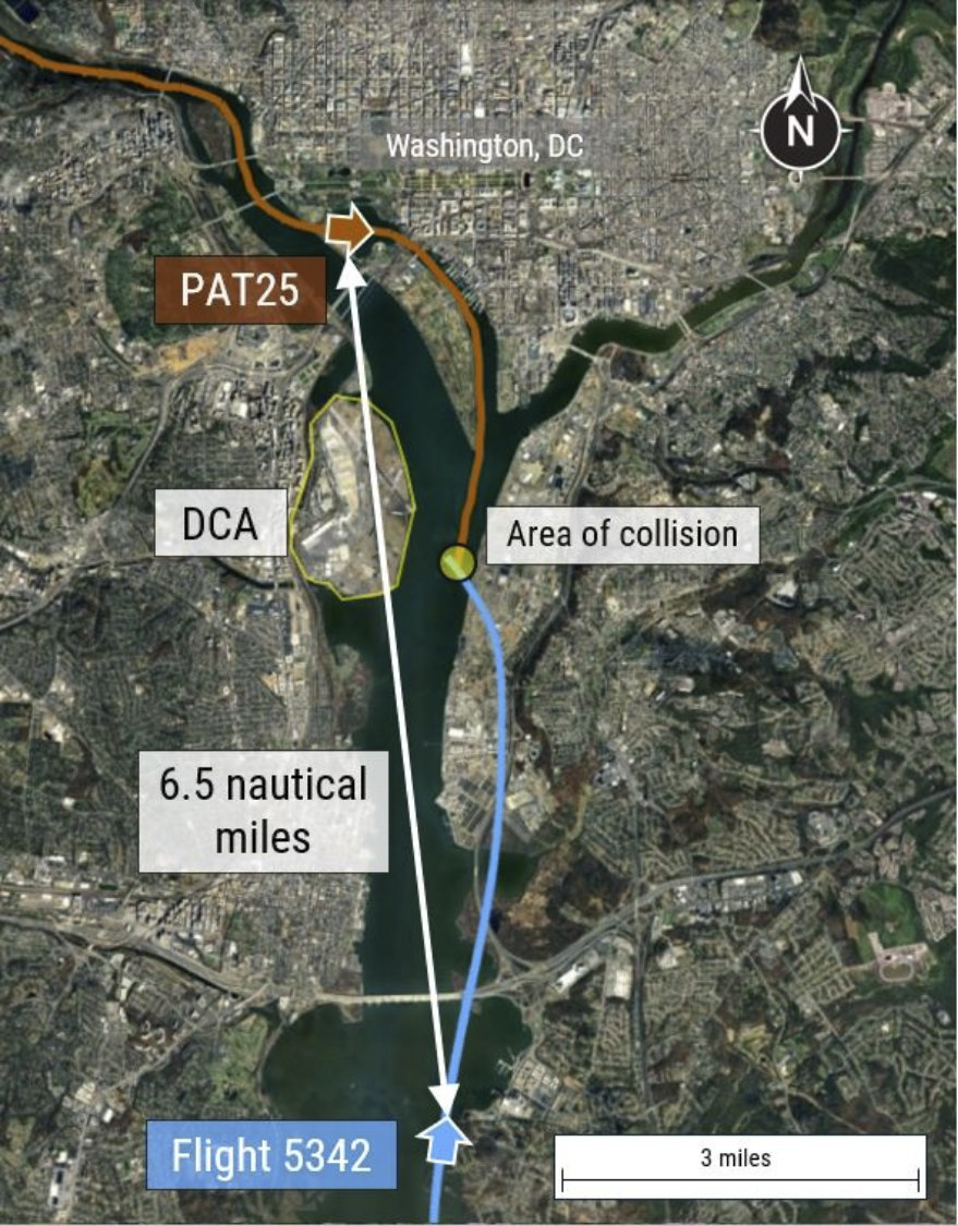

The interesting part of the "History of Flight" part of this accident starts at Page 5:
5 of 20 DCA25MA108
This information is preliminary and subject to change.
At 2046:02, a radio transmission from the tower was audible on flight 5342’s CVR informing
PAT25 that traffic just south of the Wilson Bridge was a CRJ (flight 5342) at 1,200 ft circling to
runway 33.
CVR data from the helicopter indicated that the portion of the transmission stating the CRJ
was “circling” may not have been received by the crew of PAT25. The word “circling” is heard
in ATC communications as well as the airplane’s CVR, but not on the helicopter’s CVR.
At 2046:08, the PAT25 crew reported that they had the traffic in sight and requested to
maintain visual separation. The controller approved the request. At this time, the distance
between the two aircraft was about 6.5 nm. Figure 2 shows each aircraft’s approximate
position at 2046:02, when the controller first advised the crew of PAT25 of flight 5342.
Figure 2. Google Earth image with airplane and helicopter preliminary flight tracks overlaid,
and each aircraft’s approximate position shown at 2046:02."
The Google Earth image above is incredibly telling!! When the PM said "we have a visual" Flight 5342 was 6.5 Nautical Miles away. That's a long ways at night when flooded by a ton of lights everywhere you look, but definitely not impossible...
More importantly though, The white "visual line of sight" between the two aircraft is exactly right over runway 11, at the same time that another similar aircraft had just taken off and was climbing towards the North.
Again, This is not over yet. All speculation and assignment of guilt is way too premature. Which aircraft was PAT25 looking at???

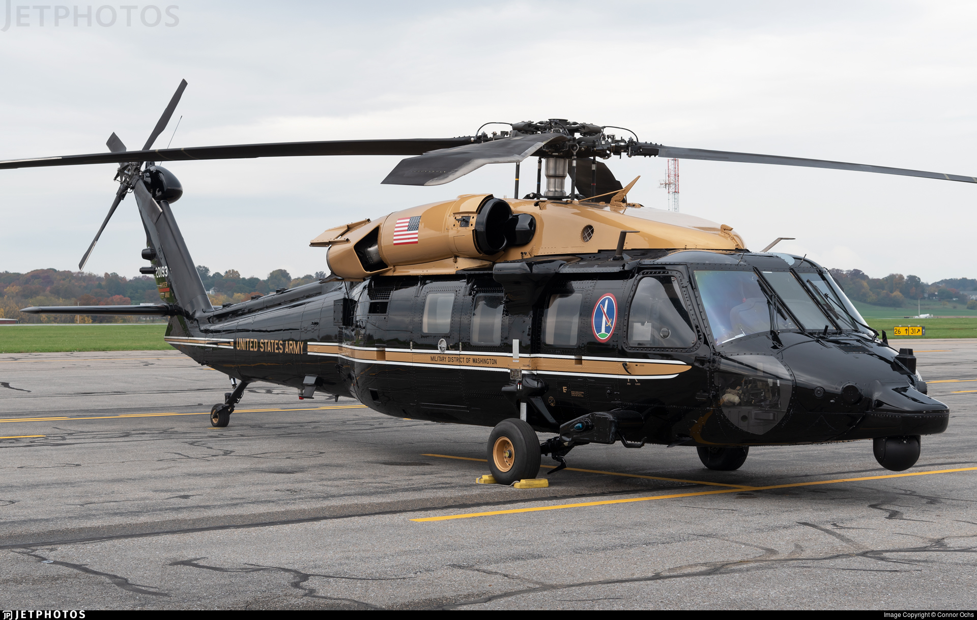

Quite possible. Another point that has been made is the they were flying with "NVGs". This I find doubtful because "PAT" army Black Hawks are an elite unit and should be state of the art aircraft. PAT stands for "Priority Air Transport". They are mainly used to transport VIPs and high ranking officers. The crews are select top notch aviators.
Below is an image of one of these helicopters, known as "Gold Tops" (for the paint scheme). You can see a FLIR pod under the chin of the aircraft. That is an incredible and very sophisticated vision system that would negate the use of night vision goggles. The images are displayed on the control panel....
Understand that I'm speaking from a position of a flight-sim nerd, not an actual pilot and I'm not familiar with exactly what was in the Blackhawk in quesiton...
BUT, flying something like an OH-58 in DCS using the MMS FLIR on the MFD's on the dash at night without NVG's is disorienting as hell, especially if they aren't looking in the direction of flight. NVGs are immensely preferable for low altitude navigation and general SA. The only exception to this I would concede maybe is what the AH-64 has with the helmet mounted display that overlays NVG/FLIR over the top of your view in the eyepiece/visor. I don't think they have that sort of system for the Blackhawk but again I'm not intimately familiar with this model/program.
Imagine turning your headlights off at night and putting a FLIR display on an IPAD on your dash from a roof-mounted pan/tilt/zoom thermal and driving that way. You'll run into static objects, let alone other blacked-out vehicles. JMO
