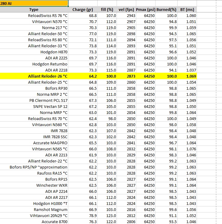

I’ve read some powders are harder on barrels than others, burn temperature of the powder which is different and not directly related to the burn rate. RL-26 gives excellent velocities and good accuracy in both my 243 and 300 WM, but I’ve read it’s one that burns barrels. This should something to think about when selecting a powder. Hopefully someone who has more experience could chime in on that aspect.
Dammit, I just settled on RL-26 for my 20 inch 280 Ackley Improved project.....
I actually really like RL-26, I just read over on the Bolt Action forum a post we’re they claim it’s hard or barrels. I haven’t read a definite study on this, but I’m getting this impression.

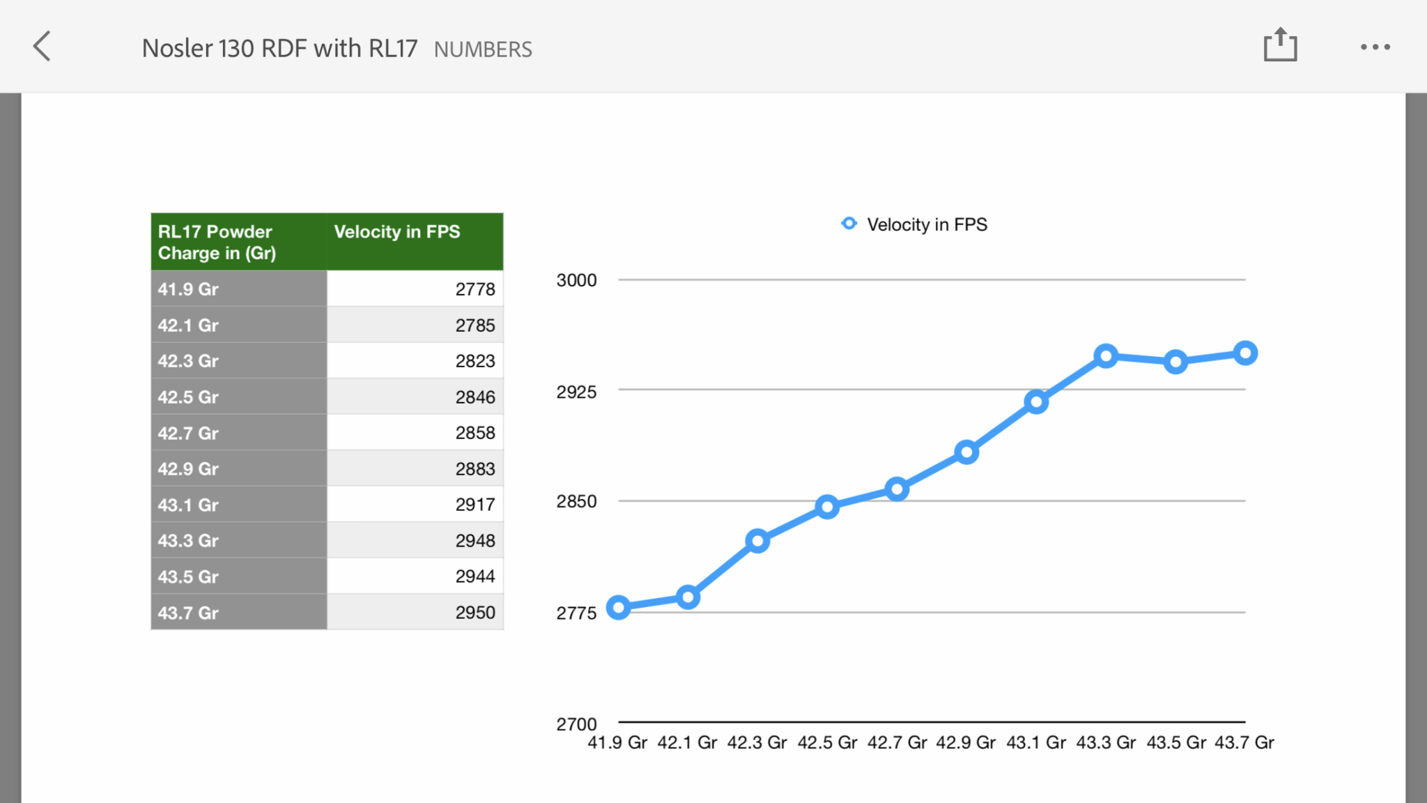

Not giving my opinions on this method, but H4350 is the quintessential powder for load development using velocity ladder tests, looking for flat spots. Trying the same with RL 16 &17, VV N540 & 550, you will never see one if 2 shots are fired.
7073273
Here is a 10 round speed test with RL17 and 130gr Nosler RDF in a 6.5CM. As you see, I have 3 rounds that are flat yet represent a .4gr spread of powder in the velocity I’m looking for. 43.5 grains makes this easy, just throw and go. A 10th either way is not going to have a bit of impact on my shooting.
