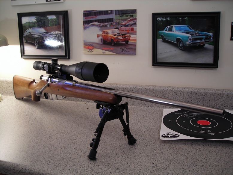

Everyone always asks me where I got a stainless barrel for a Mosin! :)

Nice rifle!! It looks like you just polished up the original barrel and left it in the white... I can still see the rear sight dovetail.
Definitely, ask away... I really didn't have too much problem with seating depth, but ALL my loads used a HEAVY crimp from a Lee FCD. I measured the throat in this rifle, and I had almost .250" jump!! Ya... 1/4"...
I've measured a few others... built some Mosins w/ the UK-59 barrel, have a couple Finn Mosins, and have a reamer that I've used for .308" barrel mosins. The tightest throats are the UK-59 barrels, and those have around 0.060" jump with the O.C.L. set at 3.000" (and a 174 SMK). Even the PTG reamer cutting new chambers has almost 0.100" of bullet jump to the lands.
I cut the original down to 24" and did a target crown. Yes I polished the barrel by sanding it w/ 1st and then polishing it on a wool wheel. I just jeep it oiled and it's been that way for 4 years.
I'm using a COAL of 3.002" w/ the 175 SMK. So far it's been around 1 MOA out to 400 yards. Not bad for an old gun, not sure it will get much better than that.
