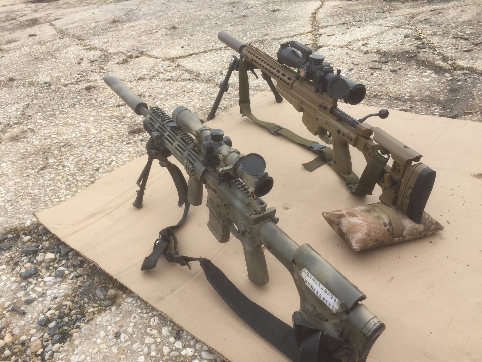

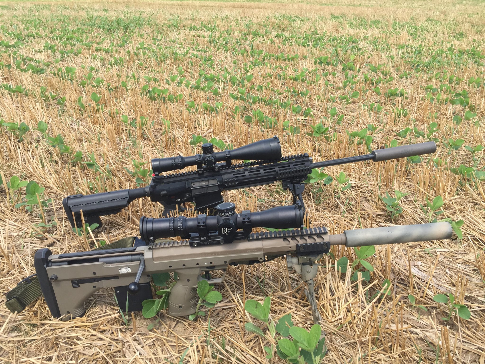

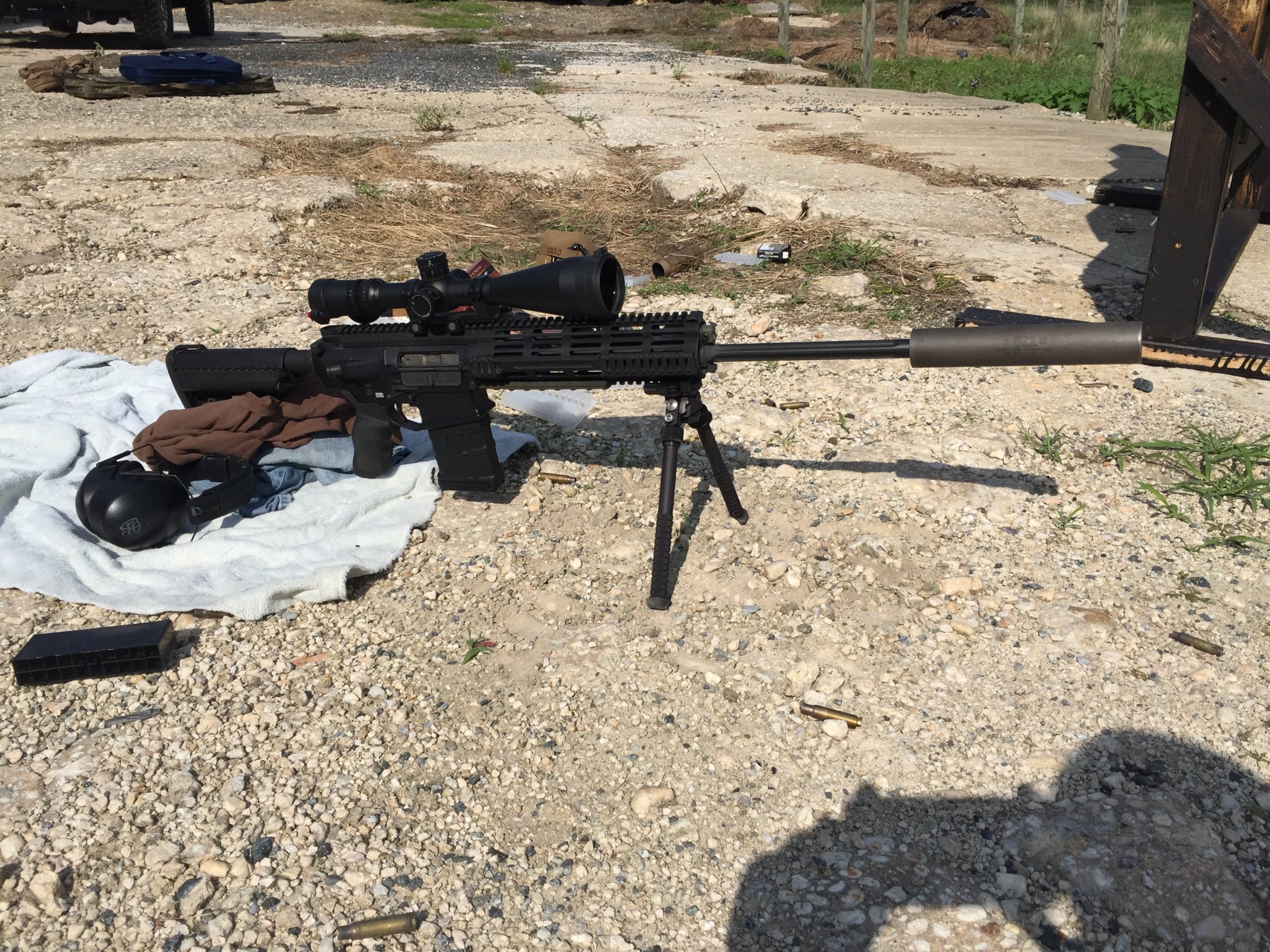

I have 4 PoF 308 rifles and they were always among the most accurate of my stable. I have had .gov types compare reach out to me to test accuracy and the POFs always excelled.
I can’t say what changed, as I have not kept up. Every time recently I have interacted with them it appears theirs focus changed a bit to smaller and lighter vs Precision.
It’s been at least 8 years since dealing with on any level, but you can’t argue the results, this was the last time I rezeroed my POF, 3 rounds touching and the correction put the 4th in the 3/8th dot in the center,

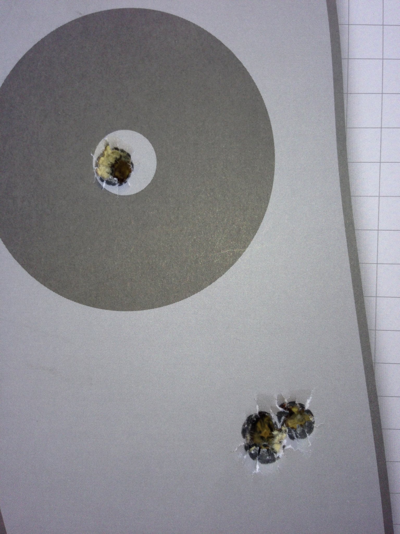

7088249

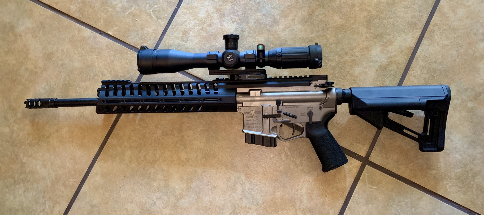

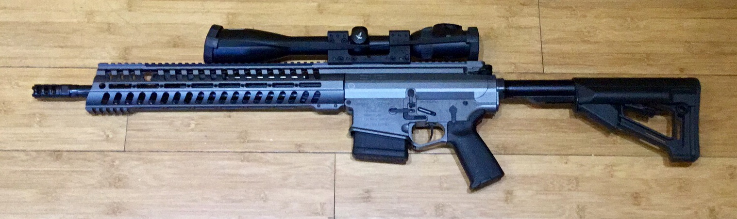

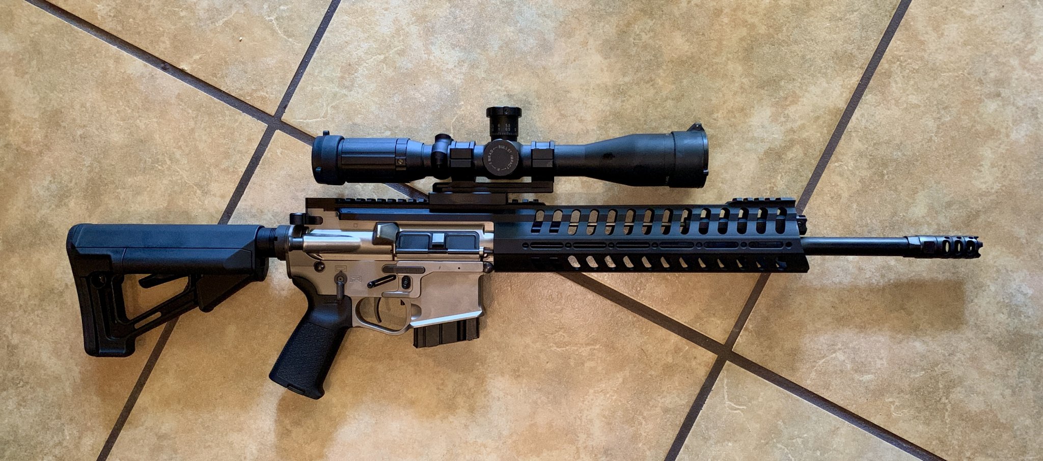

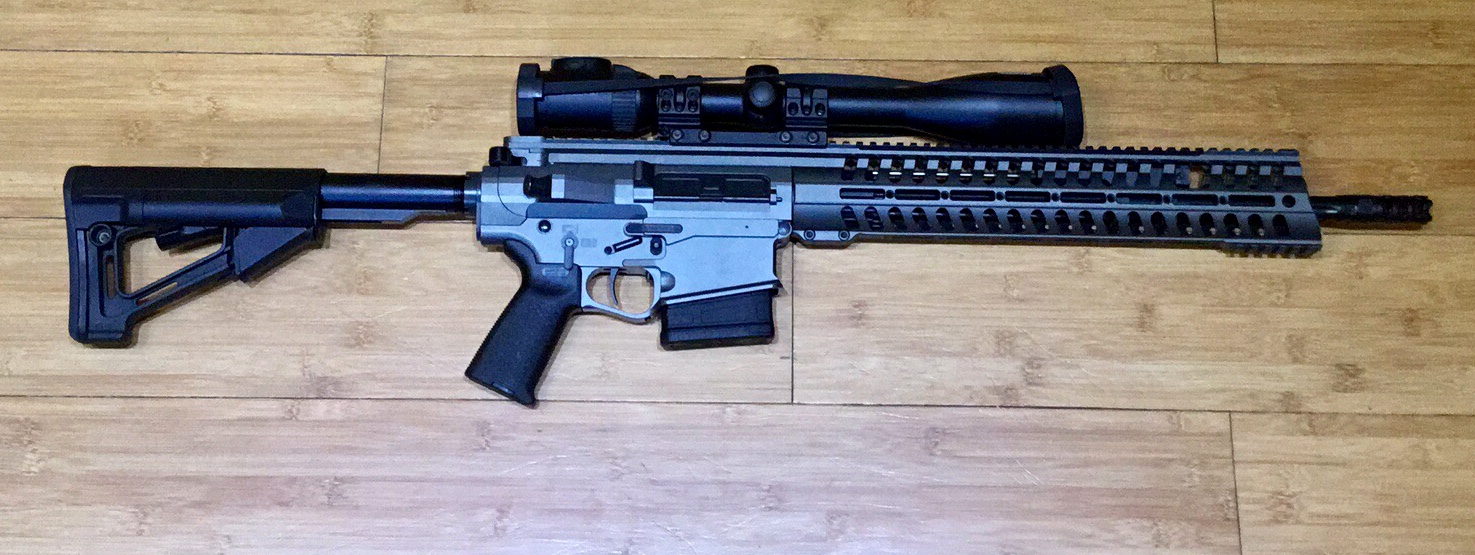

I have used this rifle for accuracy demonstrations and training videos.
All display this level of accuracy, so take it fir what it’s worth, those who complain about a certain “type” of results don’t really understand large frame ARs when it comes to precision shooting.
These are my POF 308’s. A bit on the heavy side but my more accurate than I....

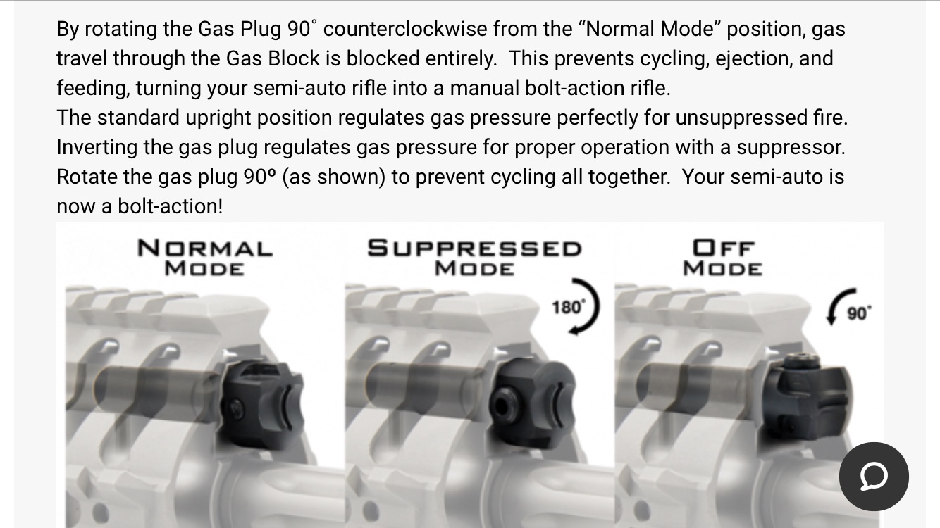

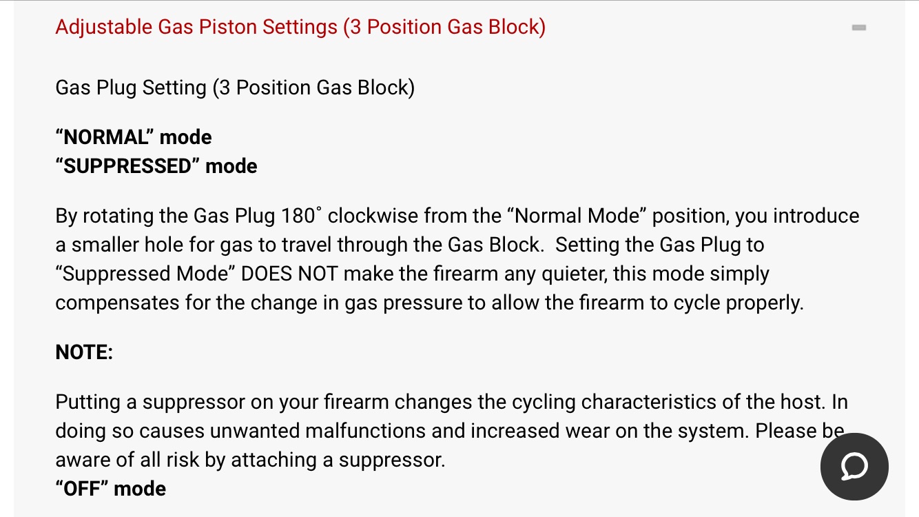

No sir told me they didn’t recommend suppressors and sure wouldn’t warranty anything with handloads being shot. I’m like you and can see we’re the genesis of the handload argument comes from. That doesn’t make me agree with their position though. If the three settings on the piston dont work you are out of luck.
I will say that I considered switching to an Lwrc and called them about their guns running with suppressors and they told me up front they don’t recommend it either. They explained to me that with all the suppressors on the market it would be impossible to create a gun that would run with them all.

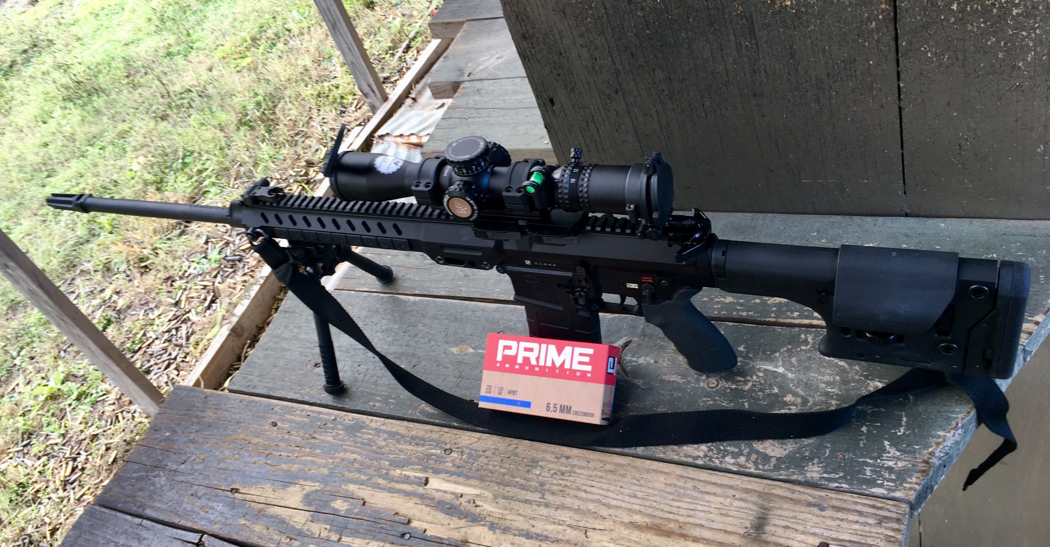

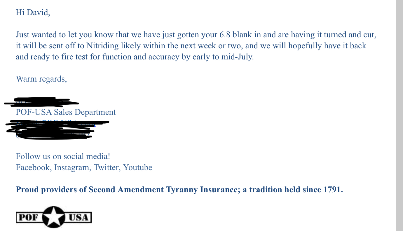

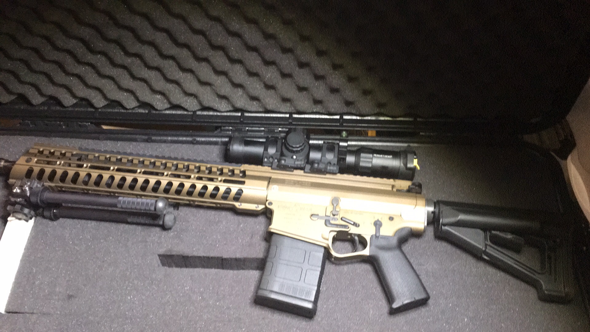

I apologize in advance. I’m (2) weeks late as I have been working Non stop. I wanted to inform everyone that I received my rifle back from POF approximately (2) weeks ago re-barreled in 6.8 SPC (2). POF in this day and age uses Green Mountain Barrels which I think are decent, cost effective, button rifled barrels for mass production but maintain good quality control.
Unfortunately POF no longer flutes their barrels which was a bit of a disappointment (I suspect it’s a cost saving measure like everyone else trying to be competitive in a different market than existed (5) years ago.
Having said all that, I HATED LIKE HEL to have to go thru so much drama just for a cheap re-barreling and a new adjustable gas block. I ONLY WENT THRU WITH THIS OUT OF PRINCIPLE. What cost them untold amounts of ridiculous publicity could have been totally avoided by just taking care of their customers as they VOW in their literature. What really upset me was I was a dam good customer of theirs owning (5) off their rifles (3) of which were over 2 K each.
I haven’t yet had the opportunity to shoot the re-barreled P415 , but I suspect it will shoot MOA and live up to billing. This has left a very, very bad taste in my mouth and it’s hard for me to get excited about something that cost me so much time, effort and emotion.
In the final analysis they did what they said they would do. I sincerely WISH IT WOULD HAVE NEVER HAD TO BE LIKE THIS.
I am extending a hand of SINCERE GRATITUDE AND APPRECIATION to everyone that was so kind and offered their encouragement and support during some very frustrating moments. The shooting community is a unique group but when their is obviously an injustice it’s my experience that we come together as a group which really makes great shite happen)!
GOD SPEED AND GOOD HEALTH TO ALL. Feel free to inquire if you have any questions.
