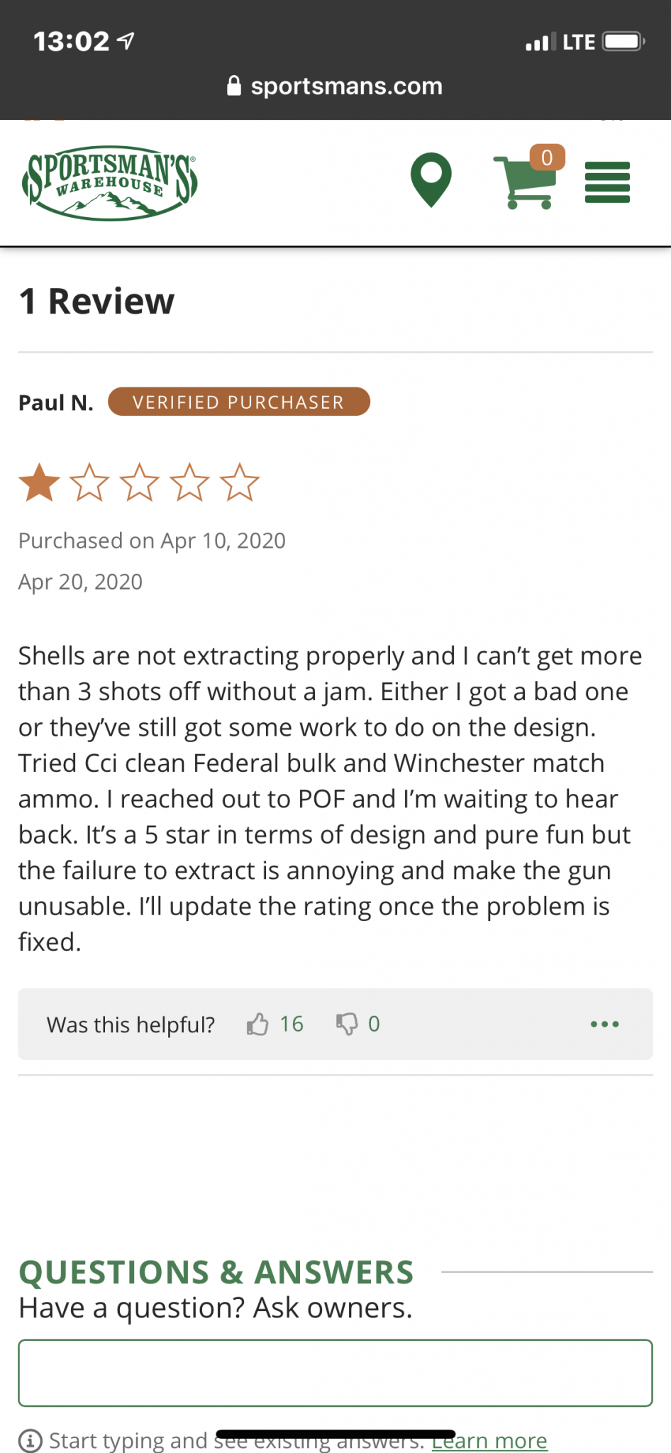

A local store has 1 review posted about it and the guy says it won’t cycle.
here’s a screen shot
I will be curious to see what the recommendations are from POF regarding ammo selection. I am still shocked how well my S&W MP22 runs considering I shoot it suppressed (SilencerCo Sparrow) and don’t really clean it. I will be all in for picking one up once a few reviews pop up.

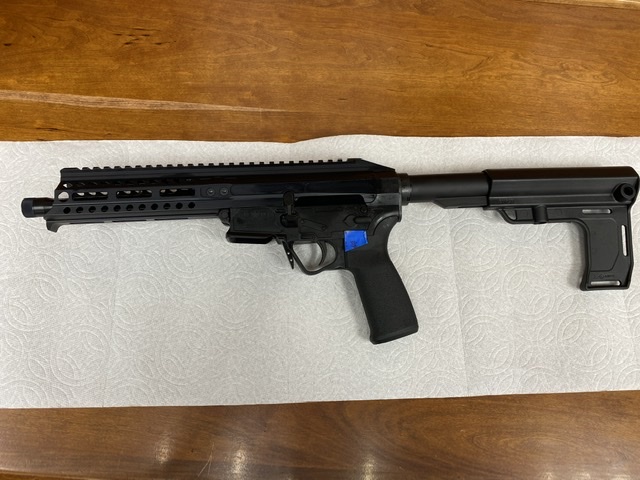

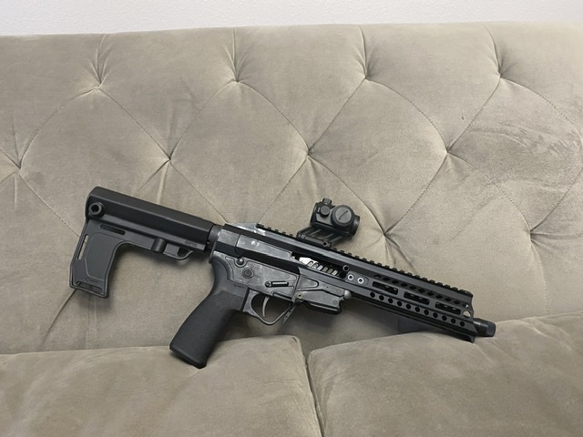

Some photos
Reactions: jeronimo

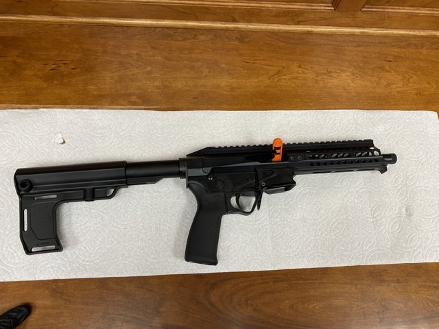

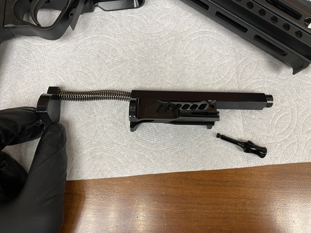

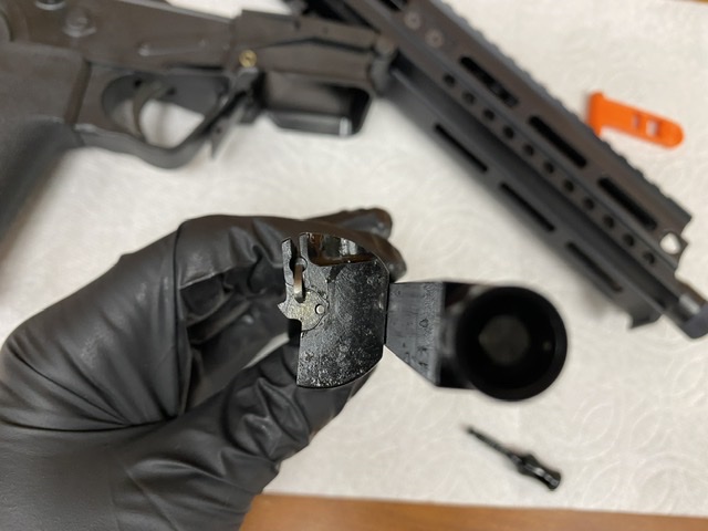

Some observations
1. there is a rubber bumper on the back of the bolt. Hopefully this makes it quieter and reduces wear and tear on it.
2 bolt handle is held in with a detent so you just pull and it will come out. Hopefully it stays in when bouncing around in the truck or 4 wheeler
3. No feed ramps into the chamber
4. Firing it with dry wall anchors shows the trigger is mil spec and needs to be replaced.
5. Handguard has a small bump up front like a grip stop that is pretty comfortable without being too large
6. Arm brace needs to be replaced with something that can be adjusted faster or figure out a thumbscrew for the set screw on the bottom.
I think a 1-4 or 1-6 will be put on it but I might drop a higher magnification scope to test out the accuracy for it.
so far I am impressed and excited. Hopefully it lives up to the expectations and hype.

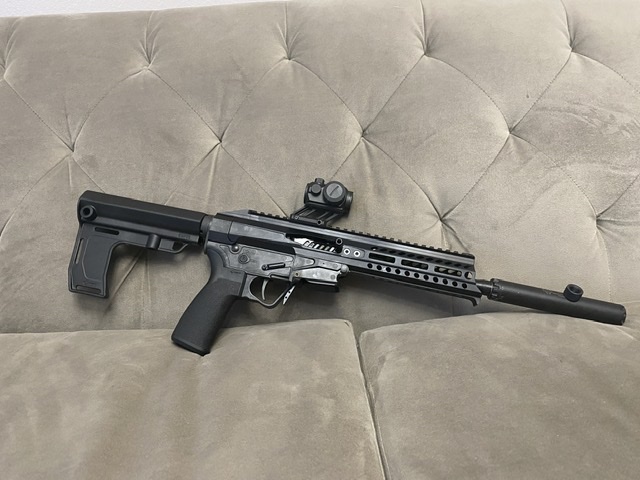

Heard back from POF....
You can dry fire it no problem.
Hopefully this weekend or Monday I will get it tested out. Eventually I will scope it for accuracy but the red dot was in the safe sitting so I threw it on there

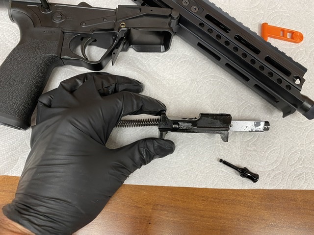

Last night I took it apart and wiped it down getting off a lot of the oil that was on it (note: the manual says to keep it lubed liberally).
Loaded up 5 rounds of Eley action in a newer 10 round mag. Shot it into the dirt and it worked perfectly.

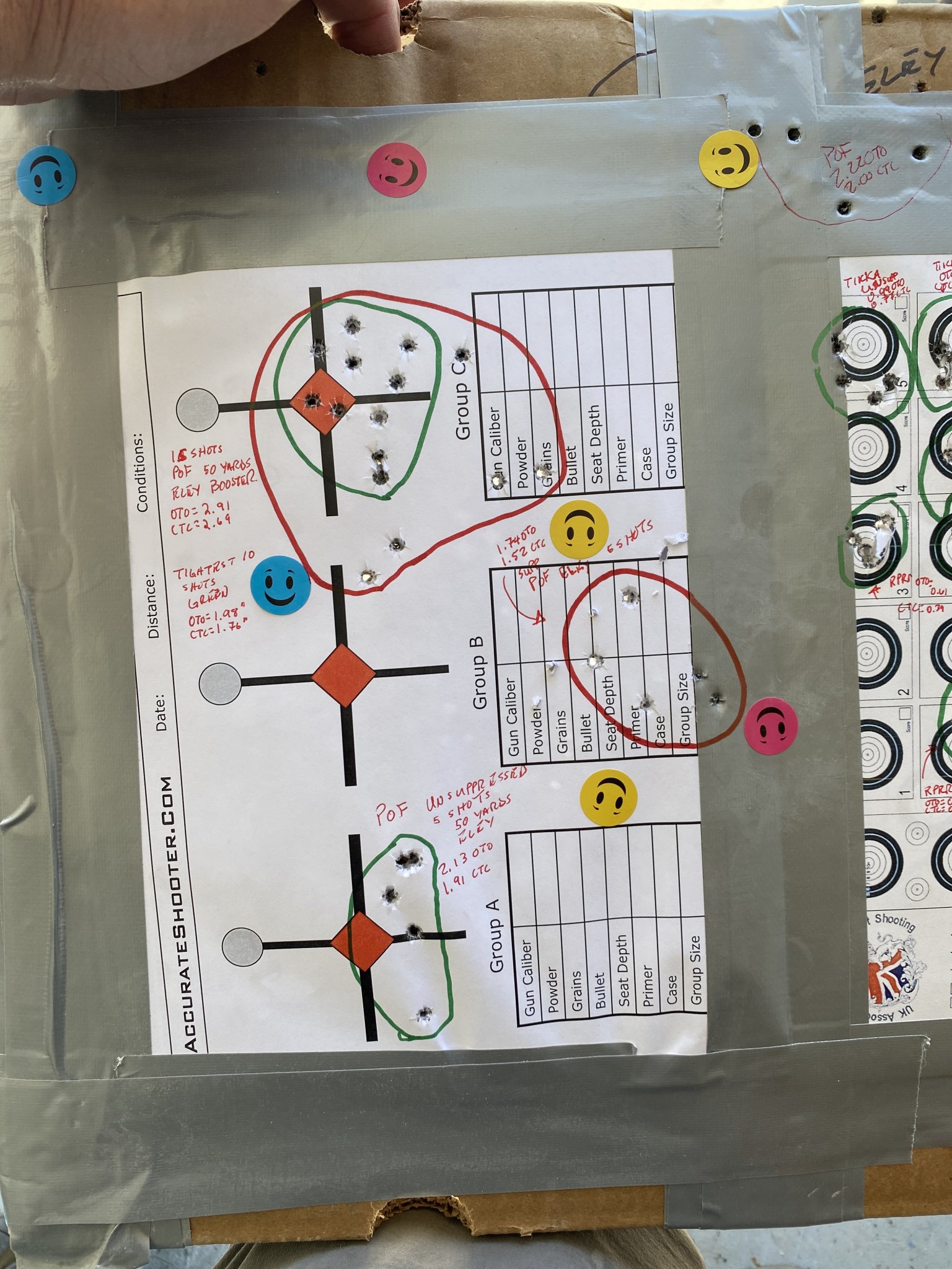

Ok.

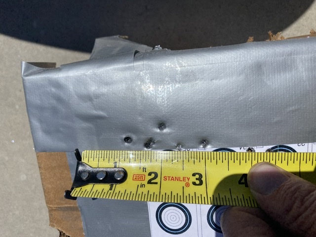

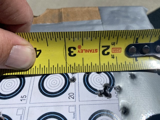

Went out this morning. 80-95* before I called it quits.

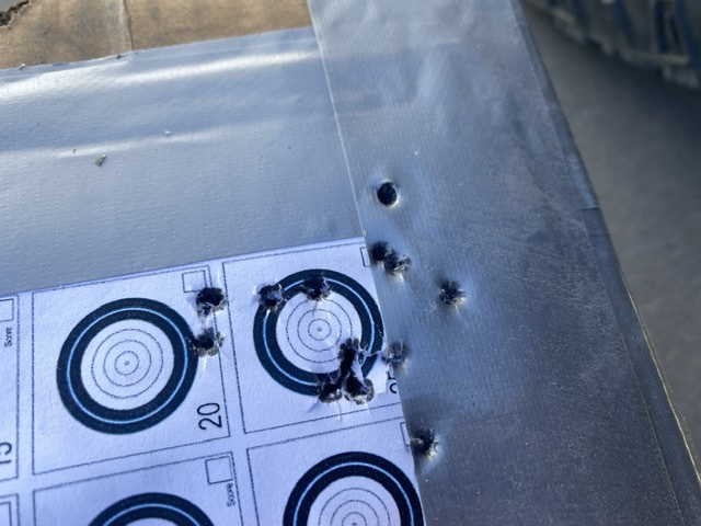

The good.
Suppressed or unsuppressed it cycled every different type of ammo I put in it.
The Bad-
brief moments of decent accuracy was ruined by fliers. Didn’t matter the ammo or magazine choice. Shot it all unsuppressed
pictures attached to show what I mean

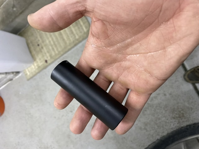

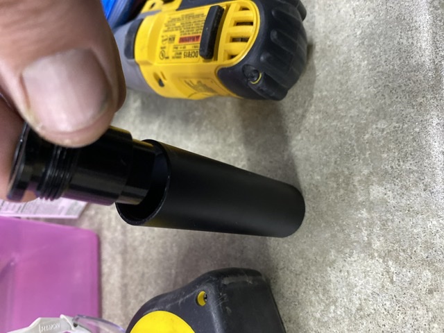

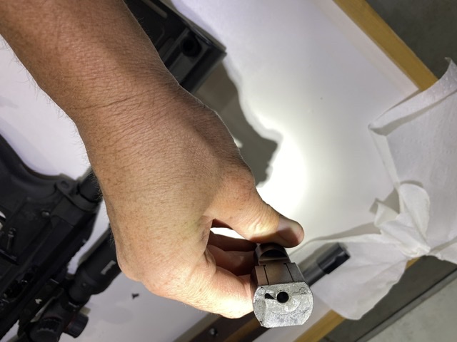

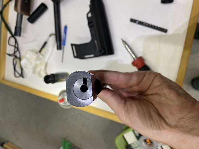

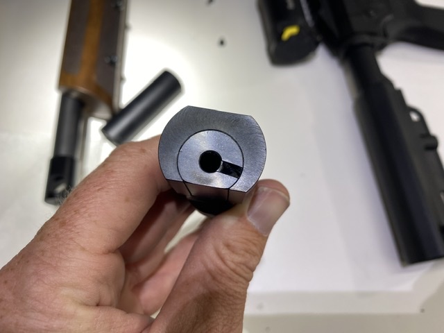

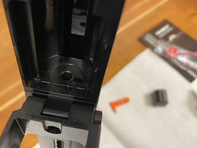

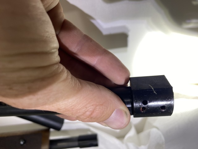

Might go test more ammo in the morning so I decided to pull the barrel and see how it’s attached.
You have 4 screws on the side of the receiver that hold the barrel and “Barrel shank Sleeve” as I will call it.
This sleeve has 4 screw holes for the receiver to hold it tight and then it has a drift pin that holds the barrel indexed properly
The barrel shank is about the same diameter as a CZ457 barrel (couldn’t find my calipers to measure) but has a flat spot on it as well as the shank is shorter on the POF.
If someone has some skill they could probably get a CZ or a 10/22 barrel machined to fit the barrel.
Any ways.
I scrubbed the chamber and cleaned the barrel.
One side note: Whatever nitride process they use makes cleaning the bolt super nice. I got most 95% of the gunk off the bolt with just a dry paper towel.
Pictures of course

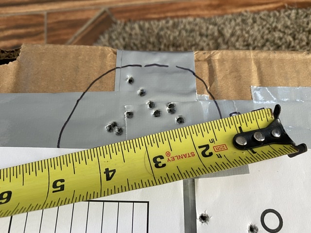

Took it out this morning.
Boringly reliable. Shot another 2-300 rounds and had 0 issues
Groups seem to be a little better today.
Maybe the deep cleaning helped it or maybe more rounds down the barrel are helping
Here’s the best group do the day from the POF

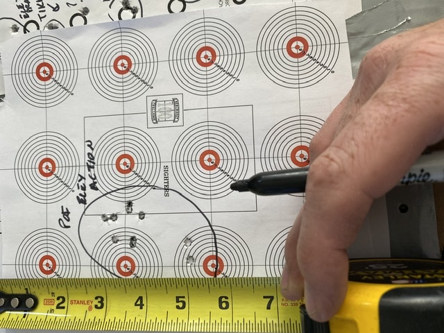

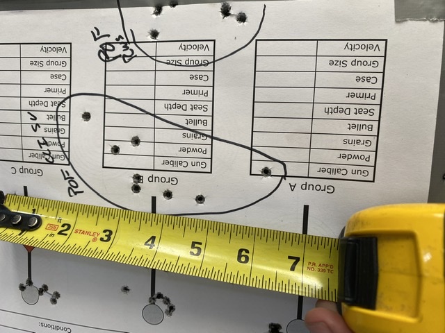

need a sense of scale to determine if poor or ok. may i ask what is the dia. of that circle.
I'm taking a look at one of these... sounds like the reliability and accuracy may not make it appropriate for true home defense... but for training purposes, would you recommend this gun?
Will grab it when I get home.
Accuracy sucks compared to my Tikka T1x, Cz 455 or 457, kidd barreled 10/22, etc....
I am guessing the best new group was just under 2” at 50 yards for 10-15 rounds (forgot which mag it was) and it was shooting Eley Action ammo (my decent priced mid grade ammo).
Before I was lucky to get it below 3” so getting to 2” or better gives me hope.
Ideally I would have loved 1” @ 50 for 5 shots but that still is proving impossible. But if the barrel gets better with time we will see.
I wouldn’t use it for a home defense unless it was against a bunch of squirrels eating your birdseed.
Mine has been super reliable since the first outing (with or without a suppressor or booster)
Accuracy has been an issue at 50 yards imho.
Here is a tape with the best group from the POF today
Spoke with POF about the reliability issues... Butler Creek Steel lips apparently work well. I’ll try the BX 25 too
I spoke with POF about jams... they fou

I was worried about it after reading the 2 reviews on sportsman’s warehouse website.
My first outing went horrible but I had it really lubed up. I wiped it down and it’s ran like a champ since. No issues with ammo or magazines.
It must be a common problem because they sent me a booster for the end. I have shot it with a suppressor, without a suppressor and with a booster and it all works the same (although I probably have over 1,000 rounds through it though).
How’s that stock? Looks pretty shitty from what I can see. Seems more comfortable to use it off the shoulder than on.
Have you shot some groups after cleaning the gun?
I did. Best group was just under 2” outside to outside at 50 yards.... don’t remember if it was 5 rounds or 10 rounds on that group.
Hoping to get up on Saturday and beat the heat and other shooters.
That was prone off of sandbags.
I will post some more pics if I go on Saturday.
More groups.
shot 200-300 more rounds and only had one weird jam where the shell from the last round got stuck and held the bolt back
I swear I’m the only one with one.
going tomorrow I think again.
Cycles perfect.
accuracy is still minute of pop can at 50 yards
I bought one. Came into my FFL today. Took it out of the box, shot 100 rounds of Stinger ammunition out of it. Shot it slow, shot it fast, it functioned flawlessly.. Seems very well made.
