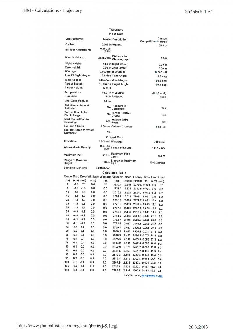

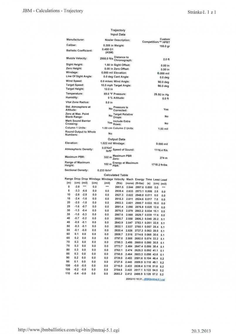

Now it sounds more complicated than I first thought for myself; honestly, I´ll shoot the two loads Saturday and I´ll see what they do and how they correlate to each other, but now I´m simply curious and want to better understand this part of ballistics; could prove useful in the future, who knows. I ran the two exact loads through JBM and enclose here the results. It is apparent the 2950 trajectory is flatter to 100m, but only by 1mm at the highest point. Faster bullet also crosses the line of sight for the first time cca 10m later. The calculation would almost say the difference is there, but probably will not be actually measurable in this case?

View attachment 2890View attachment 2891 I´m simply curious and want to better understand this part of ballistics; could prove useful in the future, who knows. I ran the two exact loads through JBM and enclose here the results. It is apparent the 2950 trajectory is flatter to 100m, but only by 1mm at the highest point. Faster bullet also crosses the line of sight for the first time cca 10m later. The calculation would almost say the difference is there, but probably will not be actually measurable in this case?

[MENTION=66602]waste_knot[/MENTION]: did just that, thanks for the suggestion. Now JBM simmulates a bullet fired horizontally; slower bullet drops 6,9cm to 100m, faster bullet drops 6,4cm to 100m. That equals 0.05mils difference between the two. I now believe that if any larger difference is observed between the loads, then it´s caused more by barrel harmonics and how the bullet exits the muzzle than by the external ballistics of the 100m flight.
