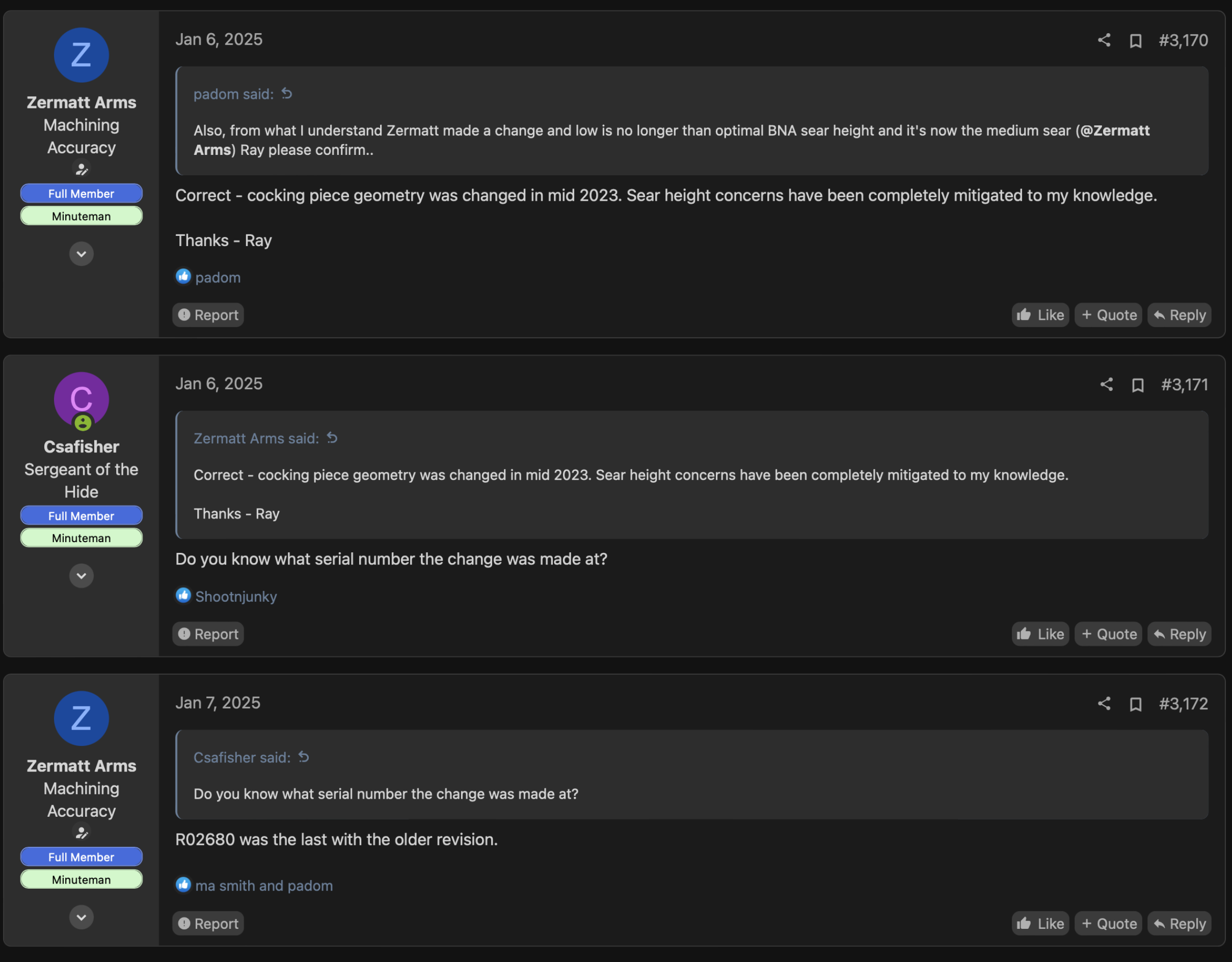

Well it looks like I’m ordering one lol. How is the sear height on a rim X?
I recommend to call bullet central if your going to order. They will setup the Bix n Andy sear height for the action and have been shipping 1-2 buisness days lately
I believe you'll need a low sear
Reactions: Jagerwerks

I have a Bix 'n' Andy 2 Stage Tac Sport Pro X and really enjoy it after running a light single stage (which I also like).
I took a screen shot of this after getting the low sear on my Bix 'n' Andy, which runs perfectly.
Reactions: oldrifleman
I had to comment because I am serial number R02681 :ROFLMAO:
Looks like I don't have to be concerned about sear height after all
