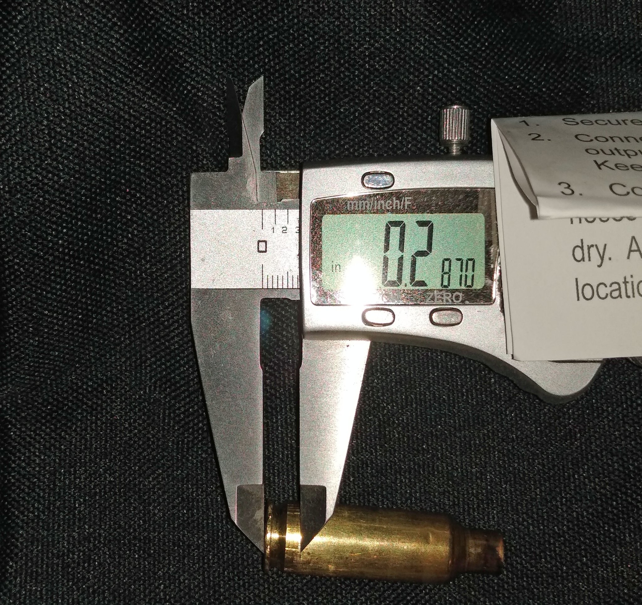

The shoulder of your cases is NOT bumped back enough . Factory specs don't mean shit , especially in a semi auto . I bump ALL My cartridges shoulders back for full auto or semi 0.004" MINIMUM UNDER chamber measurement . Accuracy is Just fine BR guns want 0.001" but Semi auto's aren't BR guns normally .
The Comparator is 100% essential tool for reloading accurately . You can also use your chamber but comparator is easier method .
Setting up a Die isn't full proof , NOR is FL re sizing just once in MANY instances .
Case in Point : I do a hell of a lot of reloading and have been at it #58 years . Some time back a Buddy with Military connections gave Me 750-K ,7.62X51 cases . I knew they came off a chopper door slinger and it required ME resizing #3-4 times while turning the case in the plate aka shell holder 90 degrees each stroke . Before they would drop into a case gauge . MY take was that M134 or M 60 D had worn chamber or heated to excessive expansion and thus case specs were off the chart . Normally I wouldn't have fooled with them but they were LC cases and WORTH the effort .
IF You don't have a case Gauge I suggest getting one ,it instantly shows you WHERE problems are including chewed rims . Sometimes the extractor can tear or distort a rim and one plays hell getting it to chamber . Case gauge drop in it goes so shall YOUR chamber .
Reactions: USAF Ret
One can most certainly use a small base sizing Die but it's not necessary . The Last 0.2870" from the base up give or take a few 0.0001's NEVER resizes NO matter how one adjusts their Dies. Decades back I ask several major manufacturers why their area encompassed by My calipers were so small in relation to actual chamber dimensions . Only 3 bothered answering .
F.N. Belgium , Norma and Lapua . NATO specs are made smaller ,as Ammo MUST fit chambers regardless of Country addressed .
Generally speaking from what I've measured 0.004-06 smaller Diameter in the caliper zone photo .
I was also informed Ammunition manufacturers use special DIes which are noticeably SMALLER dimension .
The very Best Dies one can purchase WON'T size back to Ammunition factory Die specs .
