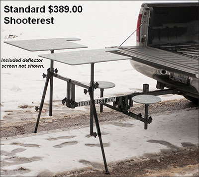

Anyone have a commercial or other portable bench for shooting. Something that can be easily transported, quickly assembled and dissembled, etc. yet somewhat steady. Drive my truck and set up at 50 yard increments out to 600 yards. Prone is not conducive at the location. I have used hog saddle / prst tripod, harris seated bipod, Caldwell Magnum field pod, etc. but would really like a chair table set up and those I have seen so far seem flimsy.
I was going to suggest this but it appears the website is gone. Maybe they r out of business.

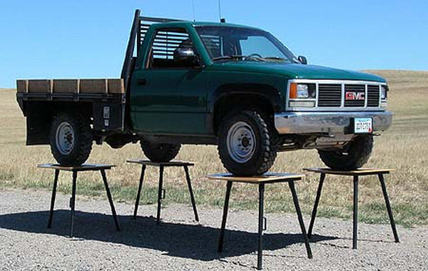

I've been using one of these:
Legacy Shooting Bench
Quality product, and a bit cheaper than some of the other benches I was looking at.
I'm often helping others learning to shoot, or sighting in a new rifle etc... And have had to help several that due to physical limitations are unable to shoot prone, and I wouldn't trust them to shoot from a tripod. I can't afford rounds missing the berm. The bench has proved helpful. Good investment.
