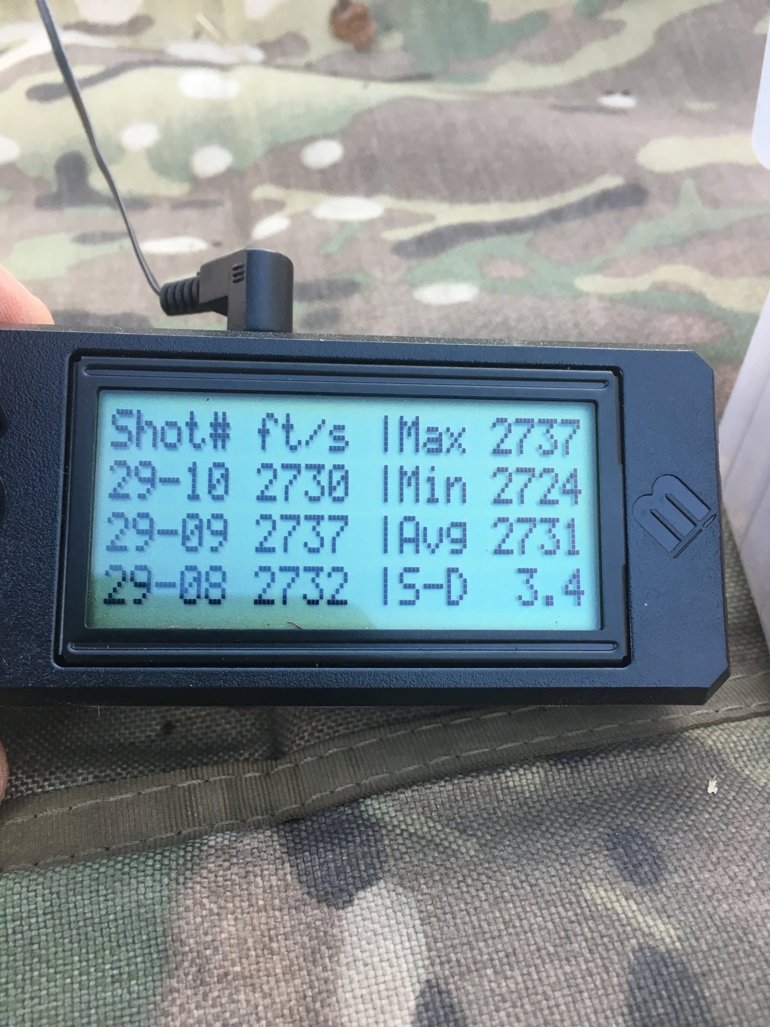

You need to decide how much $$ you want to spend. For the money the charge master with an insert works really well. I used to be anal about my loads but for most of use we are banging steel not benchrest shooters so you need to decide what your goals are. Heres a chronograph of 10 rounds thrown with the chargemaster. I can’t complain.
Reactions: lash
