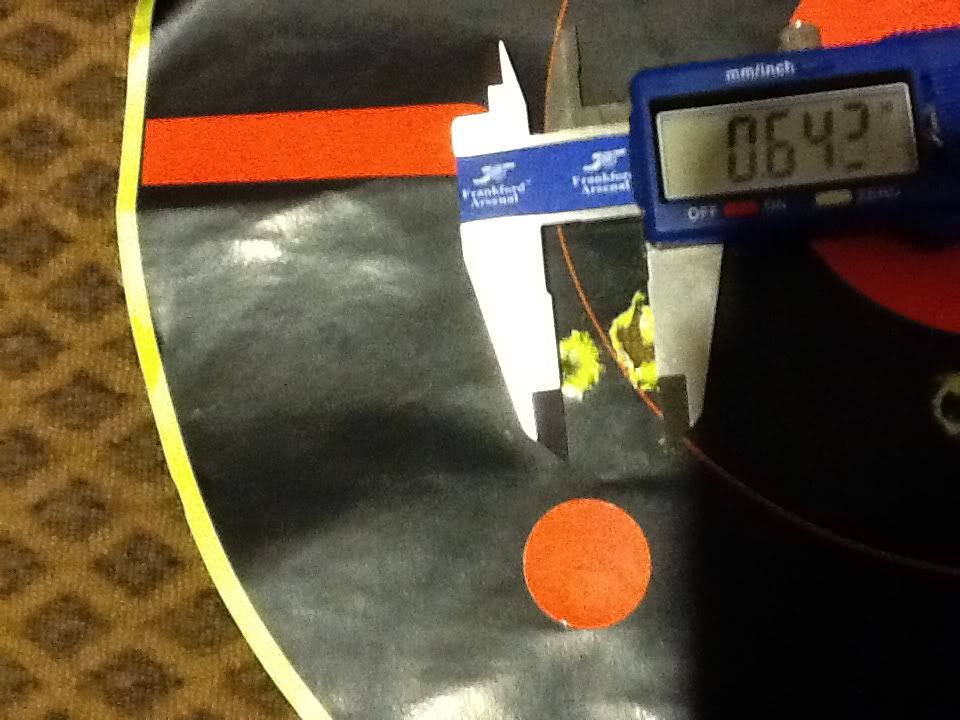

43.5 grains of Varget was the ticket. .642" outside .358" center to center. Only had 3 fps E.S. between the 3 shots. Same point of impact as factory loads running 2795 fps. The h4350 loads that his uncle had loaded at 47 grains (1 grain under book max) were running 2577. So undoubtedly 4350 is too slow for a 20" tube. The barrel was contacting the stock in one place so I sanded it down before shooting, gun is not bedded.
Re: 'Powder for 7mm-08?
I think I'm done with this one. I shot a sub .5" group at 120 yards out of an unbeded 15 year old hunting rifle. Was shooting off a wadded up jacket for a front rest and sand bag rear rest off of a wooden wire spool for a table at duck camp.
