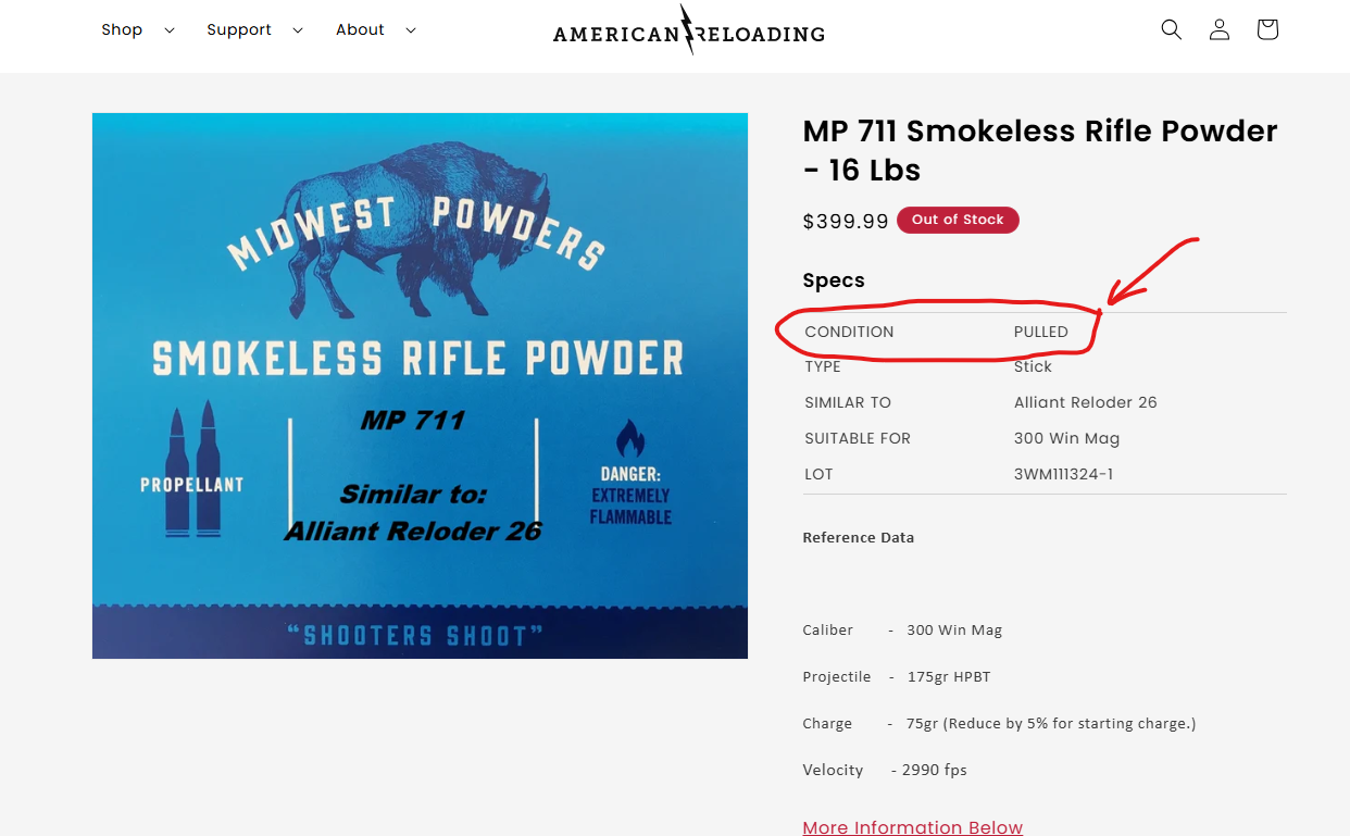

I think there is a typo on the web page, MP 580 is similar to IMR 4451 not H4350 . I have some MP580 from a while ago and its like
IMR 4451.
From the same page that shows H4350 on the label.
Specs
SKU IMR 4451
CONDITION PULLED
TYPE Stick
SIMILAR TO Hodgdon H4350
SUITABLE FOR 6.5 Creedmoor
LOT 65021925-4

wait a minute - does this mean that "Midwest Powders" are all pulled powders, adn that the "similar to" indicates what they actually are?
Sorry, I've been living under a rock for 3 years.
I saw that, but is this "THE" RL26 being discussed? You know it's RL26 because it says "similar to RL 26"?
I asked them once upon a time long ago... why they didn't just call their pull-down materials by their original names.
It went down a legal rabbit hole, but the short version is they are protecting themselves from a legal view point where they are not allowed to use the original commercial names for pull-down even if they know for certain what it is.
There are some instances where they get material from ammo that they really aren't guaranteed the traceability, but then they take on the burden of telling users what to expect, again without being able to claim it or name it directly.
Just another example of silly human behavior and too many unethical people and lawyers in the world... Caveat Emptor
Midwest Powders are great. I have used dozens of kegs at this point and all have been flawless.
As stated above, they can’t call the powders by their original names for liability reasons but they are nicely labeled and are absolutely up to snuff.
You may not get exactly the same results as other loads due to the potential for pull downs to contain mixed lots, but it should be consistent enough for you to develop separate but similar load data using it.
