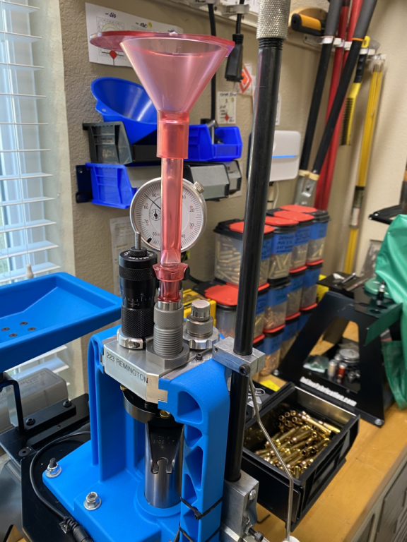

Me too, that's why I do all case prep work on a rockchucker and use the Dillon 550c strictly for loading. I use all 4 stations & it has significantly sped the process up - compared to the rockchucker.
  1. Expand & prime
  2. Pour. From Autotrickler setup. The charge is ready by the time I'm done seating & advancing. Extended tube helps with compressed 223 loads.
  3. Seat
  4. Measure
What I like about the 550 is easily backing up & reseating if it's a tad long.
