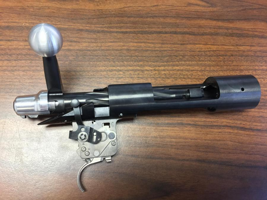

I have one of the "buleprinted" ptg rem actions that was fitted with a ptg bolt that went on sale at 400 bucks awhile back. For 400 I think it is great: it got me one piece bolt that doesnt have the factory primary extraction issues with a mini m16 extractor for the price of a donor factory rifle that gets stripped down for the action. So I cant complain there. Still needs to ditch the trigger and it doesnt have a side bolt release so I cant use a triggertech diamond that Im lusting after.

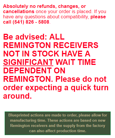

But I wouldnt have spent 700 on it. Not to mention that they have disclaimers on their website saying that they might not even actually have the actions and are waiting on remington. I sure wouldnt order one straight from ptg right now, you may never see it and have to pay a restocking fee to boot for the opportunity to be disappointed. Actually, looking at them now they say zero refunds.
