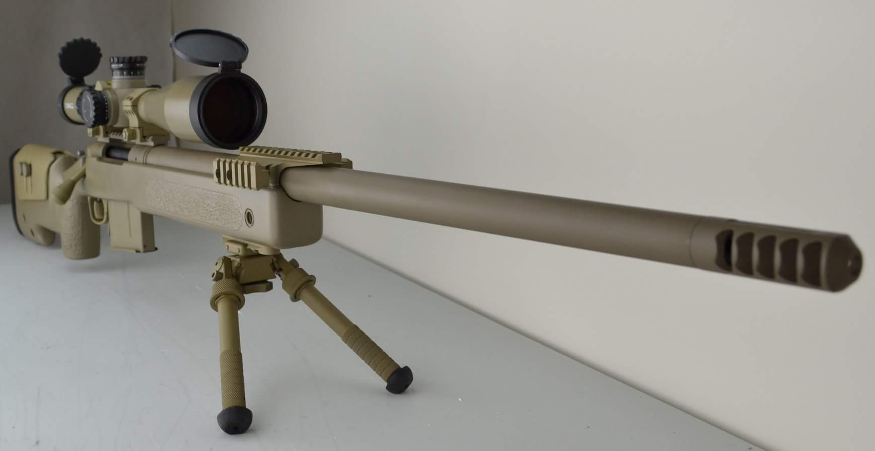

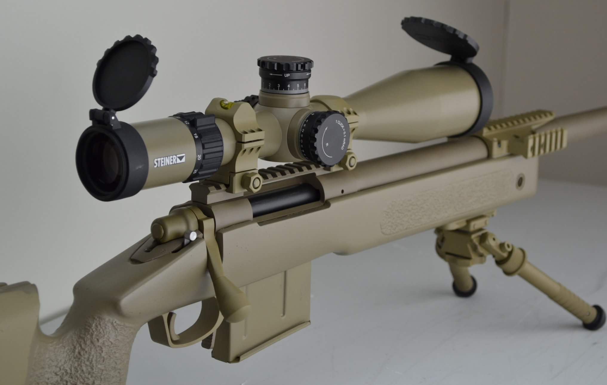

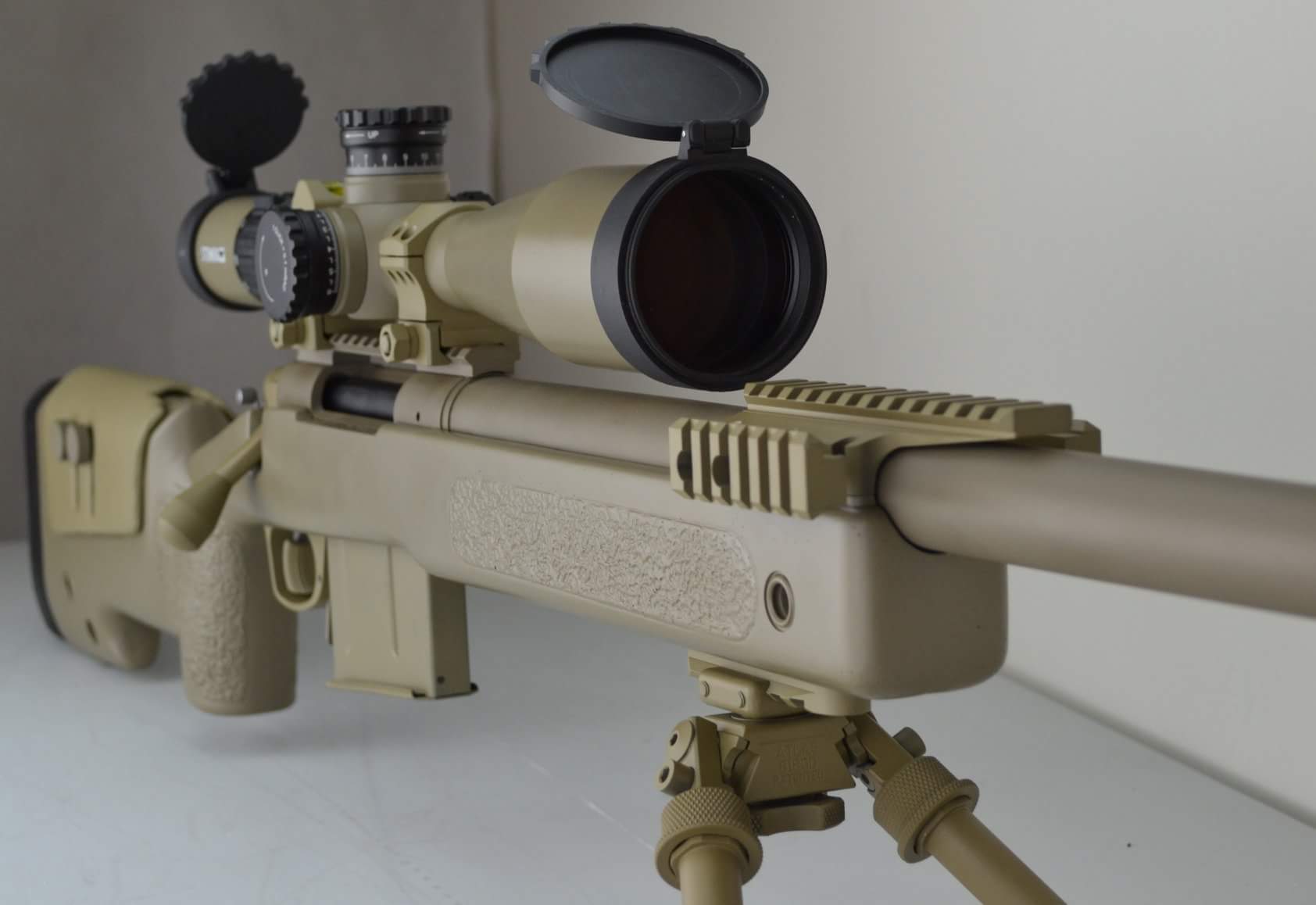

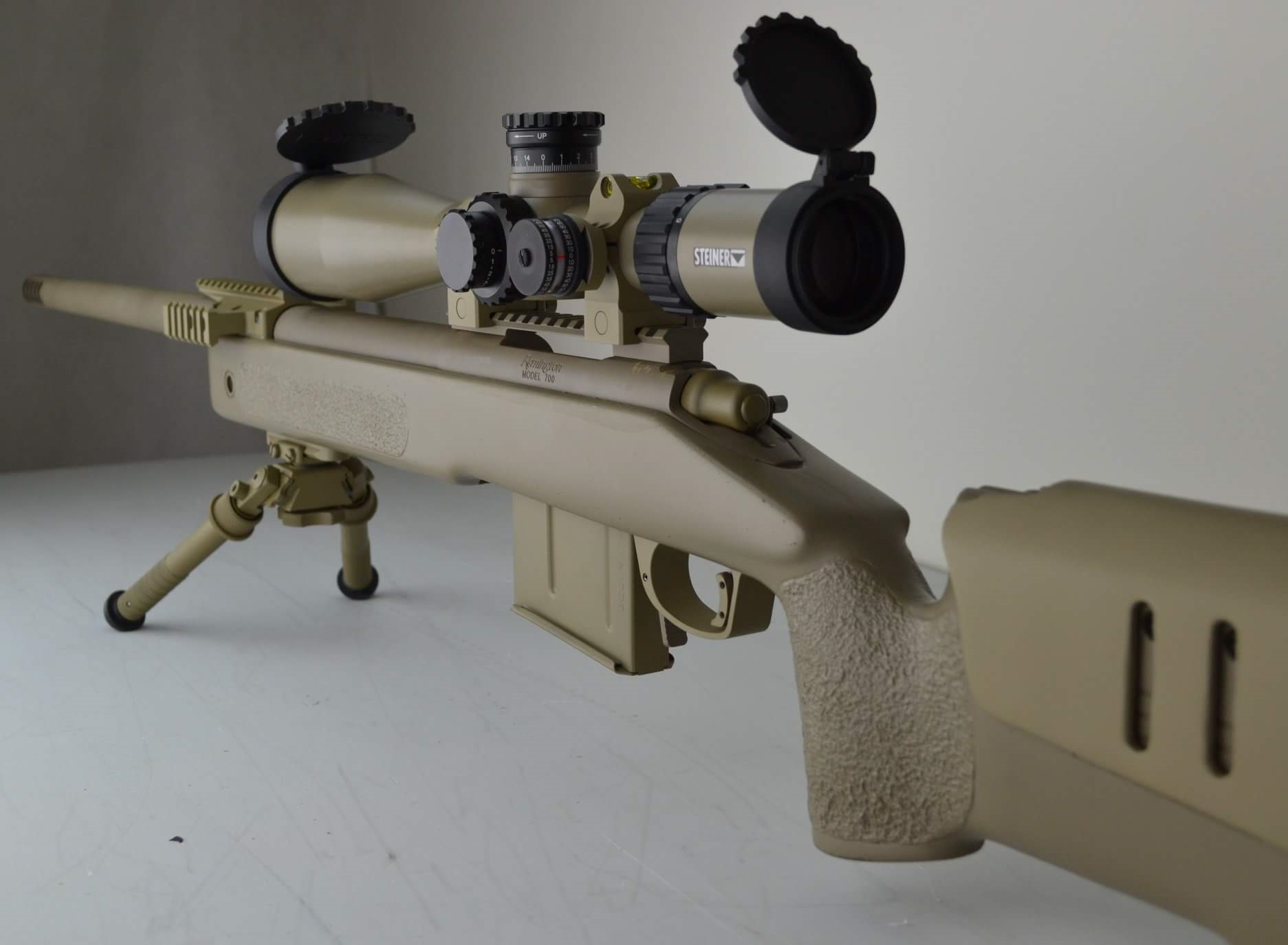

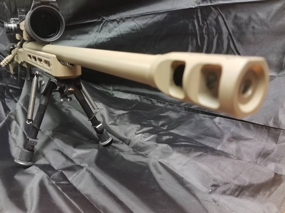

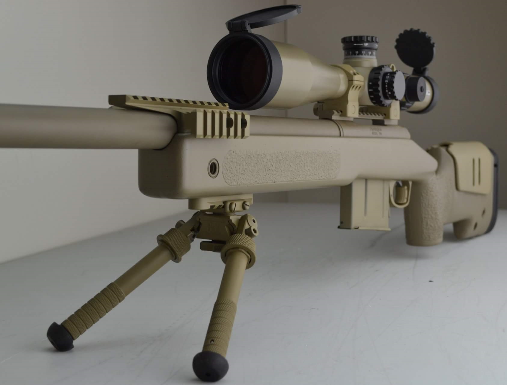

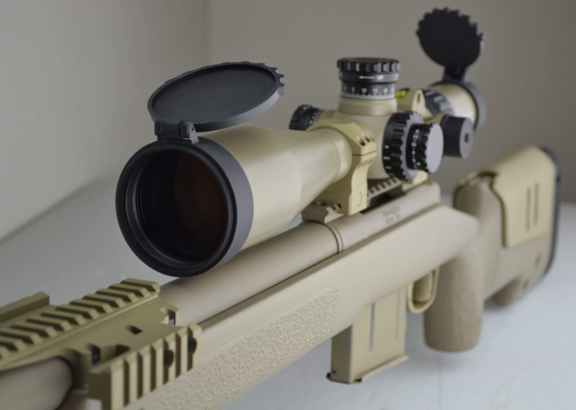

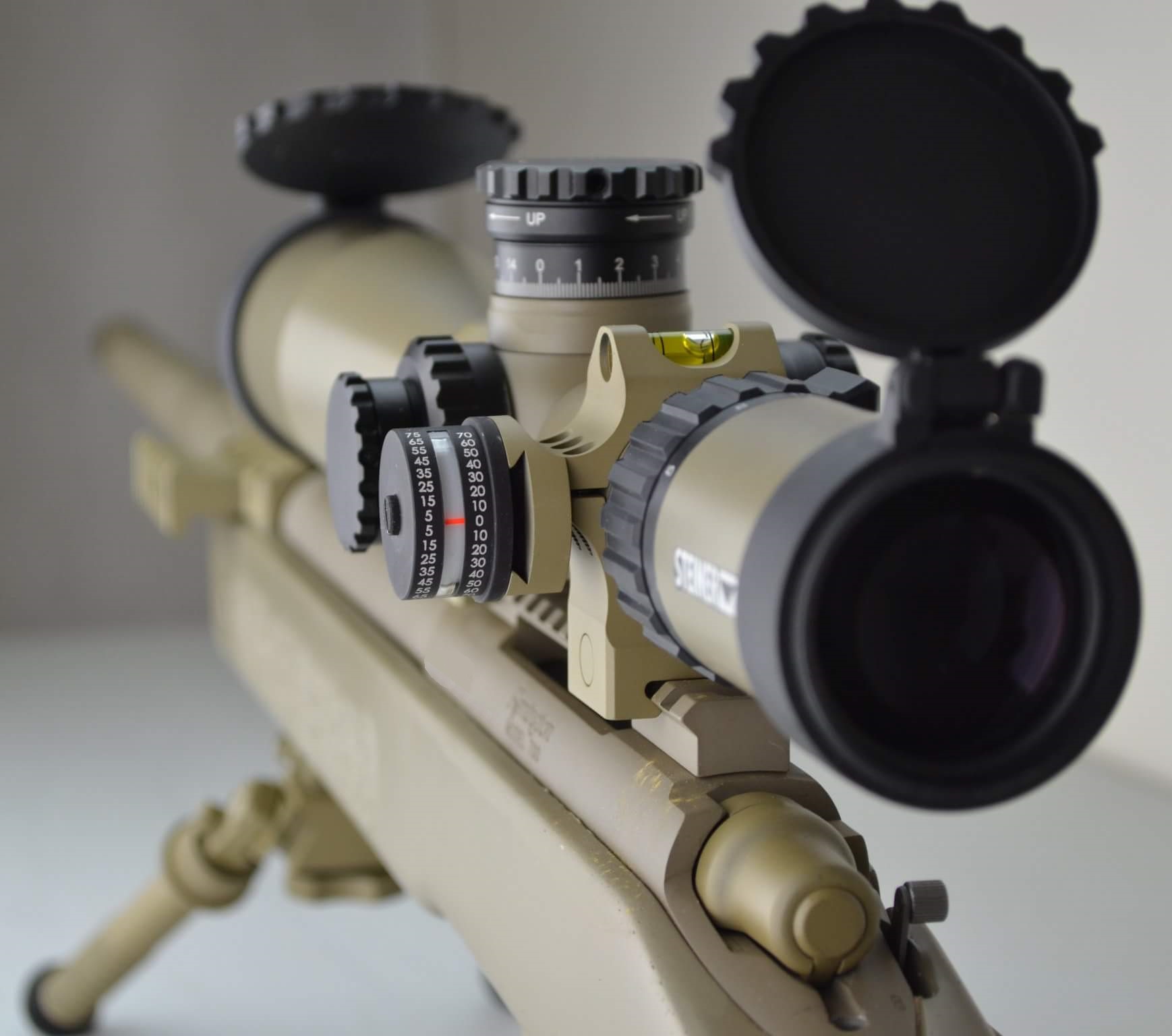

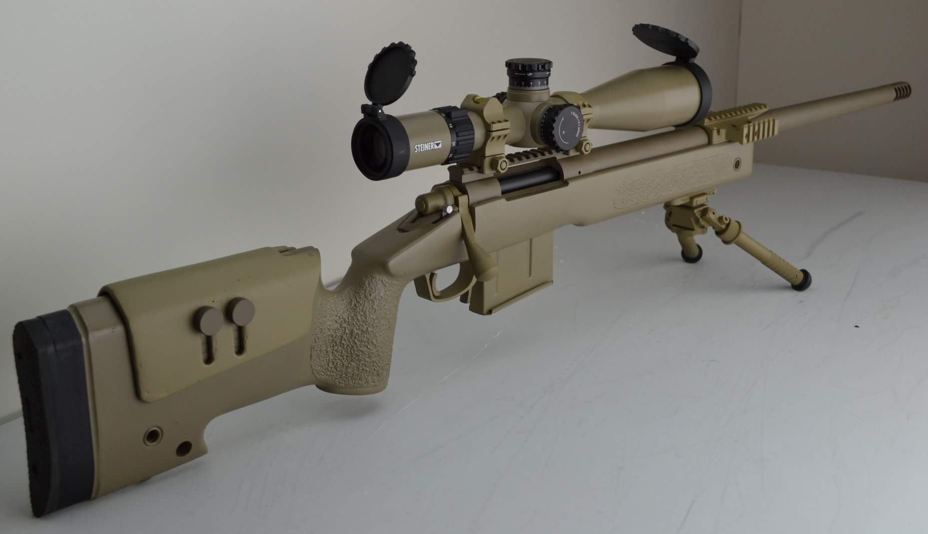

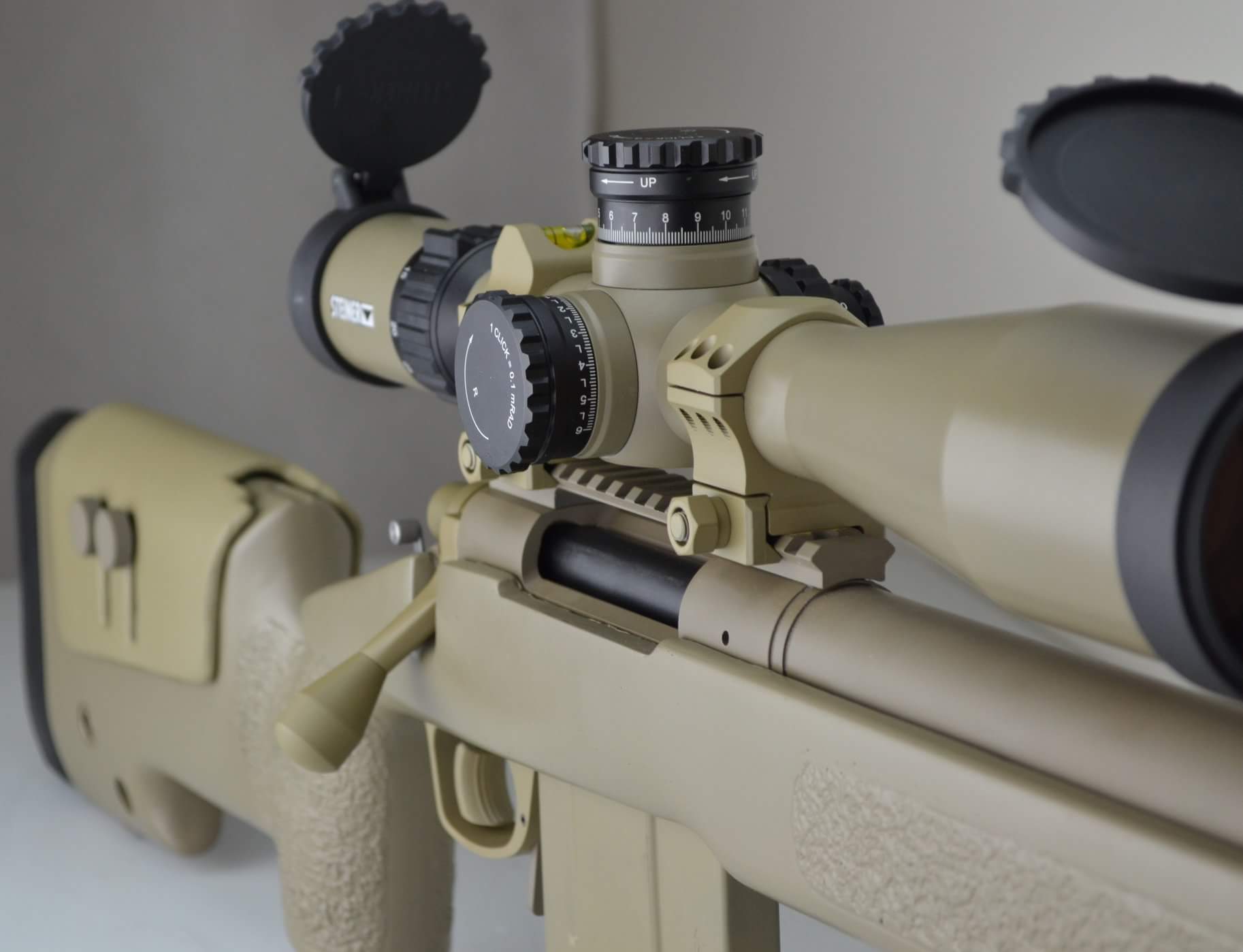

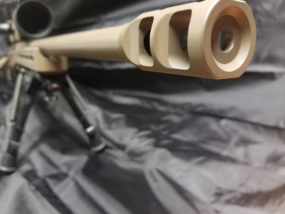

Rem700 A-4 Custom Build (300 Win Mag)
Parts List:
  • Rem 700 5R Stainless Action
  • Krieger Precision 26" Barrel (1:10" Twist)
  • Terminator T3 Muzzle Brake
  • McMillan A-4 Stock
  • Steiner M5XI 5-25 (MSR Reticle)
  • Nightforce UltraLight 6-Screw High Rings w/ Angle Degree Indicator and Bubble Level
  • Badger Ordnance Bottom Metal w/ AccurateMag 5 Round Magazines
  • Jewel HVR Trigger w/ Finger pad
  • Leupold Steel 20MOA Rail
  • Badger Ordnance EFR (Extended Front Rail)
  • Atlas BT-10 Bipod
Custom Enhancements:
  • Tapered Barrel to fit through Badger Ordnance EFR (Precision / Bull Barrels won't fit into the diameter of the EFR)
  • In-letting for Badger EFR Installation
  • Full Cerakoting (Coyote Tan and Flat Dark Earth)
  • Truing of the Action and Bolt Face
  • Microslik Coating to Bolt body and Interior of Action
  • Removal of Black Rubber coating and application of Custom Fibre Glass Coating to Metal Cheek rest. (to eliminate Sun's Heat Burn on your face
  • Glass Bedding of Action to Stock
  • Metal Cylinder sleeve lathed and fitted to hole next to flush cup of the Stock for 2 Point anchoring whilst using a tripod.
Recommendations:
Get an amazing Gunsmith and send them tons of Love!
They Deserve it!

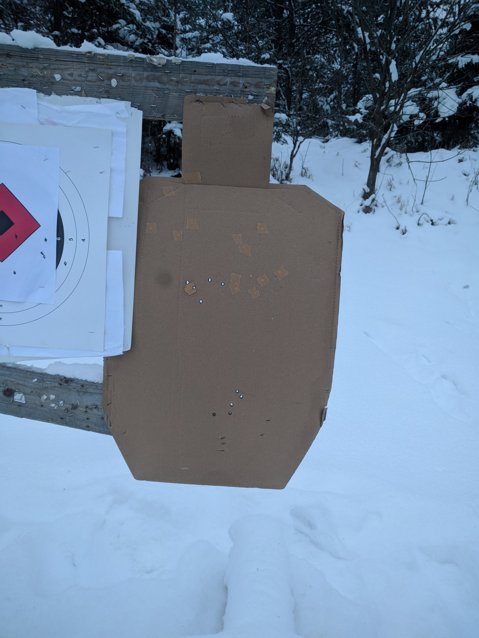

Tikka T3 CTR 20" .308 Win. KRG X-Ray chassis with spigot mount and Harris bipod, Skd-tac BALS bag attached with custom webbing. I also added rubber mat underneath the cheek piece to prevent snagging. Steiner Military M5Xi 5-25x56 with MSR reticle, mounted with Spuhr SP-4902. Suppressor Ase utra SL5 and Vtac wide sling.
Two separate 5 shot groups to 500 meters. Shoots great!

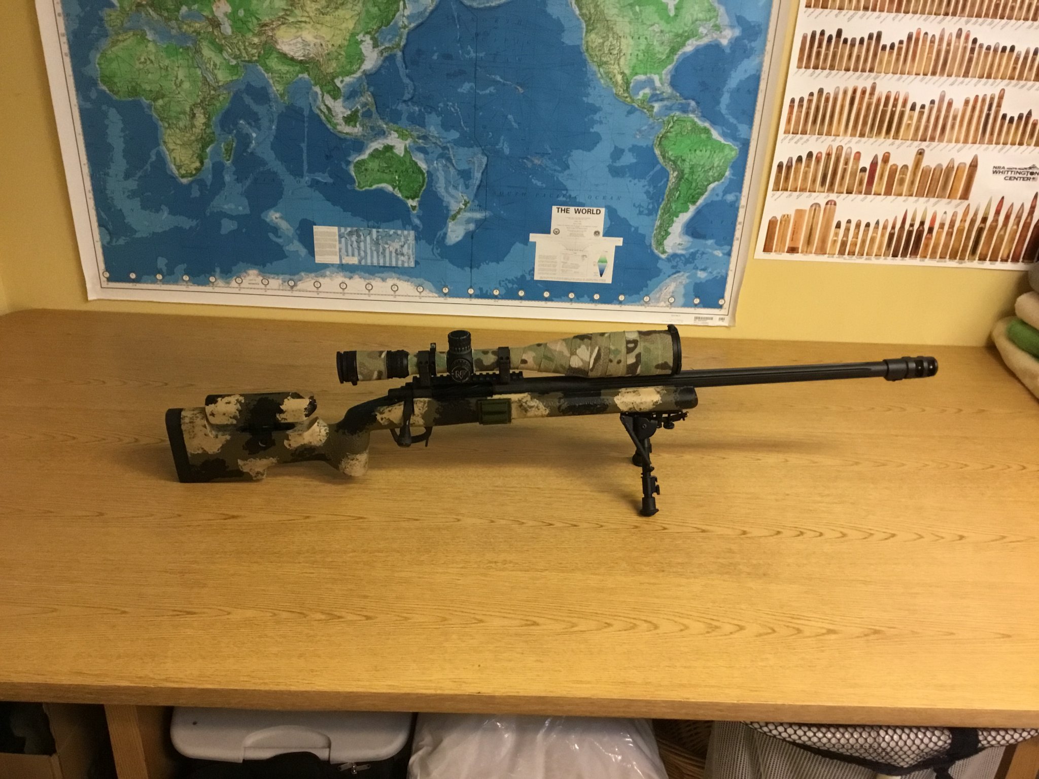

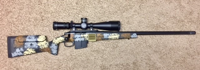

Built by American Precision Arms

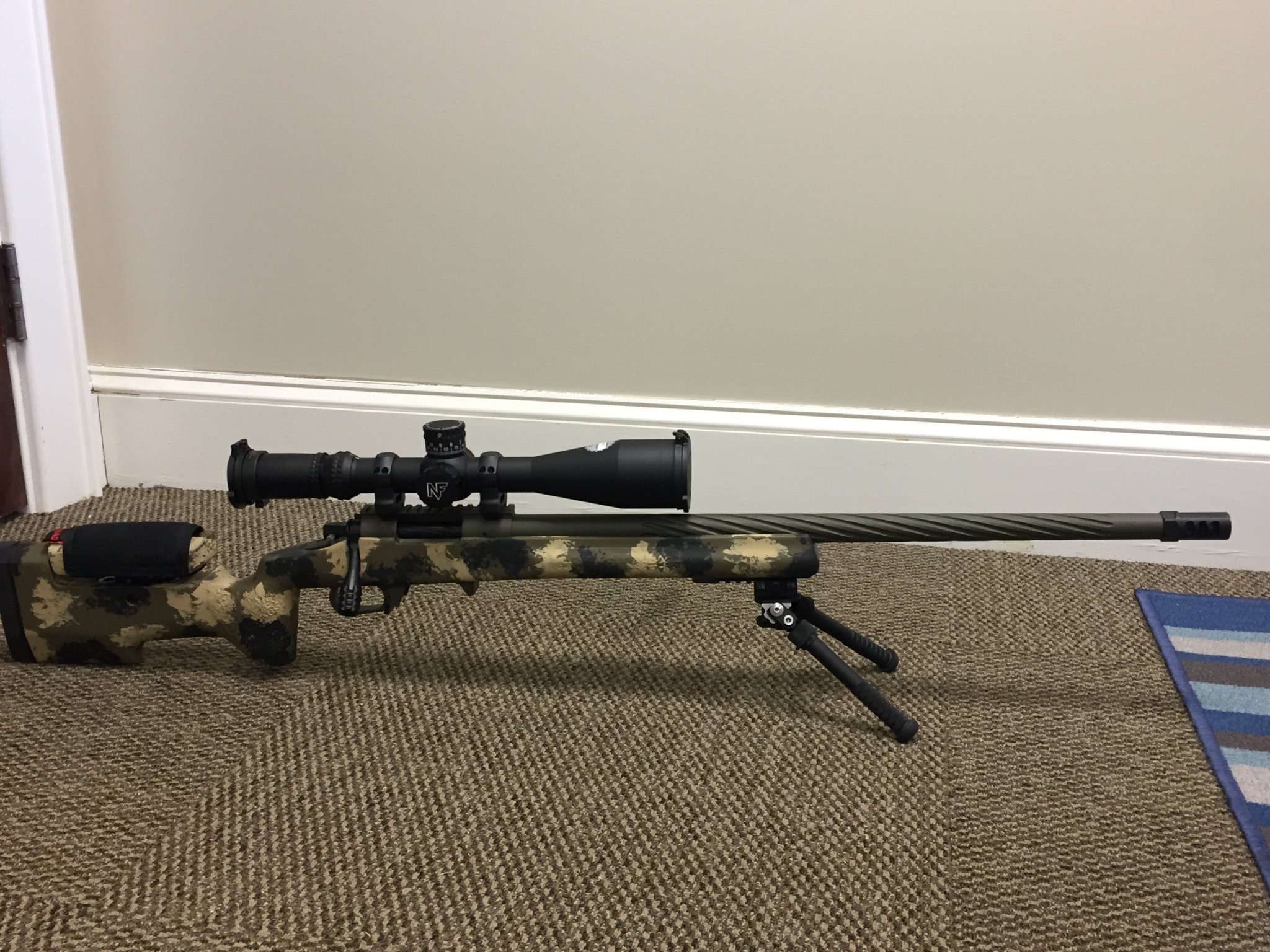

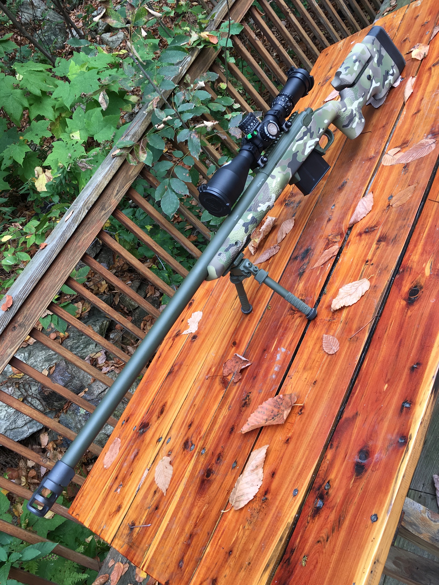

GA Precision Tempest Chambered in 6.5x47 Lapua
Manners PRS2 W/ Gen 2 Mini Chassis (AW Mags) Badlands Camo
Bartlein 26" Medium Palma 1:8’ Twist
APA Little Bastard Brake
Timney Calvin Elite Trigger (24oz)
Nightforce ATACR 5-25x56mm F1 MOAR Reticle
Nightforce UltraLite Medium Rings
Accuracy First Scope level

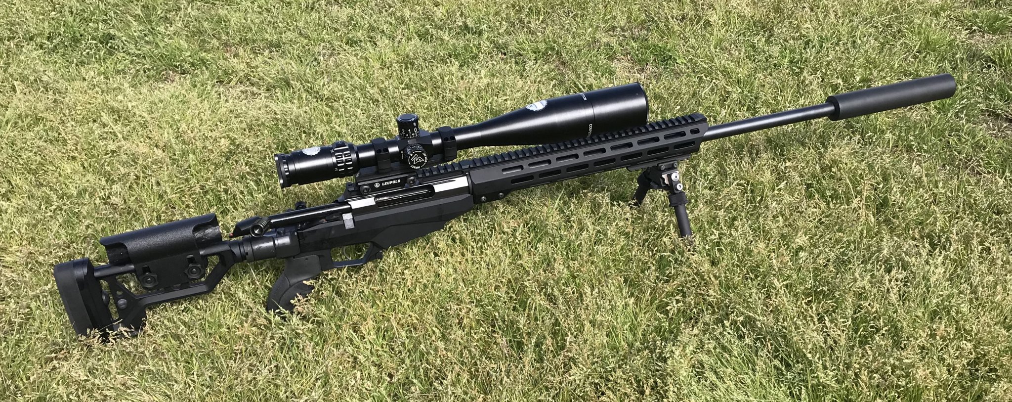

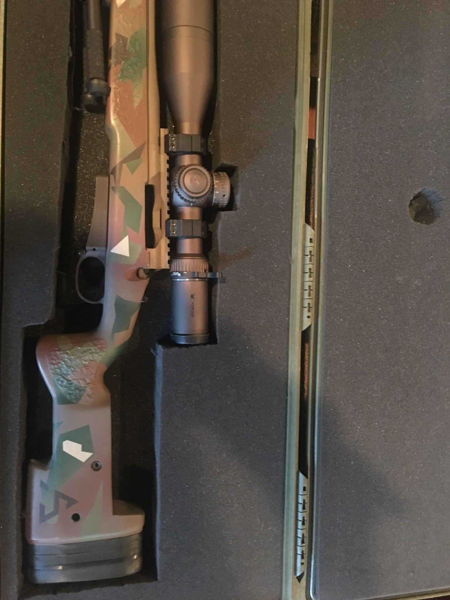

Just picked up my first precision rifle this past weekend.
6.5 Creedmoor
Surgeon 591
24" Hardy CF Barrel w/ Insite Heathen Brake
Manners T5A Elite carbon shell
Surgeon Bottom Metal
Vortex Razor AMG
All put together by Harley Greene of Insite arms in Lloydminster, Alberta.

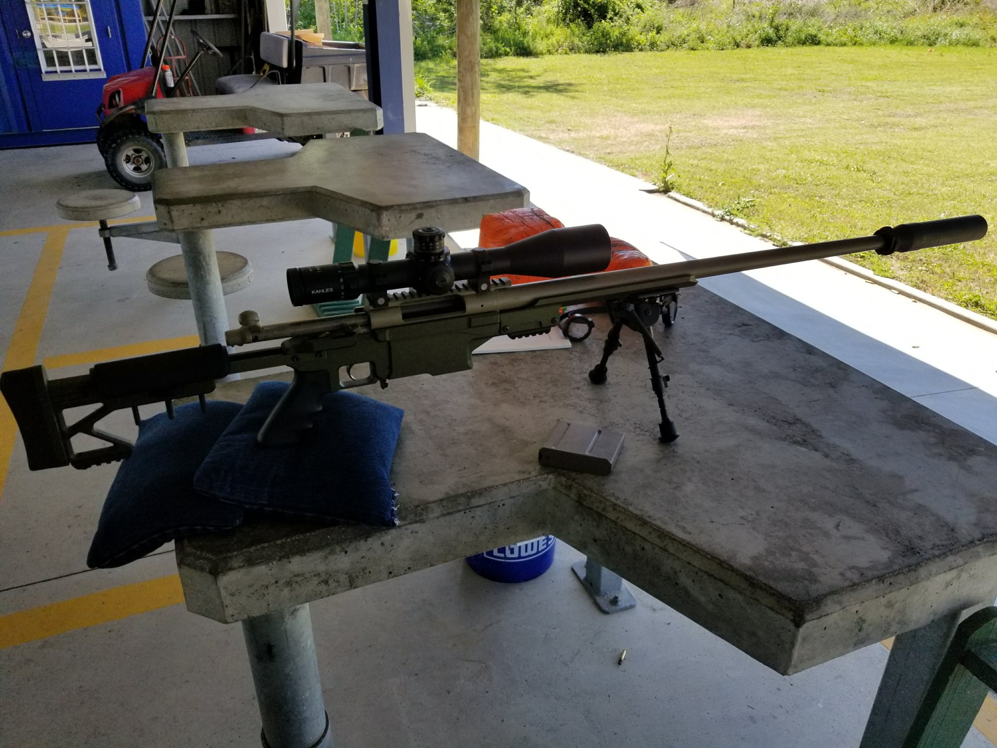

Savage LRP 6.5CM
Vortex PST Gen1
Curtis Custom Axiom switch lug 6X47L
1:7 twist Spencer
MPA Comp Chassis
K624i SKMR3

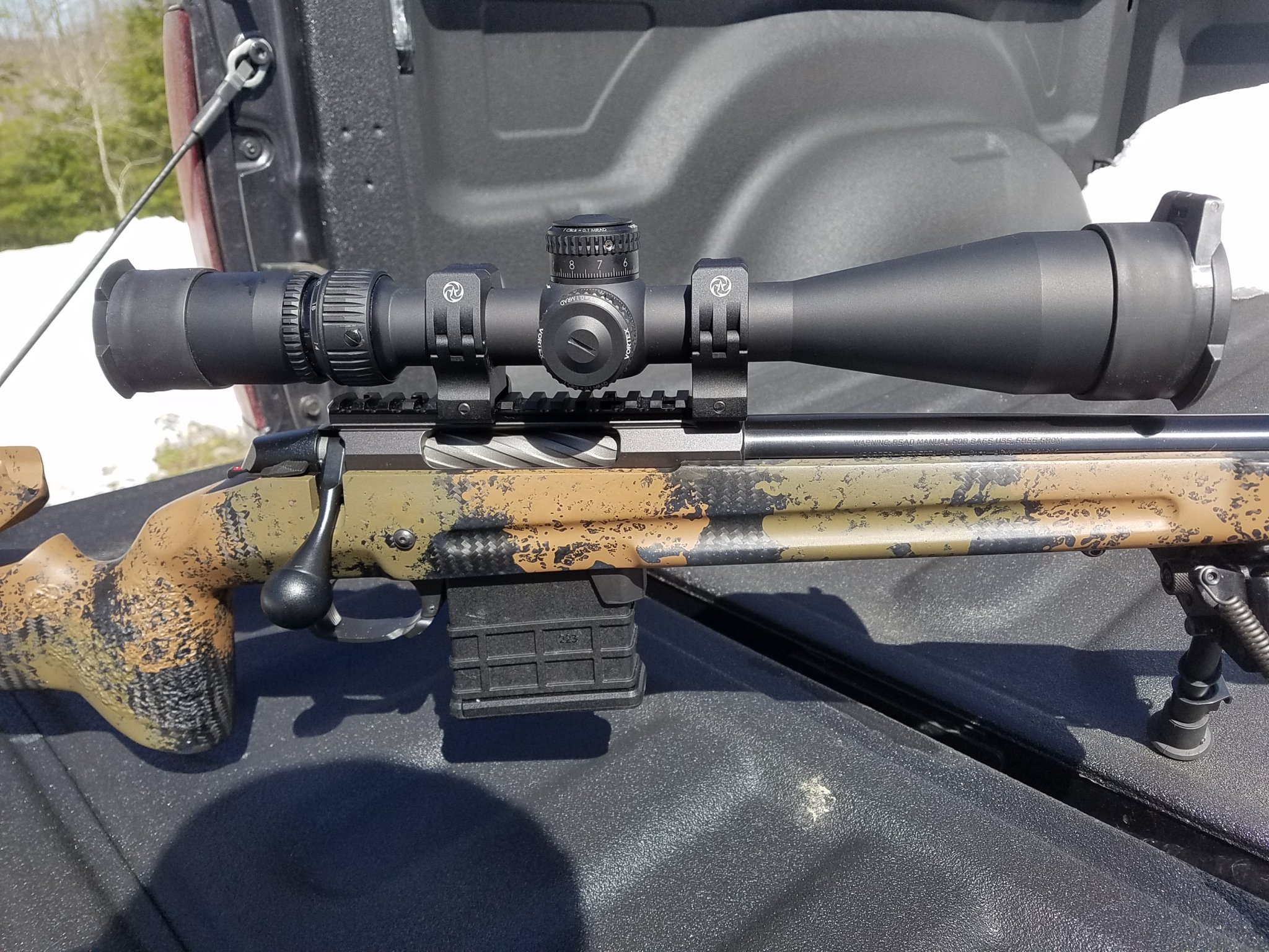

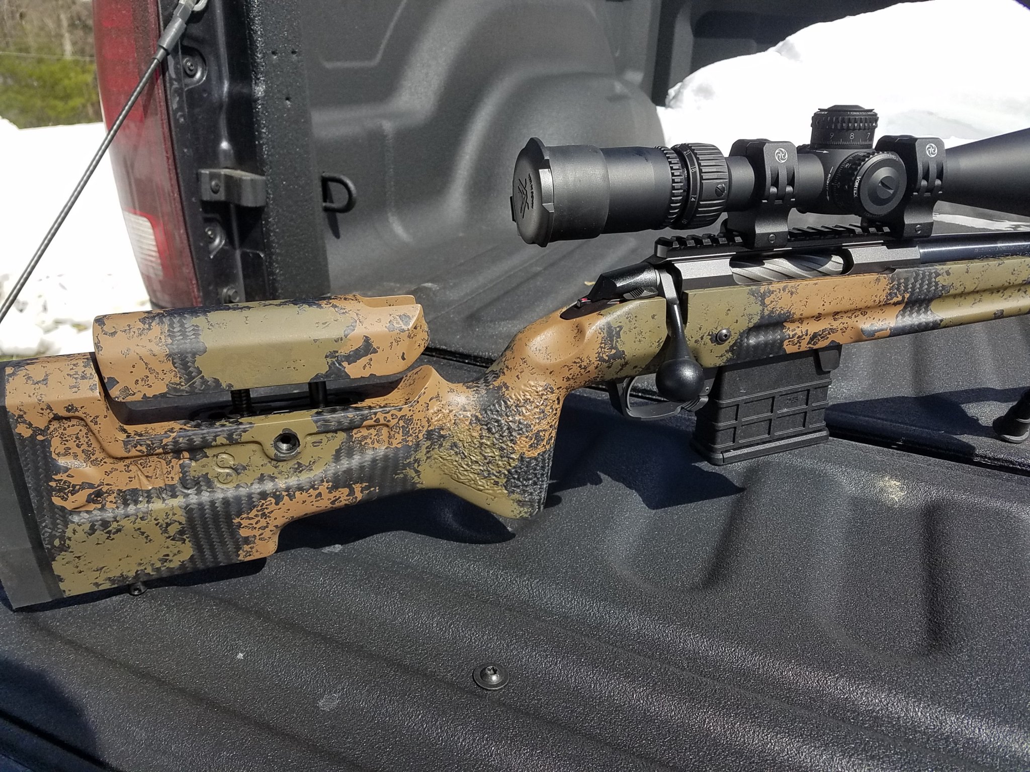

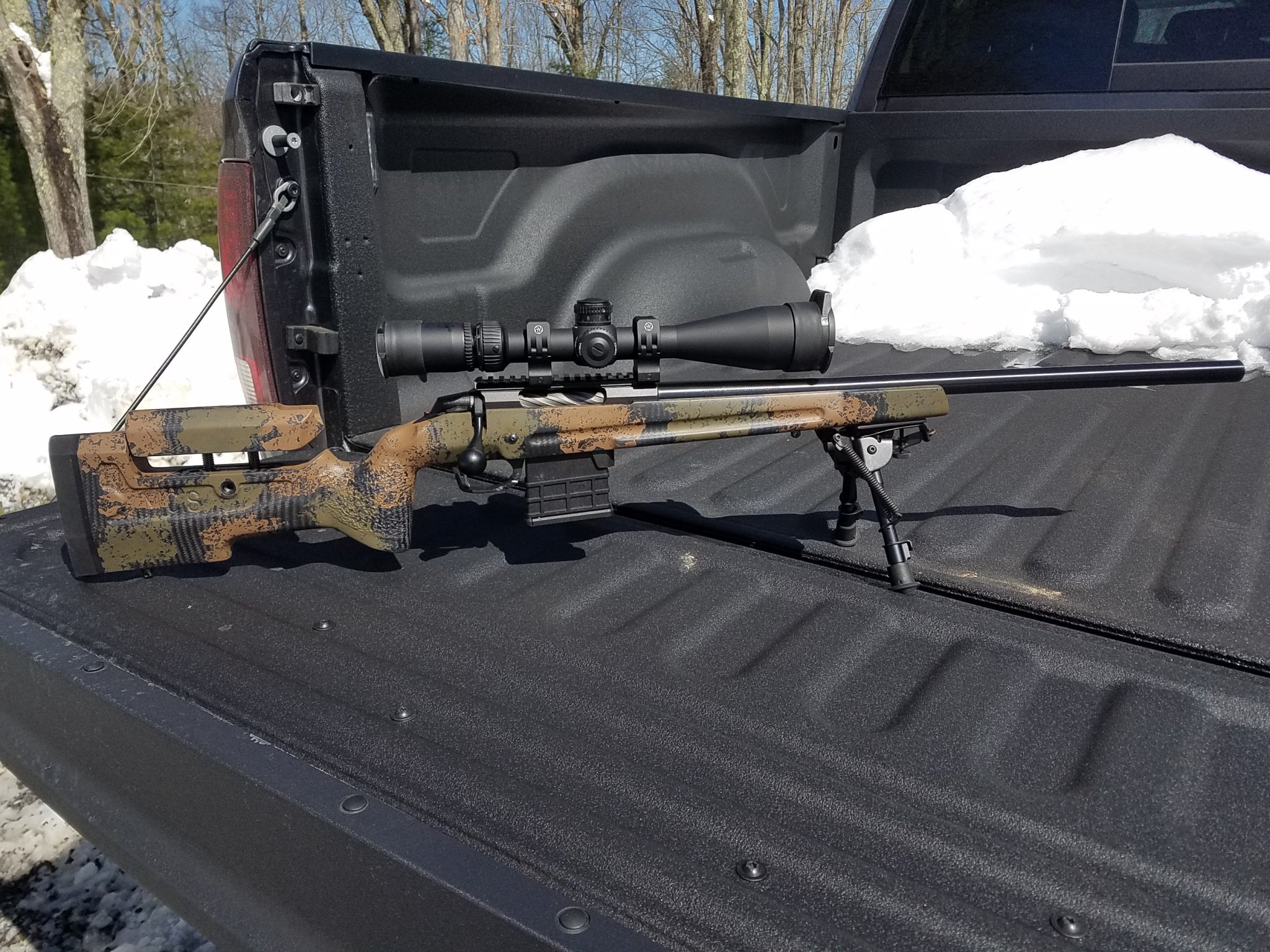

Well, this isn't exactly my custom but I had this one out today and decided I needed to participate. Just my fun gun..
Tikka T3X 223 varmint
Manners PRS1 with mini-chassis
MDT mag
CTR bolt handle
Bolt fluted and cerakoted in Tungsten
By the fine folks at LRI
ARC 30mm M10 rings
Vortex AMG EBR7
Yo Dave trigger spring
Mountain tactical 20 MOA rail
I know, nothing special but I love this rifle..
@ICU22250 that is a beauty!! Can we hear more about the Tikka mini chassis, your thoughts on the stock, etc etc.
I have a CTR that whispers to me about the Manners Tikka mini chassis. I need to know whether or not to listen :)
I like it, but if I could change anything it would be to go with the PRS2 because of the way it rides in the rear bag.. seems to fit snug in the stock, I had to do just a wee bit of trimming around the safety lever at the top as it was contacting and making it bind just a little. Was a simple 5 minute job with a dremel and you can't even see it... It does give the rifle a little bit of sexy, definitely an upgrade from the standard Tikka stock... If I were you, I would get one of the newer PRS models, I just think they're made a little nicer as far as feel goes, just my opinion though...

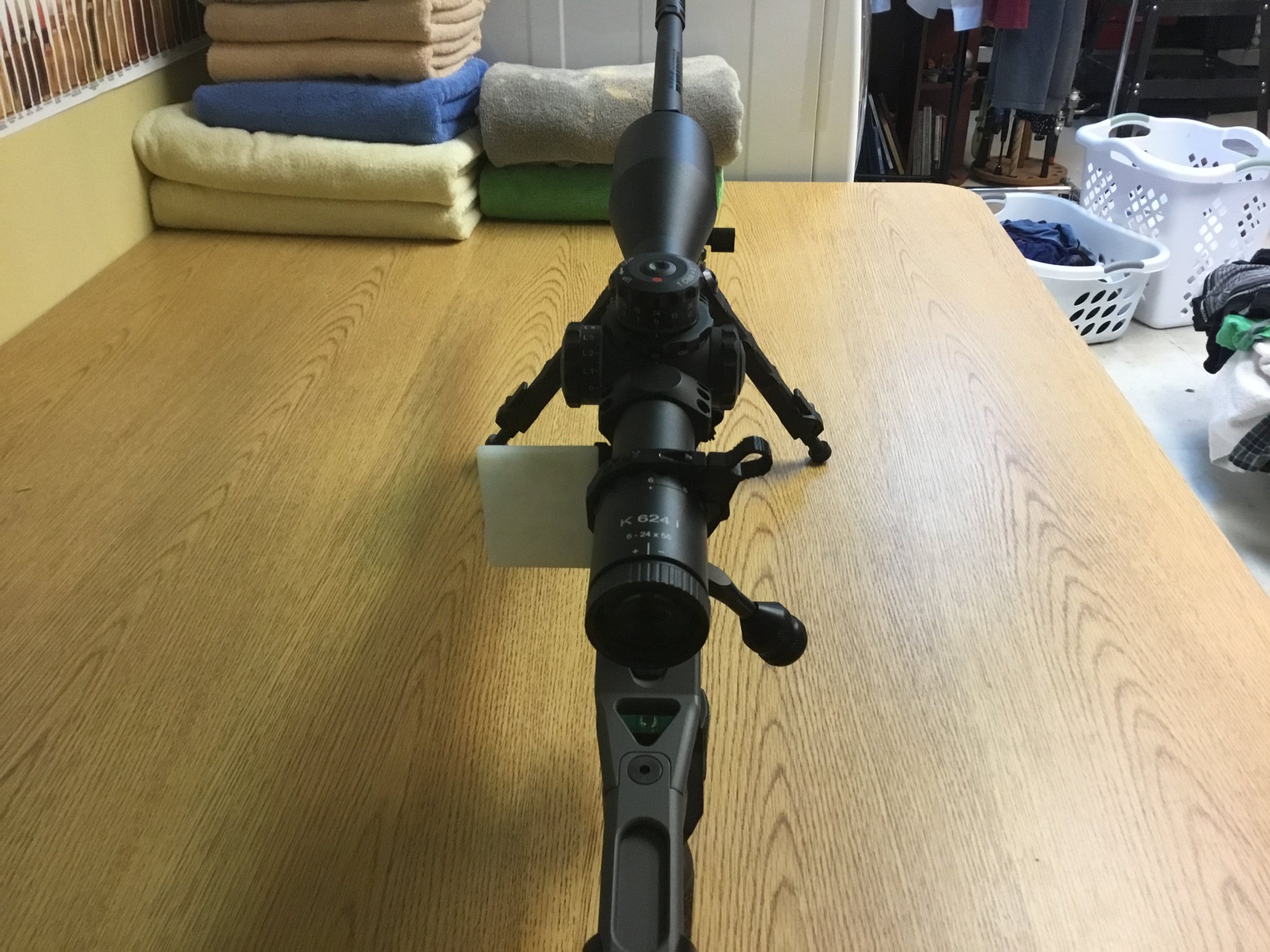

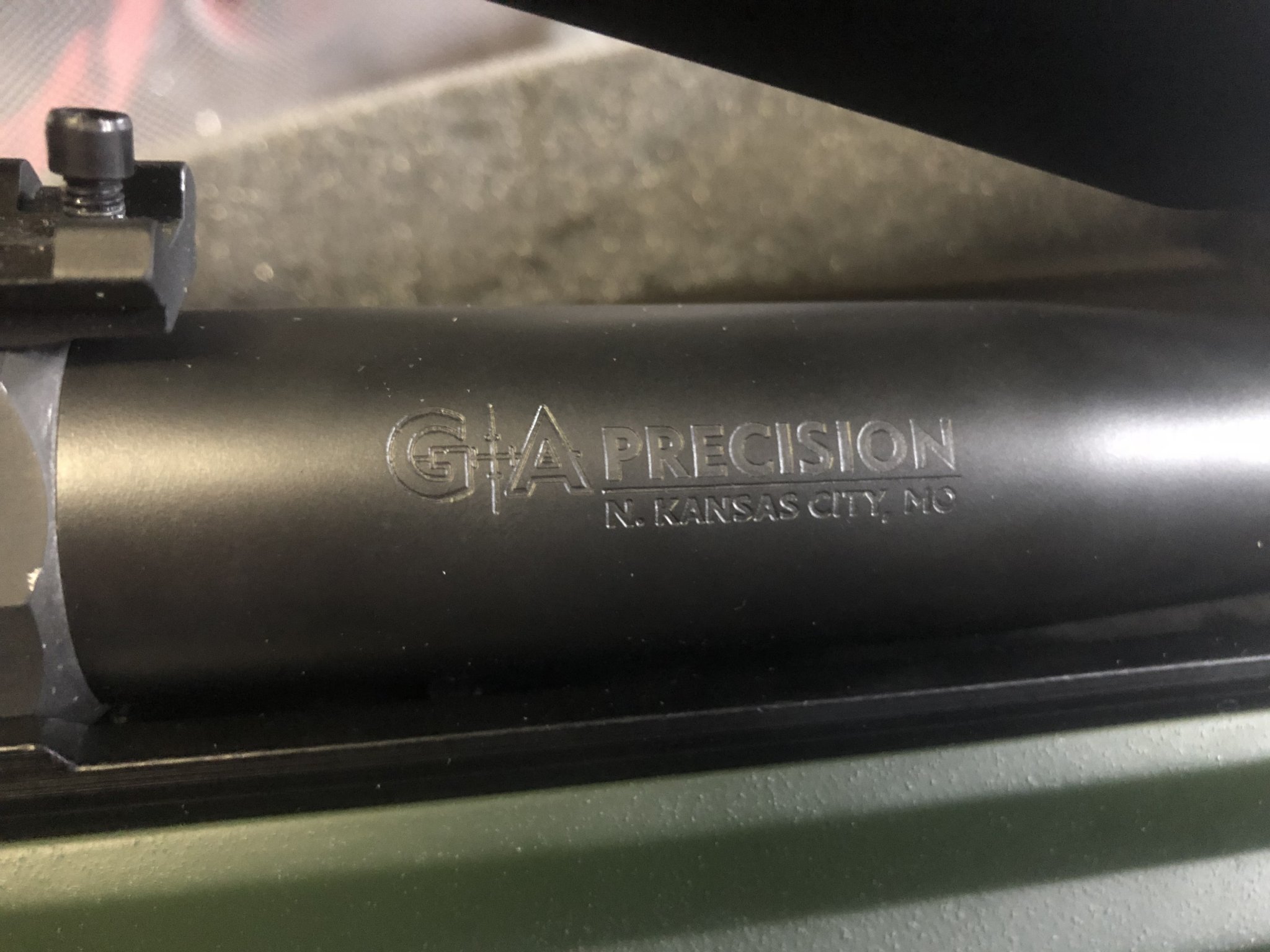

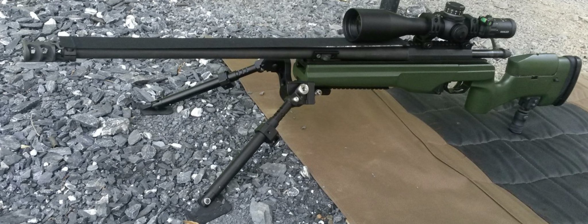

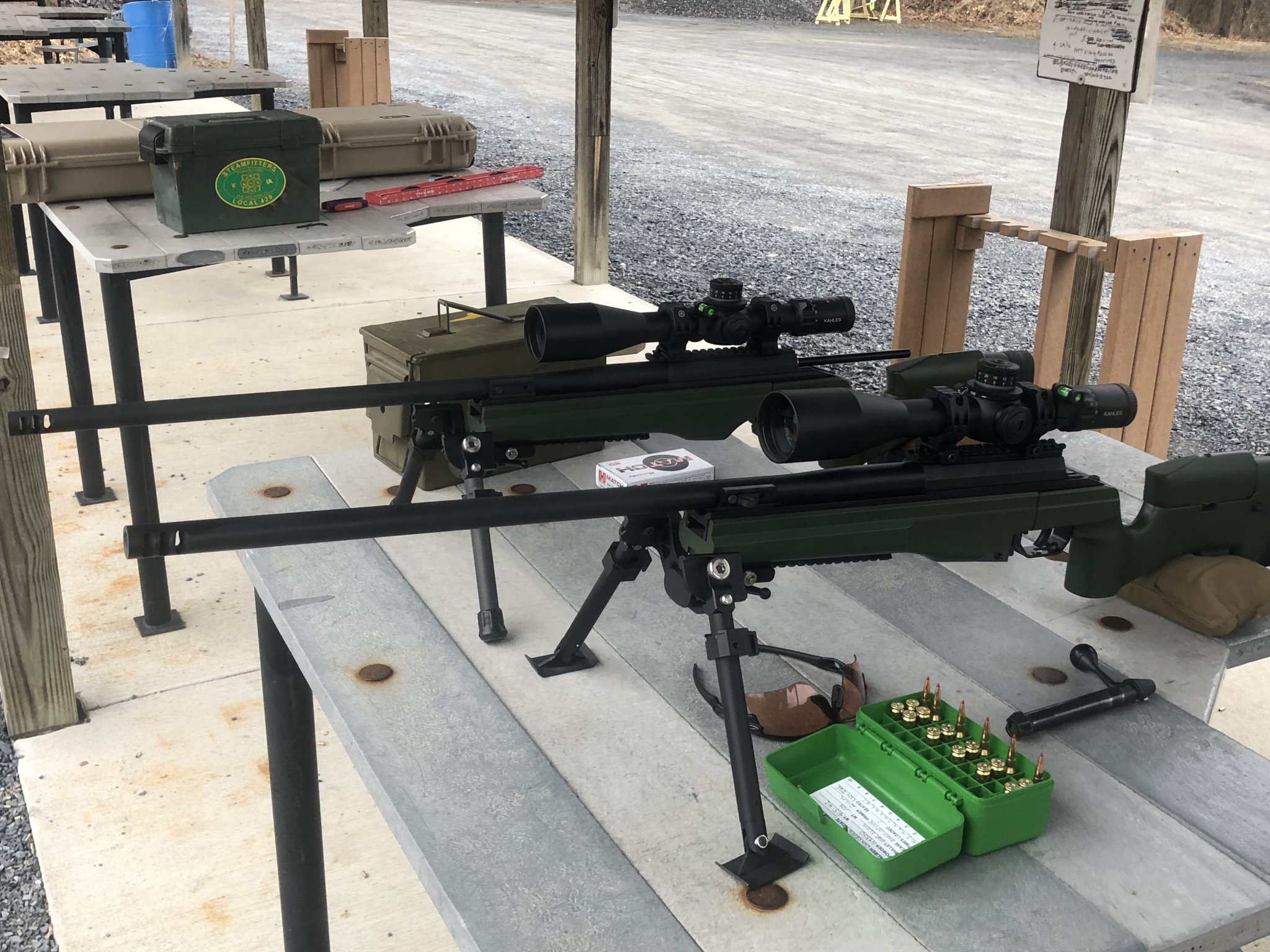

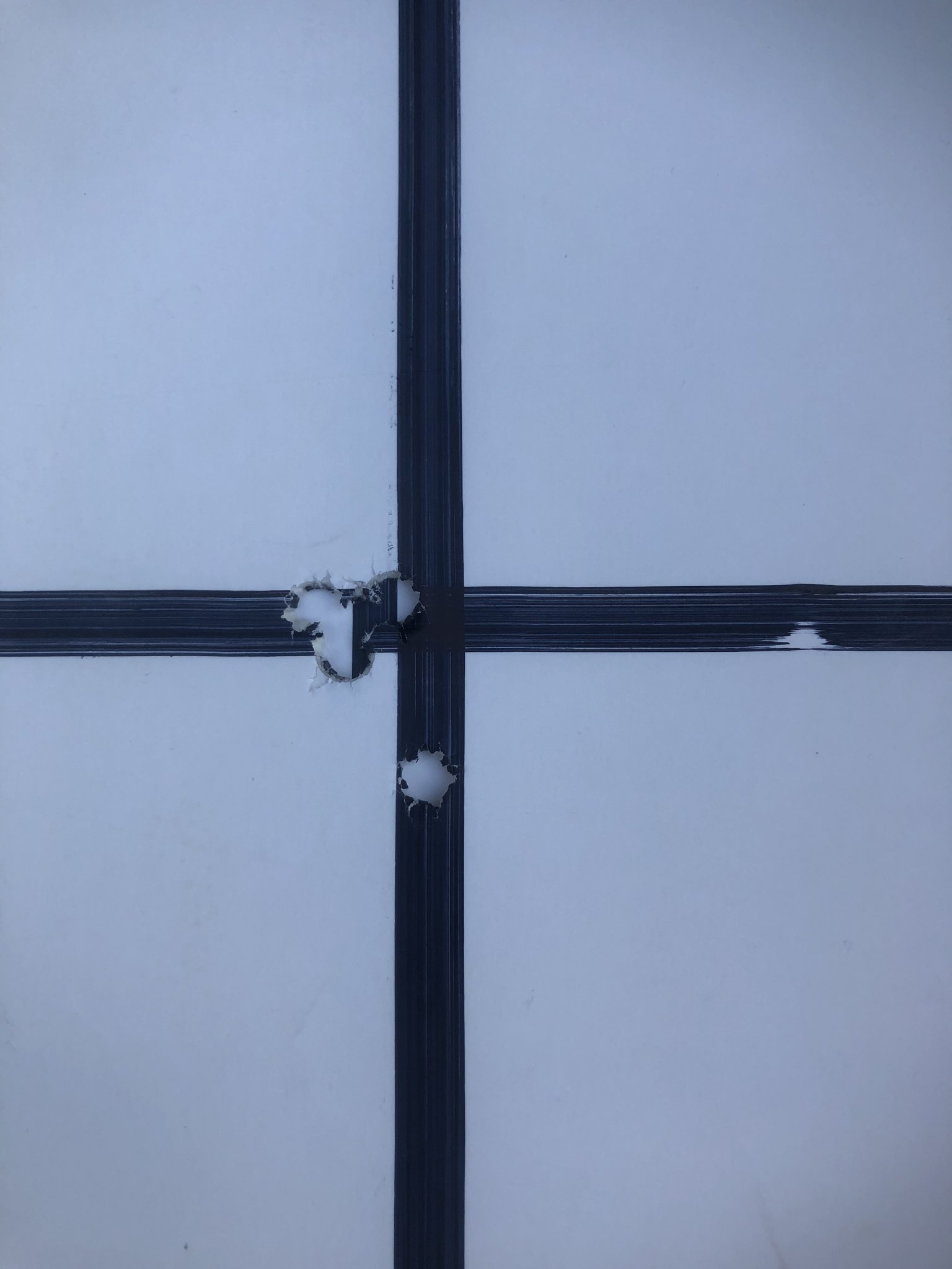

Sako TRG 22 chambered in 6mm creedmoor by ga precision. Lra bipod and kahles 624i scope. 5 shot group at 100 during break in from a clean barrel. First shots on a clean barrel seem to hit low.

@ICU22250 - love the bolt fluting. How does the bolt cycle after the fluting? Still as smooth as butter like a typical Tikka action?
Bolt still cycles great, I can feel a little bit of difference but not very much.. Chad at LRI done a fantastic job, and had it done it a couple of weeks. Top notch shop with excellent communication and work...
