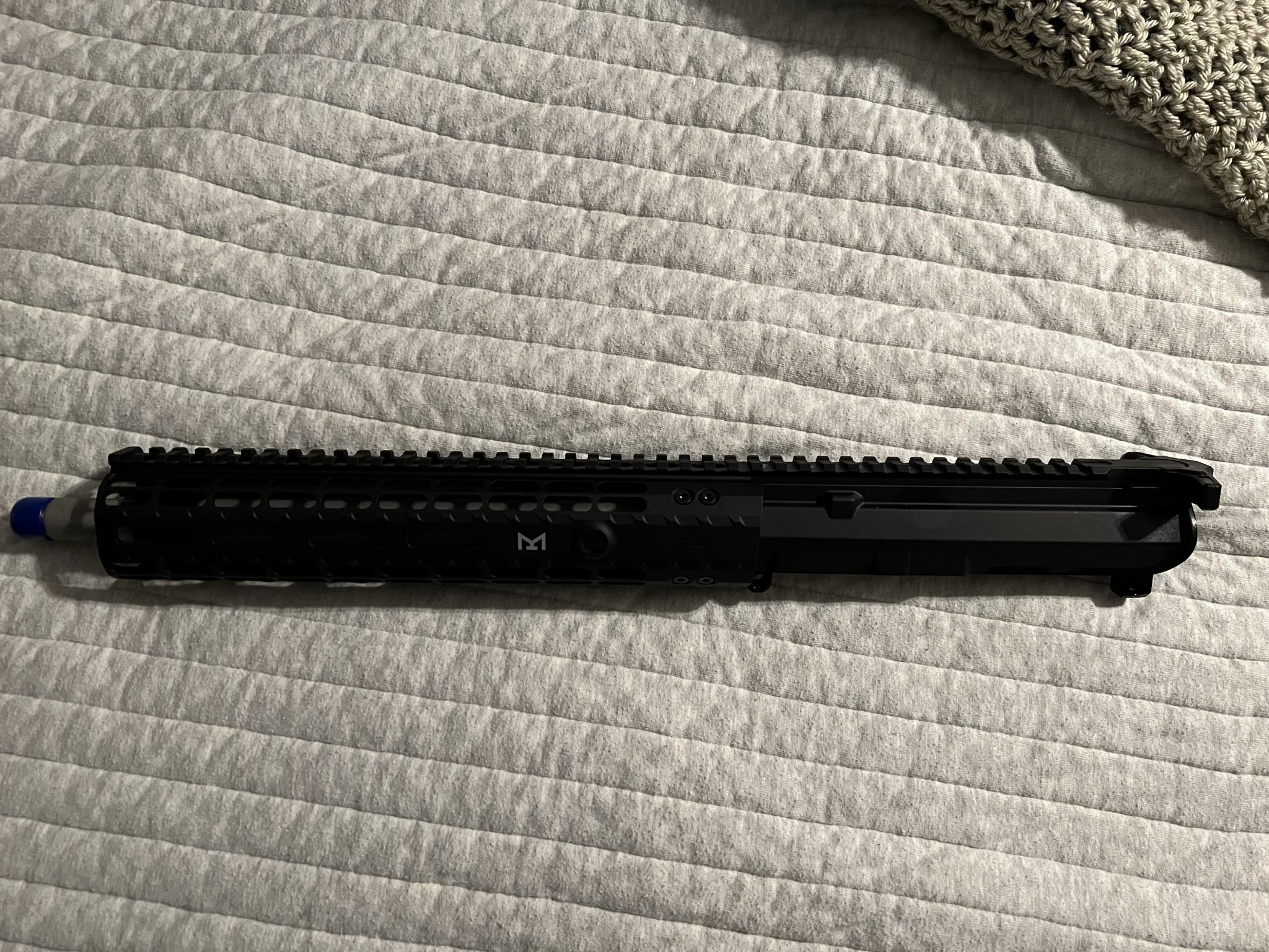

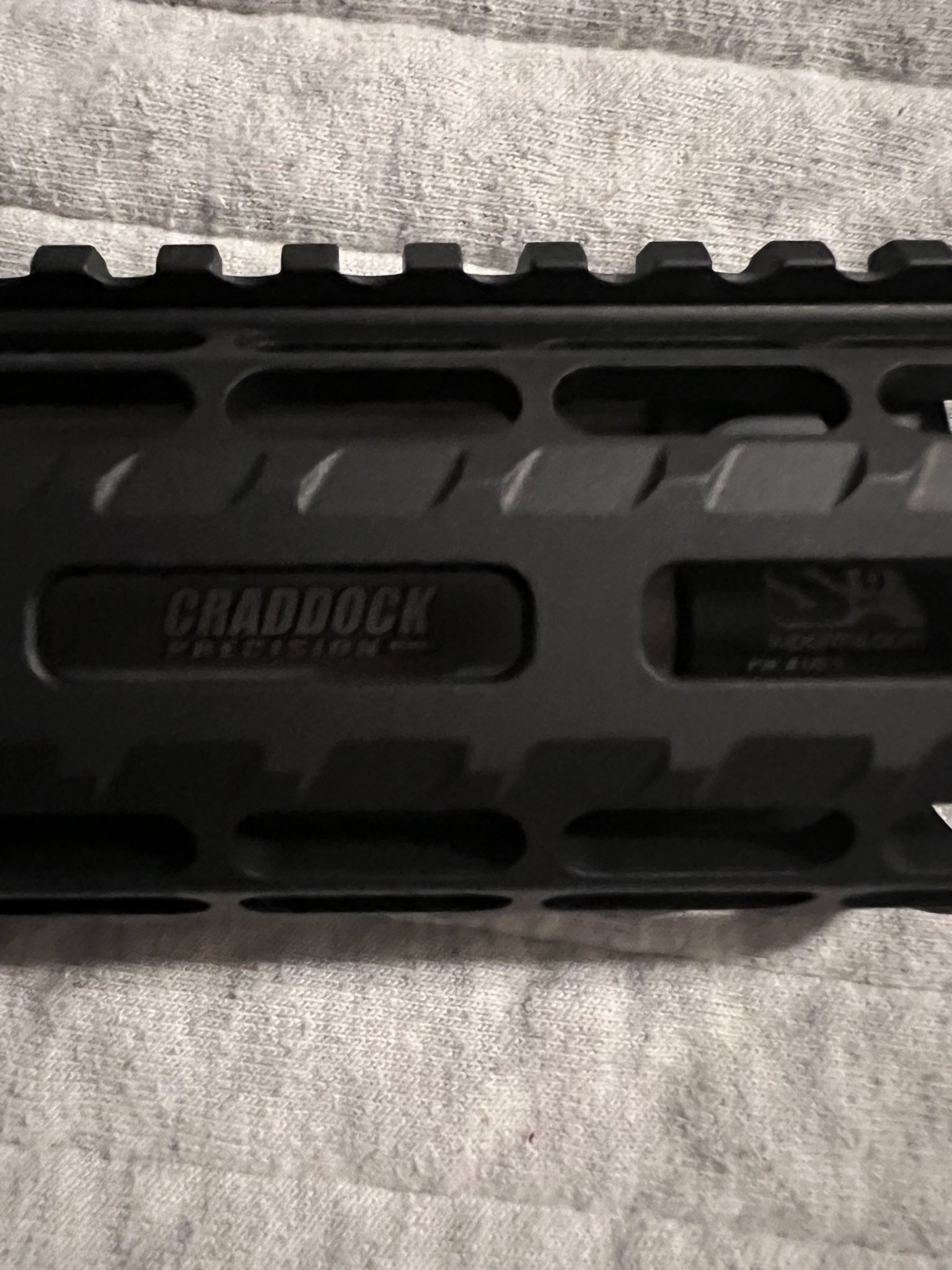

@cjs88 What work did Craddock do for assembly? Just assemble the parts or any truing, bedding, etc? They’re making my barrel right now, and I also planned to put it in an Aero enhanced upper. Curious to see your results.
Assembly and head spacing is all I believe. Never heard of trueing or bedding for an ar but I don’t follow that type of news.

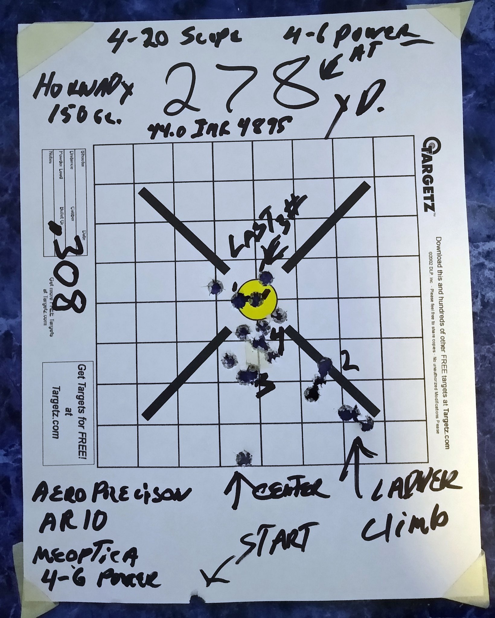

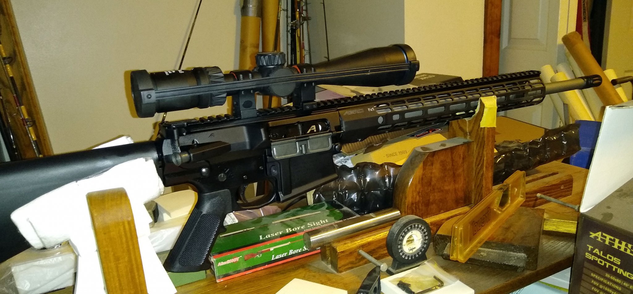

I was dialing My scope in ,which normally I'd do at 165 yd. ,however had targets setup for 6.5 CM zeroing and was using run of the mill .308 loads
