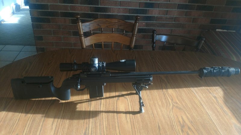

Finally have my rifle the way I want it and have 600pieces of prime 6.5 creedmoor brass. Looking to get ready to tackle the next phase of the project which is reloading for it. Wondering what kind of luck you guys are having with prime brass as far as life, consistency ect. Thanks Brent
