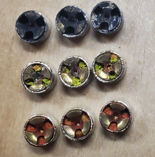

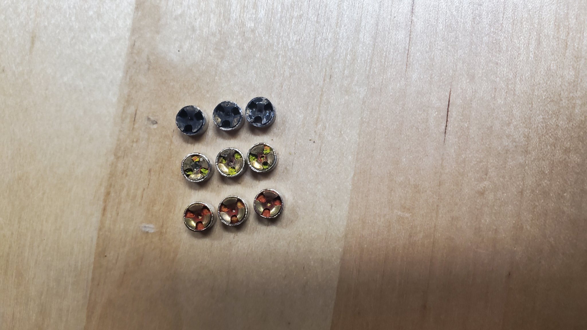

Had four apparent primer failures today in bolt gun. Primers were GM210M. Pix attached. Pulled bullets to inspect.
Three of the primers that failed to ignite in the pictures are in the middle, surrounded on opposite sides by fired primers and brand new primers from the same lot. Note color difference. These primers were purchased about a year ago, and stored since by me in dry environment at room temperature.
Any ideas here? Bad batch? Retailers selling old stock? Anyone else have these primers fail? Thanks.
Why are the 3 that failed showing Yellow vs. the new from same lot are Red Primer compound???
Somethings fishy here. Missing compound? They looked like they'd all been hit plenty hard!
Not primer compound, it is a coating. 210 M's red, 215M's purple, 205M standard gold. I would bet firing pin strike broke the coating up and was not captured during decapping.

Does not sound like headspace. You have any pics of fired brass with primers still in? I am not familiar with AI rifles, but you don't hear anything thing about ignition systems on them.
This is likely what occurred. The "powder" weighed about 0.2 to .3 more after bullets were pulled, so guessing some part of the primers broke off on strike and mixed with powder.

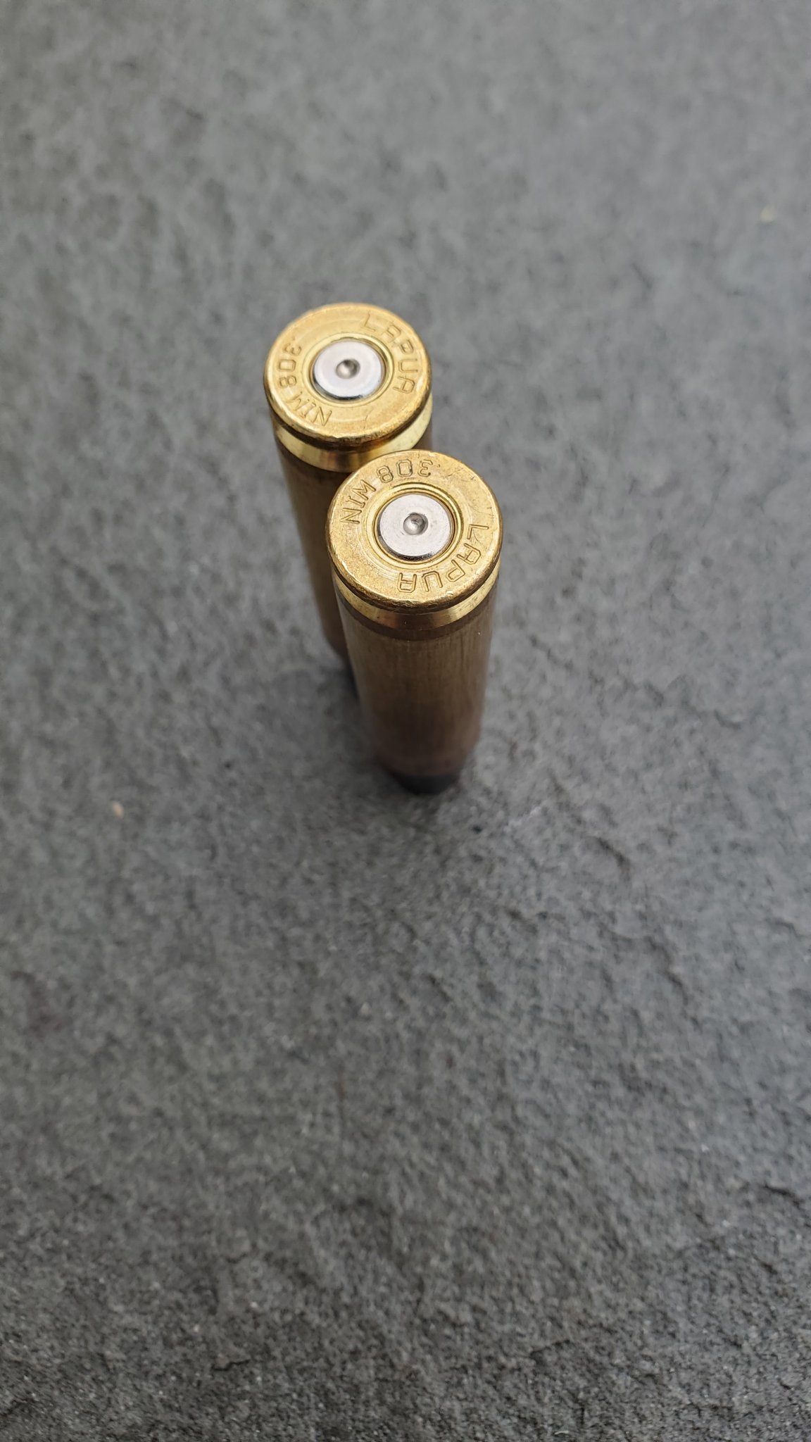

Pix of two fired cartridges with primers still in
Unless the ones that did not go off were the last 4 attempted to be fired, I would revisit your primer seating technique. Sorry, but all indicators point to the primer being pushed forward upon strike.

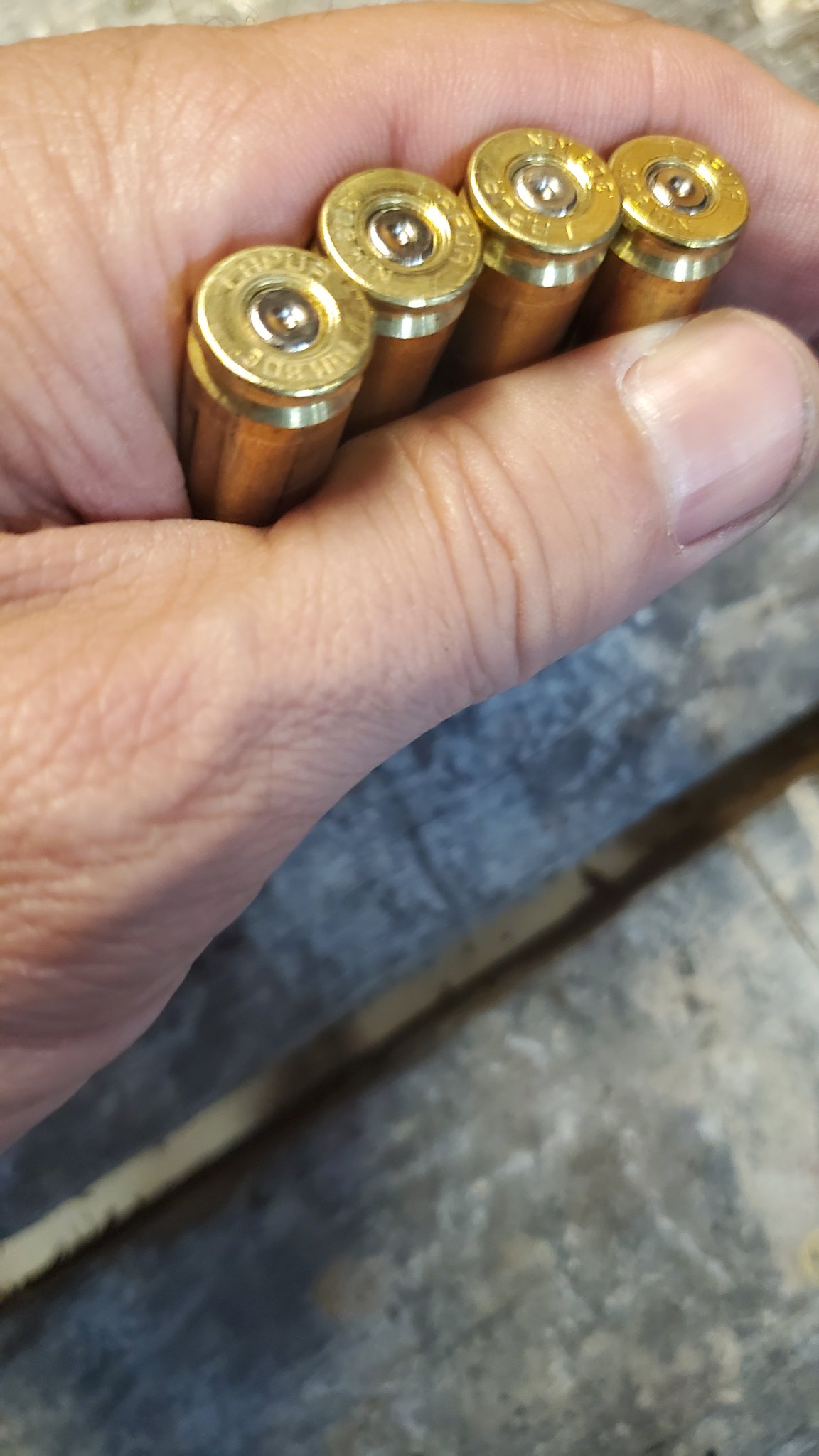

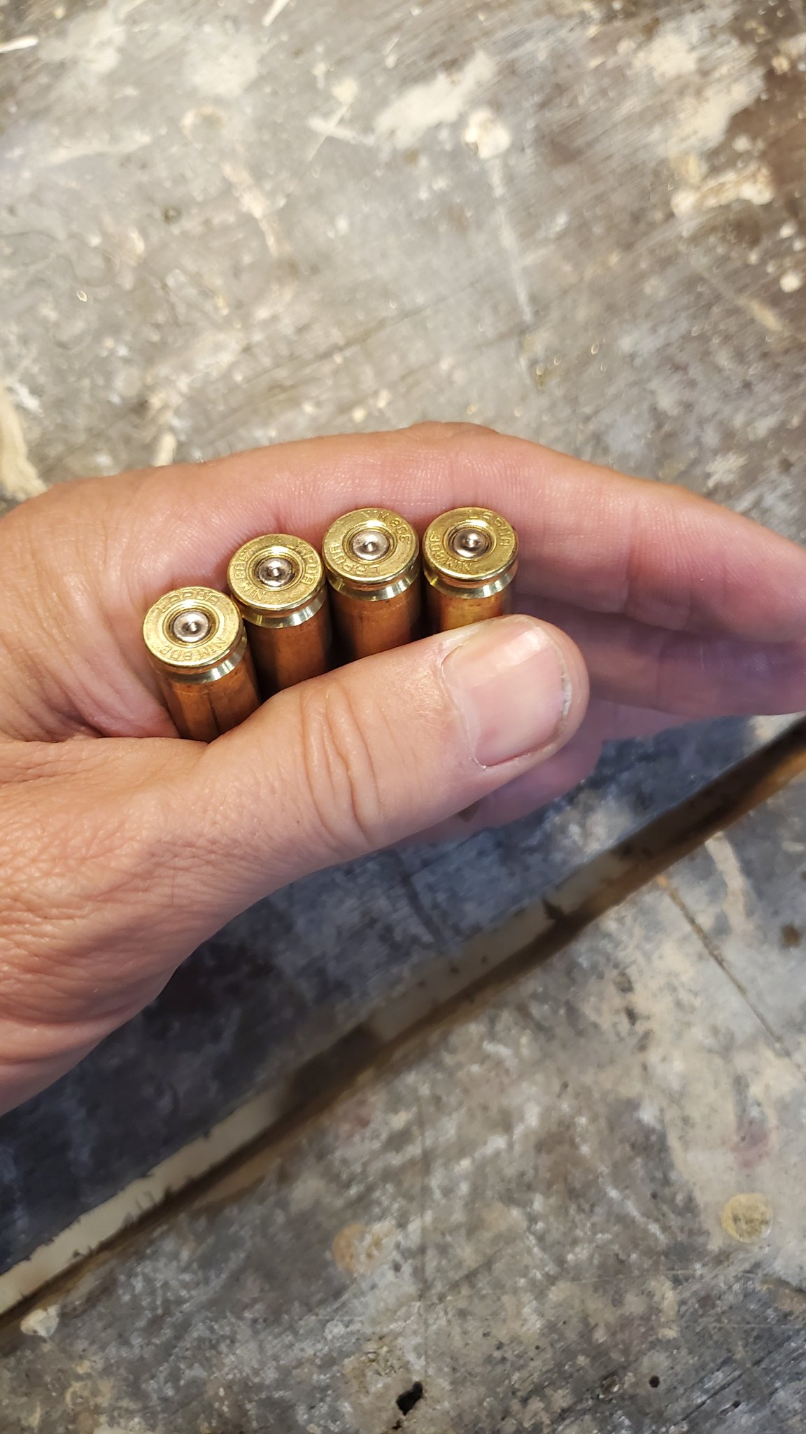

In your first post you have a pic of you holding four cases, primer up.
I mentioned that the primers look way too deep into the pockets.
Did you uniform the primer pockets on this brass?
Did you cut some of them too deep?
Either way. Measure the pocket depth on those cases vs some that fired correctly

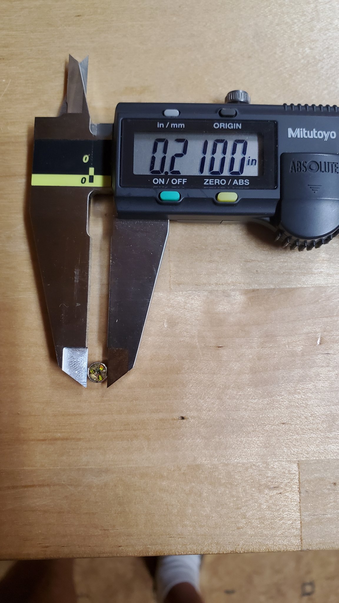

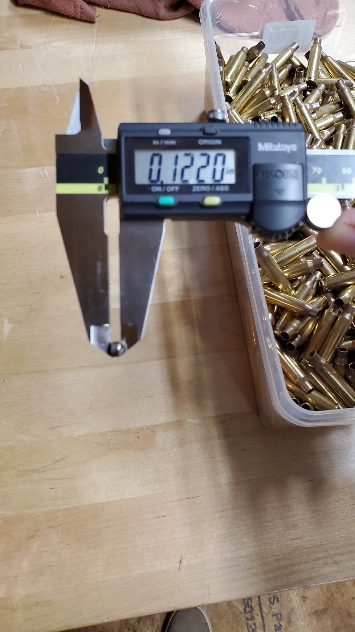

Original post said they were GM210Ms, which are rifle primers. Should there be any doubts, here are measurements of one of the removed duds.
Primer pockets for the cases at issue have the same depth as all my other lapua 308 brass.
i think guys are getting pissy because your replies are not 100% complete
a measurement would help/needed
saying they are the same doesnt mean much, especially if your other are low/deep as well
