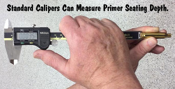

To measure the pocket depths the most common way will have you use the depth gauge part of your caliper. First make sure you test it on a flat surface and that its 0 really is 0. Then place it over the primer pocket and see what your measurement is. Once you do that you can measure the actual dimension of the primer itself and see where the differences are at. Then you can adjust your cutter accordingly. I bet your norma pockets are in spec.

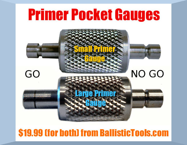

You can also use a gauge

Just invert the process for measuring the pockets, put the caliper on the cutter and drop the depth gauge to the stop body. Or sacrifice a few cases and see what they get cut to.

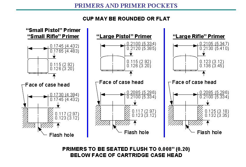

And a copy of the saami primer specs shown in that video, saami is flush to .008 low, most try to stick to .003-.005 below.
