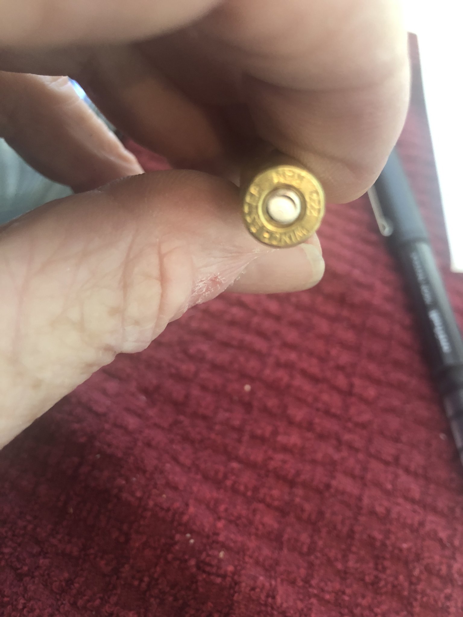

Pockets clean. Easy insertion. Winchester brass. Do not remember this on my large primer/ Lapua brass. Those are hard to insert and flatten. These 205’s in Winchester brass crescent shape.
Upon closer inspection the plastic insert holding the shell holder looks worn. Movement the Lrp insert does not exhibit. Think I have a possible answer. Ordering the part now.
This is an RCBS hand tool. Two piece plastic inserts.
Good call but this is 223. White insert, small rod.
In this case it appears the insert is worn. Rod contacts the base partially. Forces the primer to the base then deflects off the base of the case. Smiges at an angle of sorts to its final seat.
