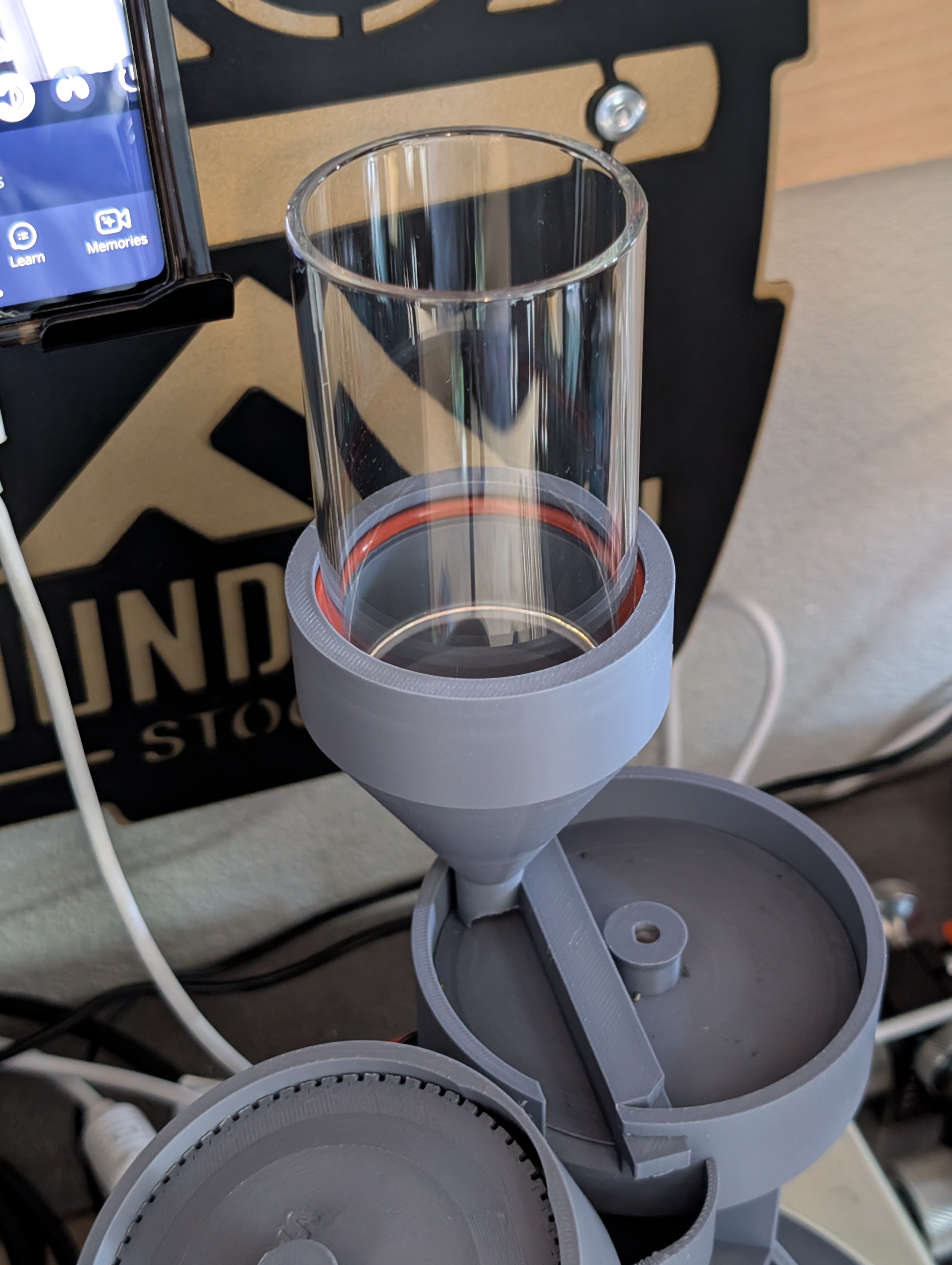

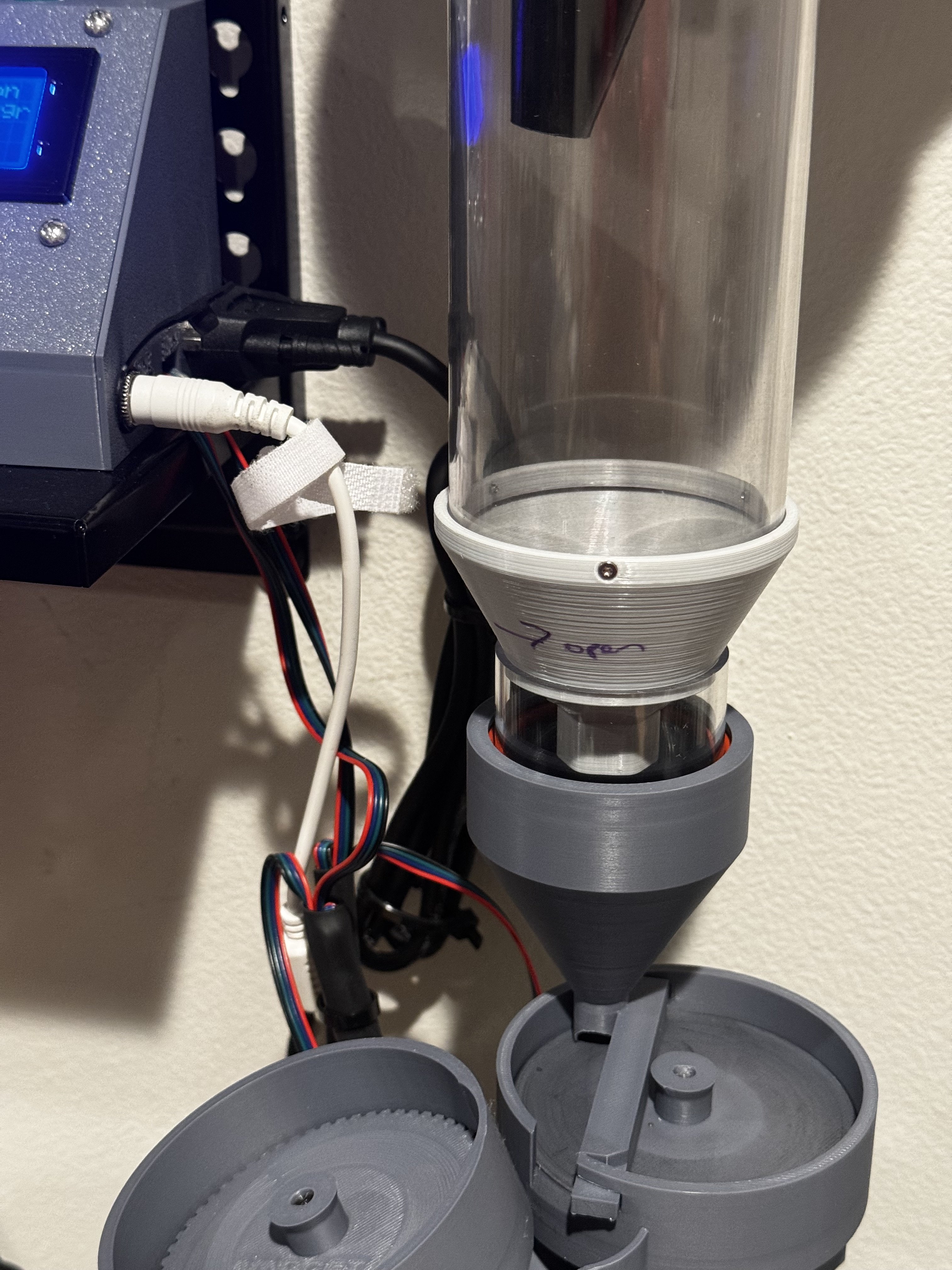

I have tried N568 and got some bridging in the bulk hopper. At the time (in beta) I needed to go back to my v3+IP as the bulk drop was more consistent. Trickling was fine, but the latest rev of the bulk hoppers should address this. I haven't been able to try it yet but it took some discussion to iron out the kinks, and it does appear to be sensitive to your environment. Testers in very low arid environments didn't cite any issues, but those of us in more humid environments could reliably get bridging with large kernels.
wkarma I know has tried retumbo. the creator used N570 as a test candidate for these large kernels
I use it with Retumbo and 8133 frequently. You have to change the disc to the larger "Retubbo" disc, but that's it.
That video was on original prototype hardware and first release software. Since then Dr PP has updated some of the bulk thrower geometry and software logic to work better with larger powders. (Early bulk would sometimes bridge in the hopper if you had too much in there, and the new software sets the tolerance based on calculated kernel weight during the calibration.)
What is “bridging”?
Powder bridging is when powder granules clump together and form a partial blockage. This is most common in narrow drop tubes or funnels, with static electricity buildup, and when the powder is dropped too quickly or without vibration. It is most common with long-grain extruded (stick) powders.
In the PPT, I would think it would have happened near the exit point onto the bulk disk, because it looks/acts like a narrow funnel right there.
