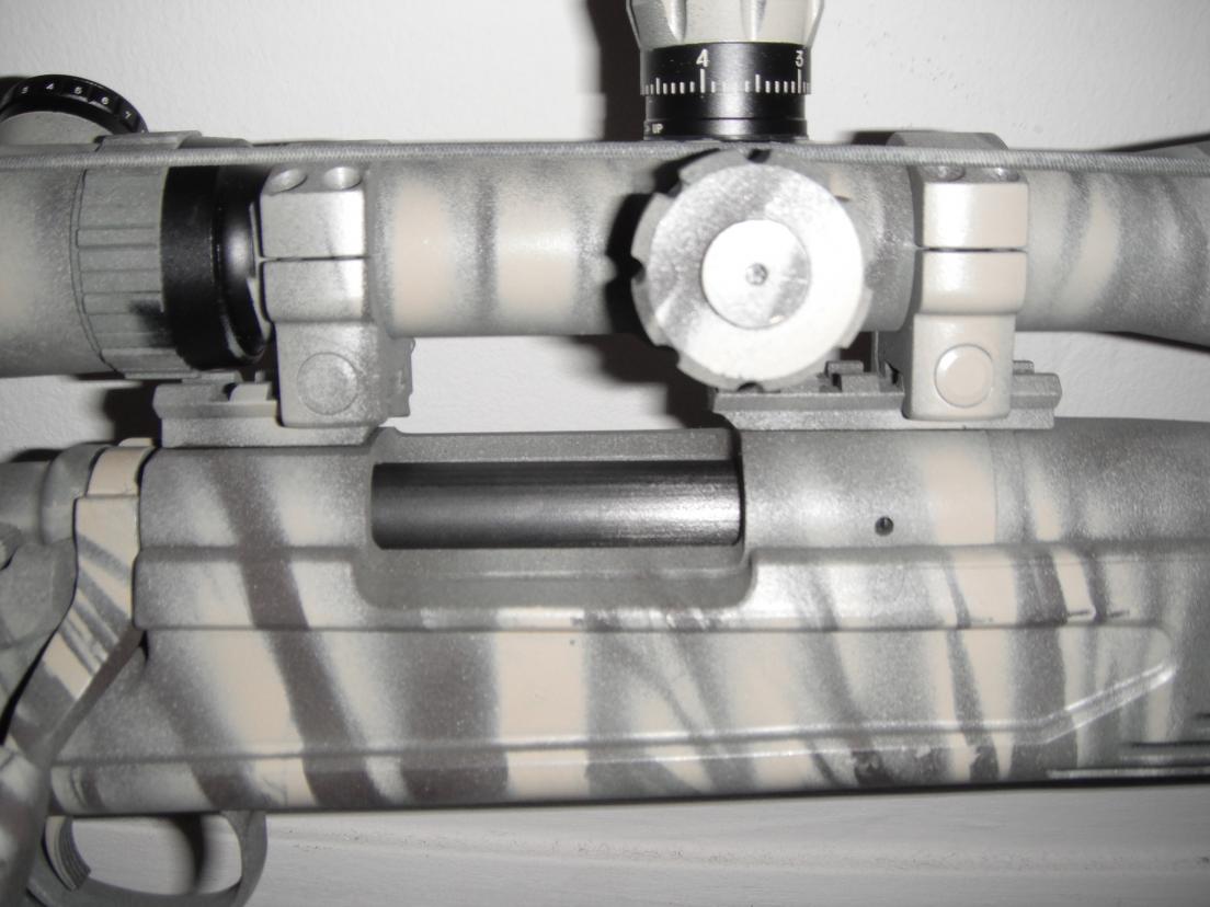

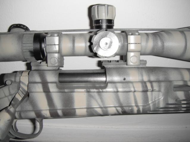

Here is a picture of my set up. I had a one piece base I chopped up so I could load rounds easier. The zero didn't change after modifying the base so that isn't the problem. It's shooting 1/2 MOA right now. The rifle is a couple of years old and I changed the bolt handle, trigger, stock and painted it so I'm sure Remington wouldn't help me out with it. I'm thinking of just getting a 40 MOA base but that's still just a bandaid. I'll be bugged by it till it's right. I really think it's the barrel/acction fit. Something isn't square.

From the picture it looks like the front mount is higher thsn the rear, which would cause the condition you mentioned. Did this come as a two piece? Something looks screwy in how high the front of the scope is.
Did you have this problem before you chopped up the base?
You took a one piece base and made it into a two piece base. You should have just gotten a two piece base. It might just be an optical illusion but it looks like the ring on the rear base might be hanging off the edge a little bit.

I know I know. The base goes out far enough so both scope mounts have a full contact patch. I had this 1 piece and was hating dropping a round in and then pressing it down and then making sure it was all the way back. Forget about doing any of this with even light gloves. So I said screw it and dremeled the thing. It shoots just as well now as it did before. My zero didn't change at all. I was pretty impressed by that.
