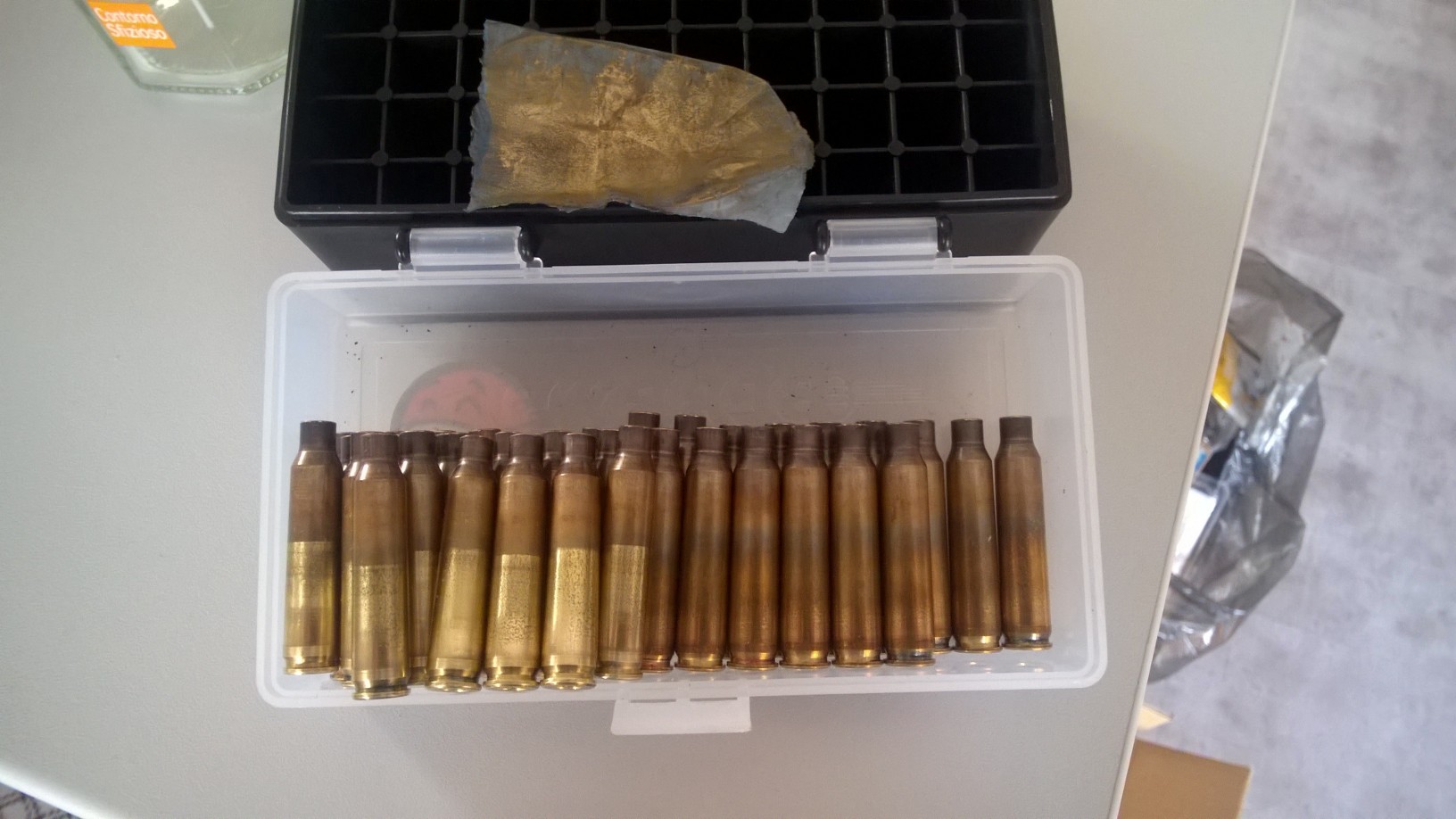

That is some grungy looking brass. A 95gn sierra at 2750 is very high pressure. Perhaps you should read a reloading manual.
i dont clean my brass.
95gr at 2750fps in my 32' barrel with very very long freebore does not seems to be very hot. primer pockets last for at least 10× firing at this speed. his is standard, not too hot F-TR load.
