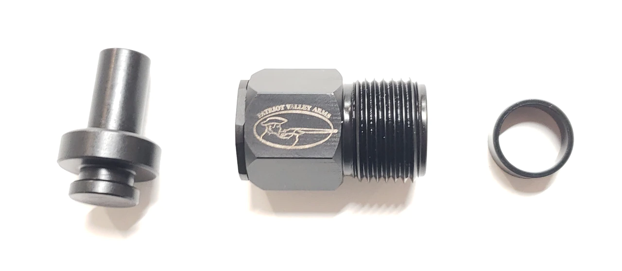

We have a new product shipping now, we announced it yesterday. The USB bushing die. It's a push-thru style base sizing die that allows you to push through any of a family of cartridge to size the web back down to as-new size. Intro pricing goes through the end of SHOT show next Friday.

I didn't want to do it either... Brass is expensive. I made a honed die that I simply pressed the brass thru using an arbor press in the shop. It took forever and it was a messy business. After some refinement we have the USB.
We are currently shipping dies for 473 shell heads and standard bodies as well as the WSM/SAUM/RUM family. More bushings are being made and will be getting heat treated and polished in the coming weeks.

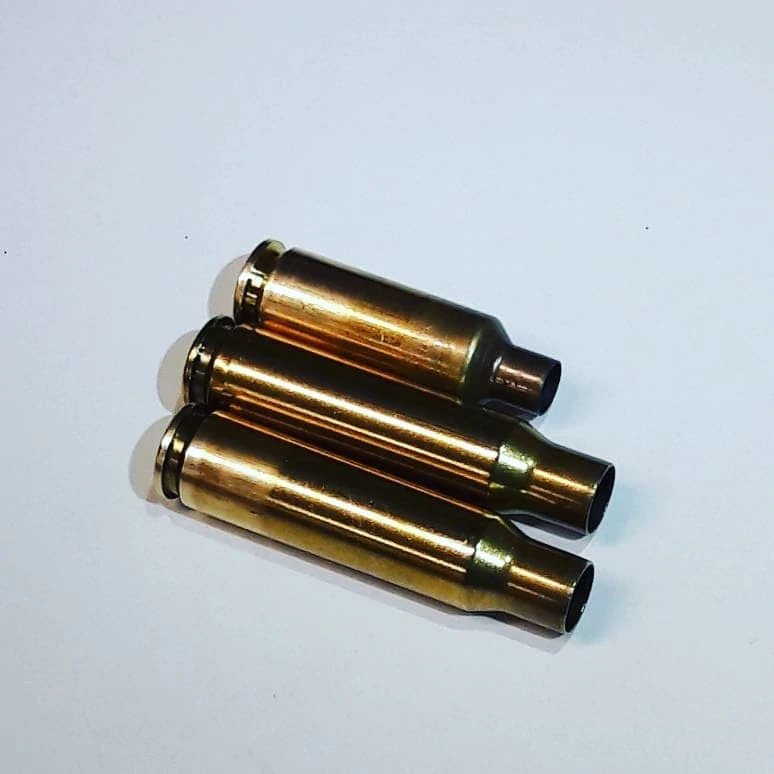

So where does the die touch the brass? Only around the case head where it's larger than spec size. Note in this photo from our website. The center brass is 308 Lapua brass that was fired in an older chamber several times. It measures 0.473 at the web and my new Palma chamber is based off the 95 Palma reamer which is ground to 469 at the base. New brass comes out of the blue box at 4685-4690.
Either side has sized brass, one from the 308 which now measures 0.4685 and the top is a 6mm Dasher that also measures 0.4685 and smoothly fits in my chamber after being fireformed in a buddy's smoked barrel. Note how the brass shows a very shiny portion about 3/8" above the base back to the extractor groove.

Out of curiosity how much headspace growth did you see on the brass running it through the bushing? I've had a pretty notable push forward last time I tried a small base die on Dasher, the brass went several thou beyond chamber length and required an aggressive shoulder bump to get it back to being able to chamber. Wondering if the bushing produces a similar effect.

Additional bushings are $25, additional punches are $15.

We're not at this point. Our current infrastructure can't handle it and I don't want to overtax my guys handling order fulfillment and web traffic. My advice would be buy the 473 or 555 setup now if you're going to use it, extra bushings are going to be $25. If you're going to need it then it really doesn't matter which you buy first.

I haven't seen the headspace change measureably on sizing, stuff that had been FL sized but the base was too fat only needed to be shoved through the die and the problem was solved. The base ring of the brass case is a tough piece of material and it seems that we see something WAY oversize actually react better than something that's just a little oversize. The stuff that's just a little oversize needs to go through 2x instead of the first time with a big fatty.
I attribute that to the fact that there's elasticity in the materials and if you bring the material past the plastic strain point sufficiently it moves well as opposed to remaining in the elastic-plastic overlap region where it might need continued working (aka shove it through a couple times).

I wish they would so I could get a properly sized 473 bushing thats more like 470 or 469 instead of the 462 it came with.
Does anyone have one of these that they would like to part with? I have a 6BRA barrel from PVA that shoots well, but my 500 pieces of twice fired Lapua 6BR brass are on the fatter side. I get a heavy bolt on close and open. I’m attempting to salvage them if at all possible.
Mine is nonfunctional, the bushing is too small, tries to size down to .463 or something instead of .469 or something more feasible. It would take a sledge hammer to force brass through it.
