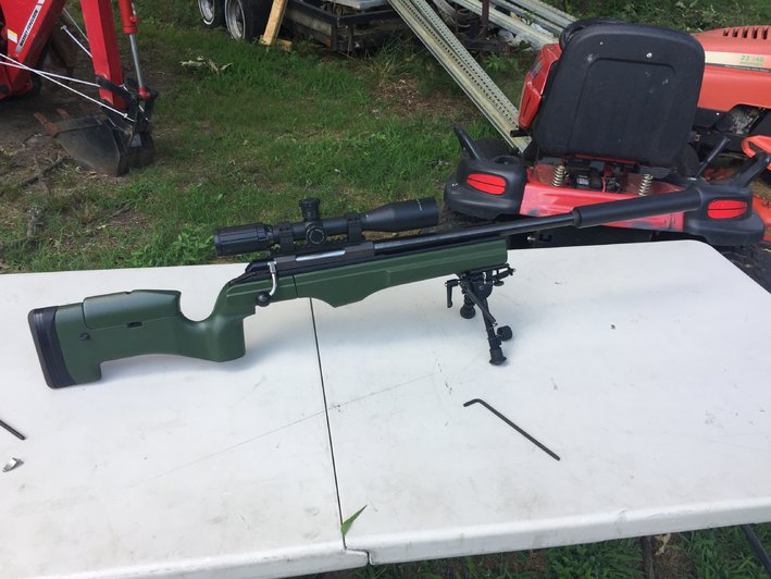

I wanted a TRG from the first time I saw one in my late teens. Being mostly a 22LR and 223 shooter, it was hard for me to justify getting more calibers just to punch paper. I got a great deal on a Tikka T3 223 with a 1:8 twist barrel so that I could use the heavier 75's and 77's I use in my AR's.
I never warmed up to the factory stock and magazine on the Tikka, the mag always seemed to have issues not picking up rounds. I started looking around for aftermarket stocks for the Tikka when I noticed that guys were adapting the KRG Whiskey 3 chassis to use TRG furniture on a Tikka Action. It seemed like more time and money than it was worth, but I found a good deal on a full factory Sako TRG 42 Chassis on EBay.
I messaged Justin at KRG and he let me order the "backbone" of the KRG chassis. I've got a pic of it mocked up with the TRG 42 chassis as the KRG backbone is being shipped today. Now I've just got to find a TRG 2 stage trigger and a TRG22 forend and I should be good to go!

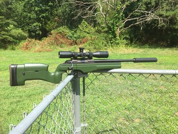

Got the KRG backbone and trigger guard. I had to cut the TRG forend screws down a few threads because the KRG backbone is a little different internally than the TRG backbone. Got some new M6 action screws at the harware store, did some inletting on the TRG stock and made a small pillar to relieve some tension the rear action screw was making on the triggerguard. It turned out better than I hoped. The polymer 223 AICS mags require a good slap to seat fully, but they feed great.
You may want to try the Bix'n Andy trigger. It is available for the Tikka. The pull is nicer than the TRG. (I own 2 TRGs so I am qualified to say that) It doesn't have all the vertical/pitch adjustability but it is around $450.
