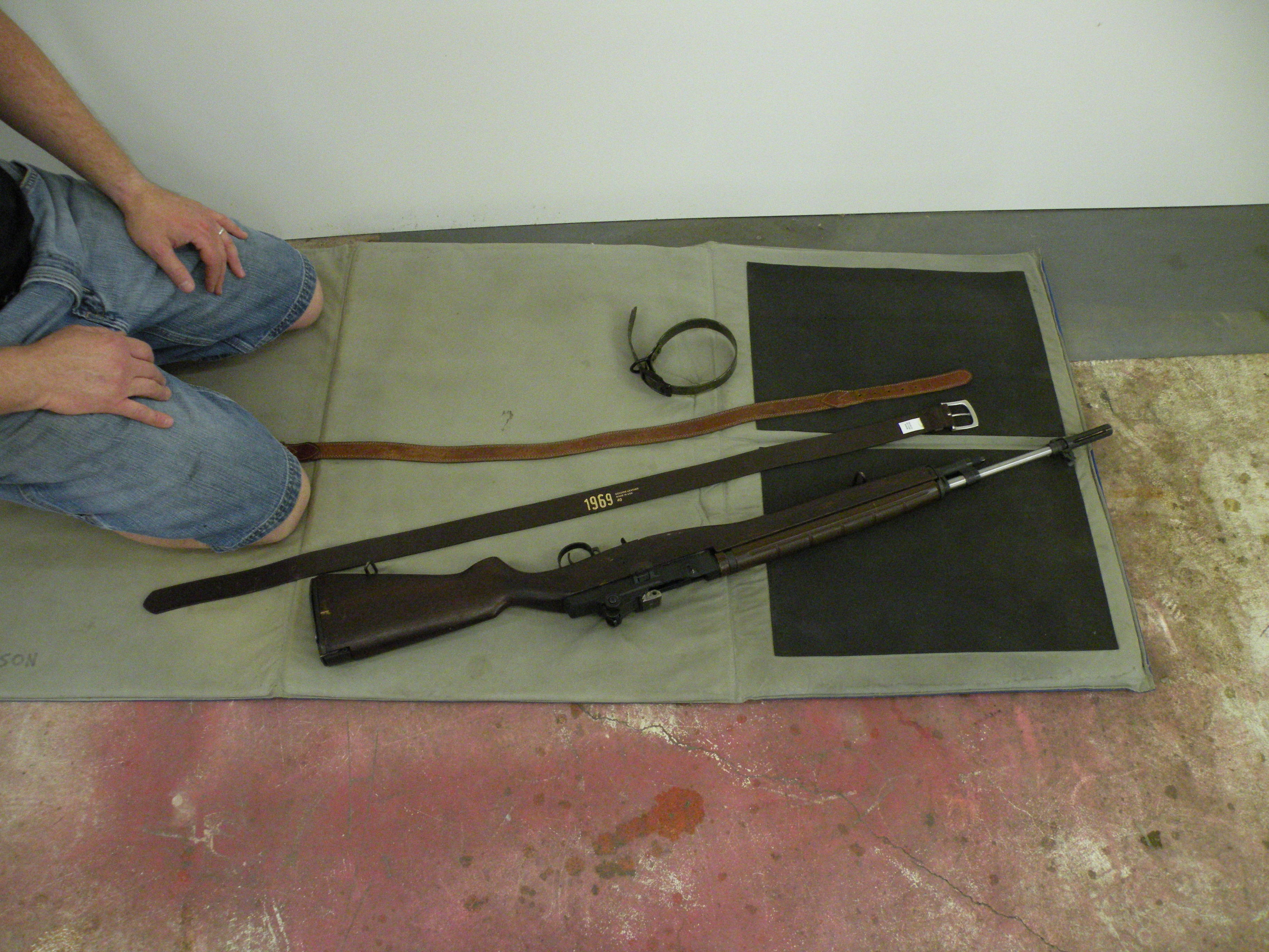

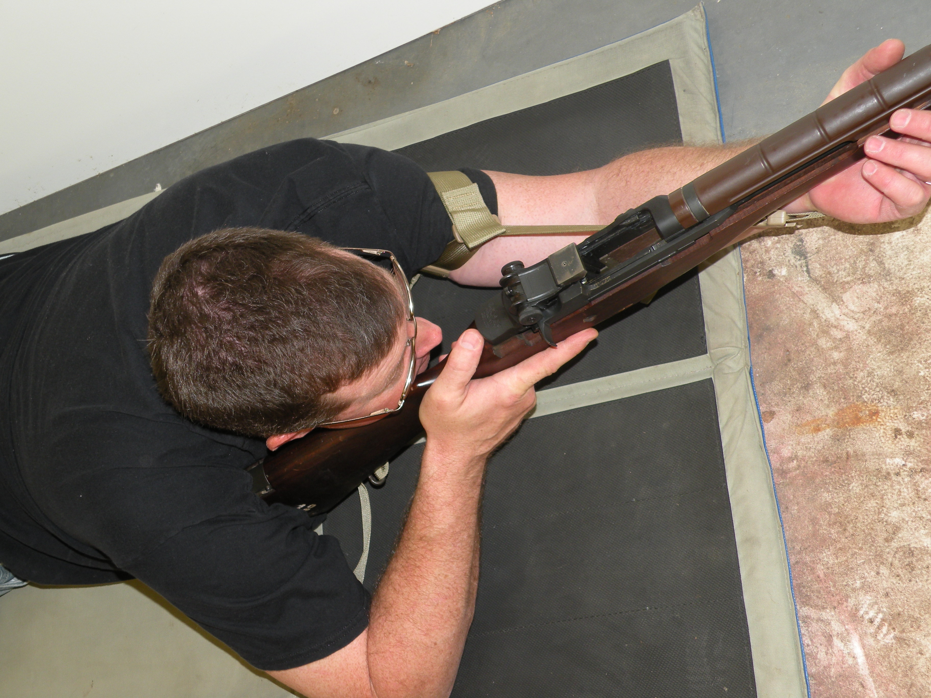

Now, remember where your forward hand was positioned on the forend of the rifle, when the butt of the rifle was firmly lodged into your shoulder. It's just a little tricky here, but the key is to place your forward hand on the stock at the same place as where you were able to achieve good butt contact with your shoulder.
FROM THIS POINT, YOU'LL ADJUST THE SLING LENGTH UNTIL THE SLING SUPPORTS THE WEIGHT OF THE RIFLE, AND YIELDS A REASONABLY TIGHT, YET COMFORTABLE "WELD" OF THE BUTT INTO THE SHOULDER. The forward hand stays in the same position as from that original mark. Maybe a half-inch further out, but not closer in!

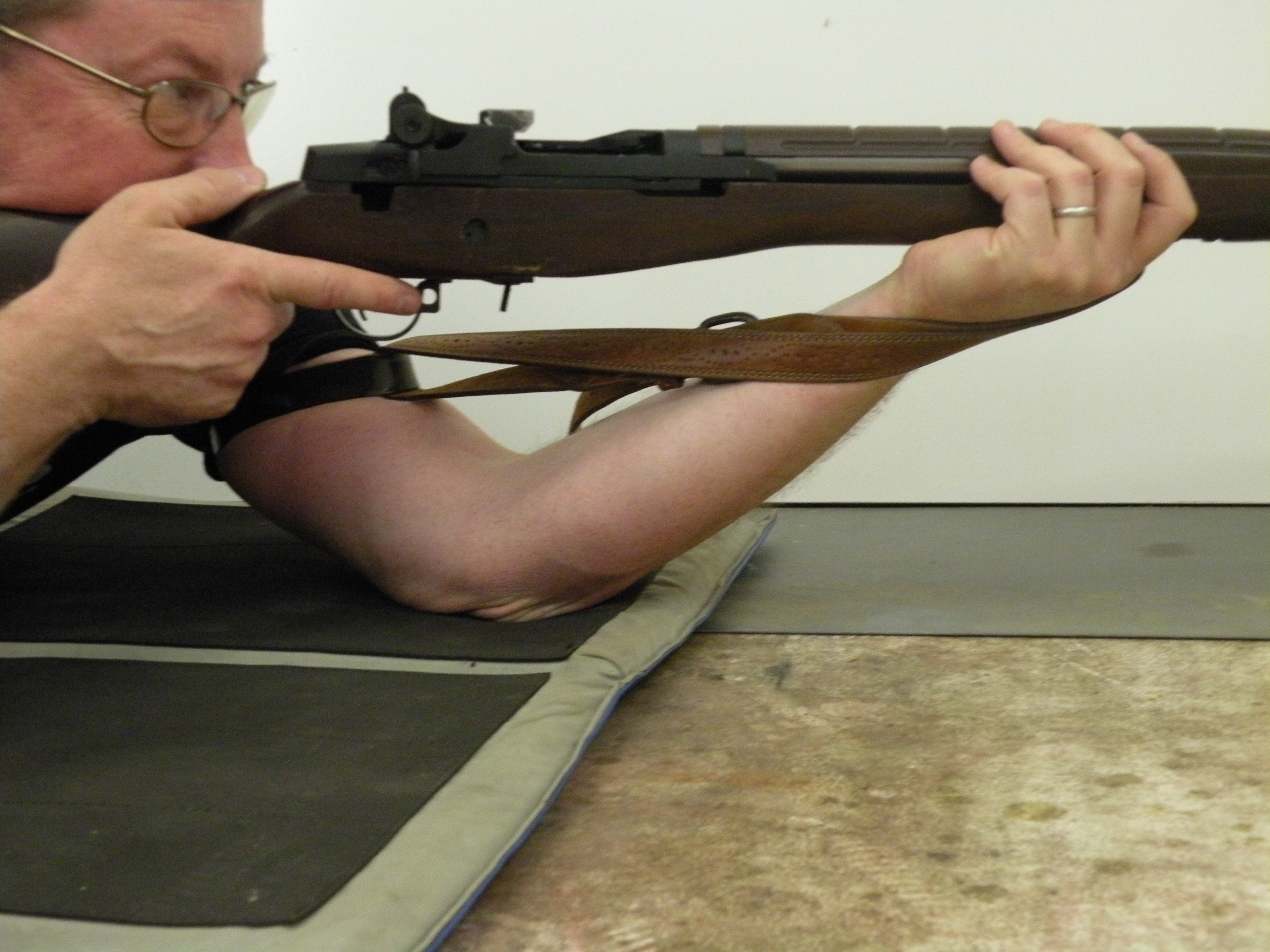

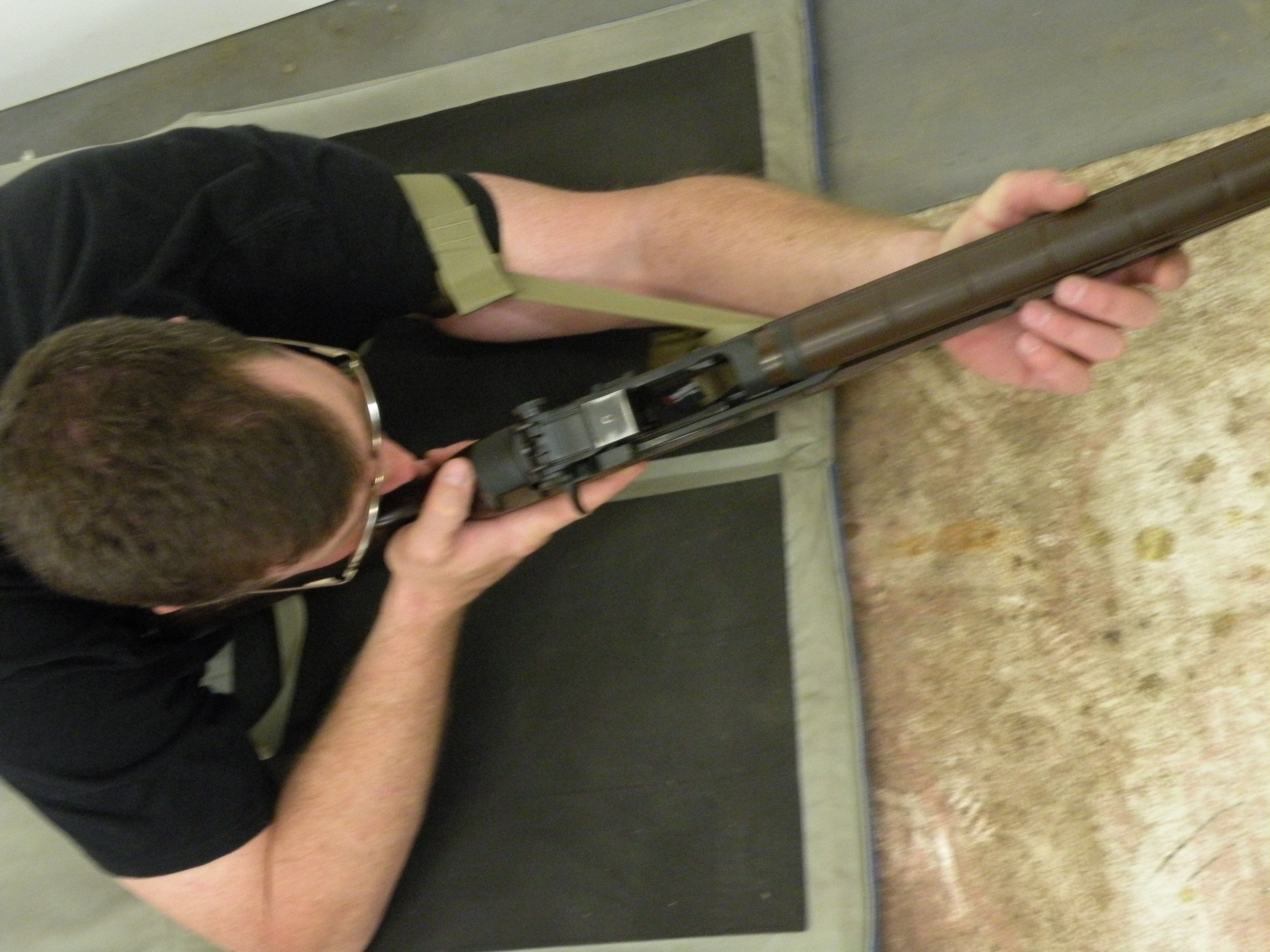

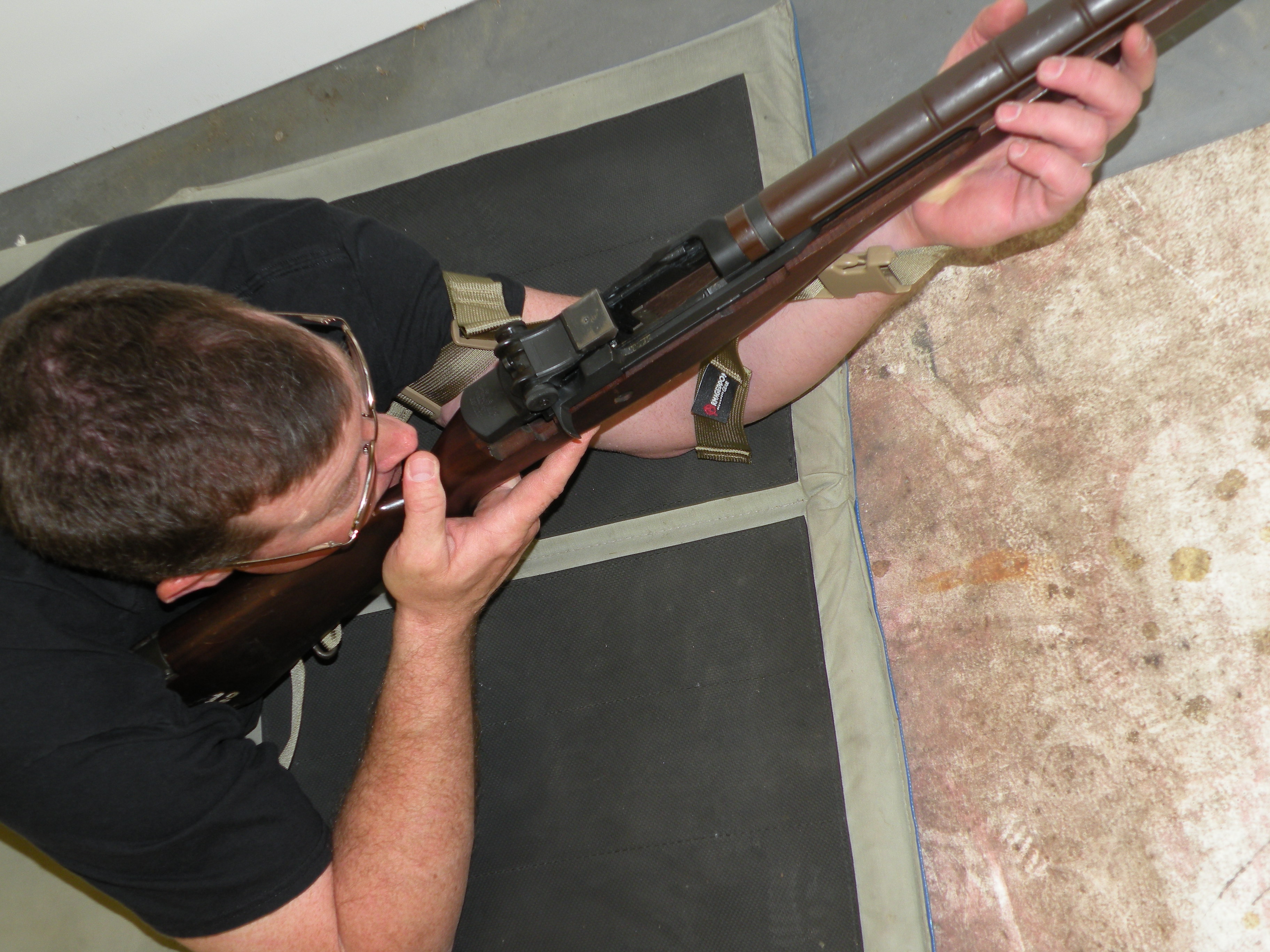

The next point is absolutely critical, and controls BALANCE. You've heard all kinds of folks talking about the recoil of the rifle, and how the darn thing bounces around all over the place. Well, there are a bunch of reasons for this "bounce". One of the predominant reasons has to do with balance. Here's the key: WHEN IN POSITION WITH THE SLING, THE RIFLE MUST HAVE NO TENDENCIES TO MOVE LEFT OR RIGHT. HOW? Ahhhhh.......watch the forward elbow.

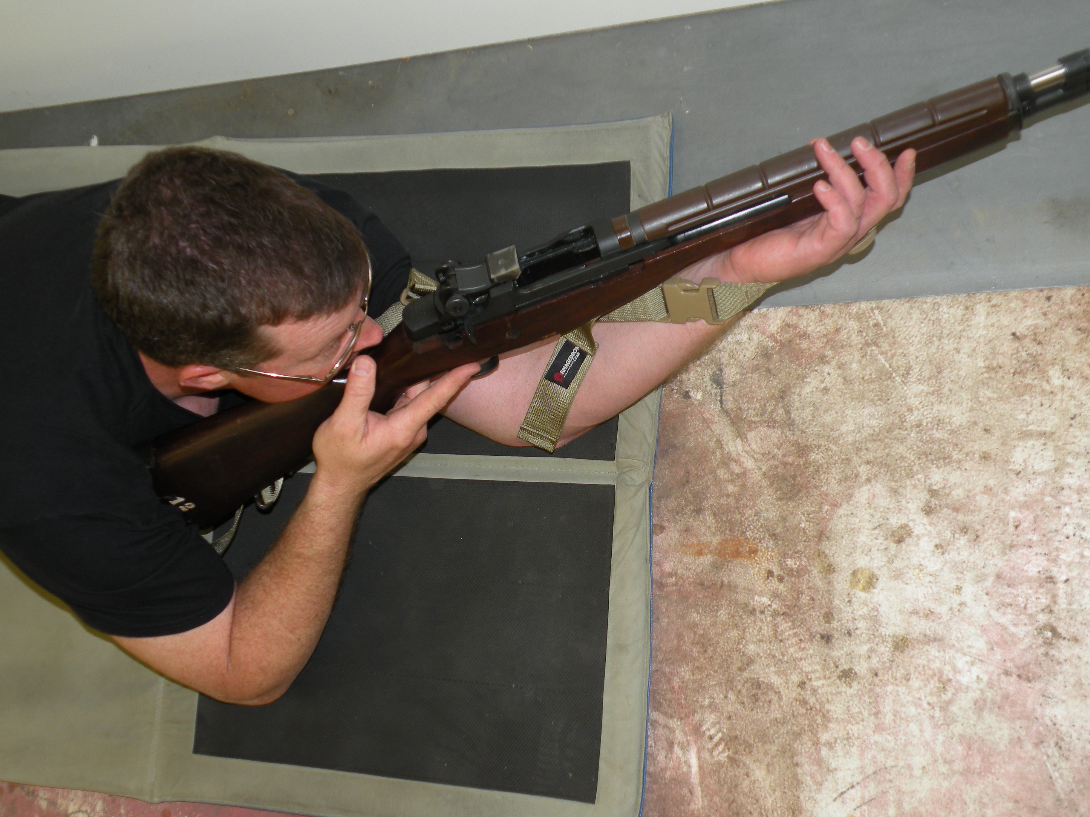

I would challenge each shooter to investigate the placement of the forward elbow, relative to the centerline of the rifle. "Wag" the rifle left and right, as you place your elbow in different locations relative to the centerline of the bore. You will feel the resultant tendencies, and you will "know" when you've got the right elbow position. When there are no tendencies remaining, when the rifle wants to fall neither left nor right, you've got the correct elbow position.
To Natural Point of Aim
Now that you've built your position, the butt of the rifle is solid into your shoulder. That butt is compressing the clothing, fat, muscle, etcetera, all the way down to where you've got a consistent foundation in your shoulder. The sling is supporting the rifle, and everything feels "firm" but not "cramped". You're feeling a little pain in your elbow, in your bicept area, and your forward hand. That's normal. If the pain is extreme, you're doing it wrong. It doesn't hurt to wear a leather workmans glove, or a heavy welders glove if you want to get really comfortable. You can also buy a professional model from Kurt Thune (my favorite), or others, if you choose.
Attain the position, and now push your body forward with your toes. See where the sights went? Now, pull your body backwards with your toes. See where the sights went? Now, pick your lower body up by your toes, and shuttle slightly left. See where the sights went? Same goes for shuttling right. You now know how to adjust your natural point of aim. EVERYTHING ROTATES ABOUT YOUR FORWARD ELBOW.
Nuances
What we've just gone through is the Orthodox method of attaining the start of a good prone position. We did not go through the location of the spine, nor spine squared with the shoulders. We did not argue about a square position or a 15 degree position, and which one is best for recoil. We did not talk about the hiked leg. We did not discuss grip tension, nor head alignment, level ears, rifle cant, the natural respiratory pause, trigger control, the art of the reload. None of it. Granted, each one of those nuances CAN make or break a position. BUT, the goal of this thread is to introduce folks to the science and art of prone shooting. The goal is to show folks that it ain't hard. It's fundamentally easy, as a matter of fact. And, once the fundamentals are witnessed, understood and employed, THEN we can start discussing the second phase.

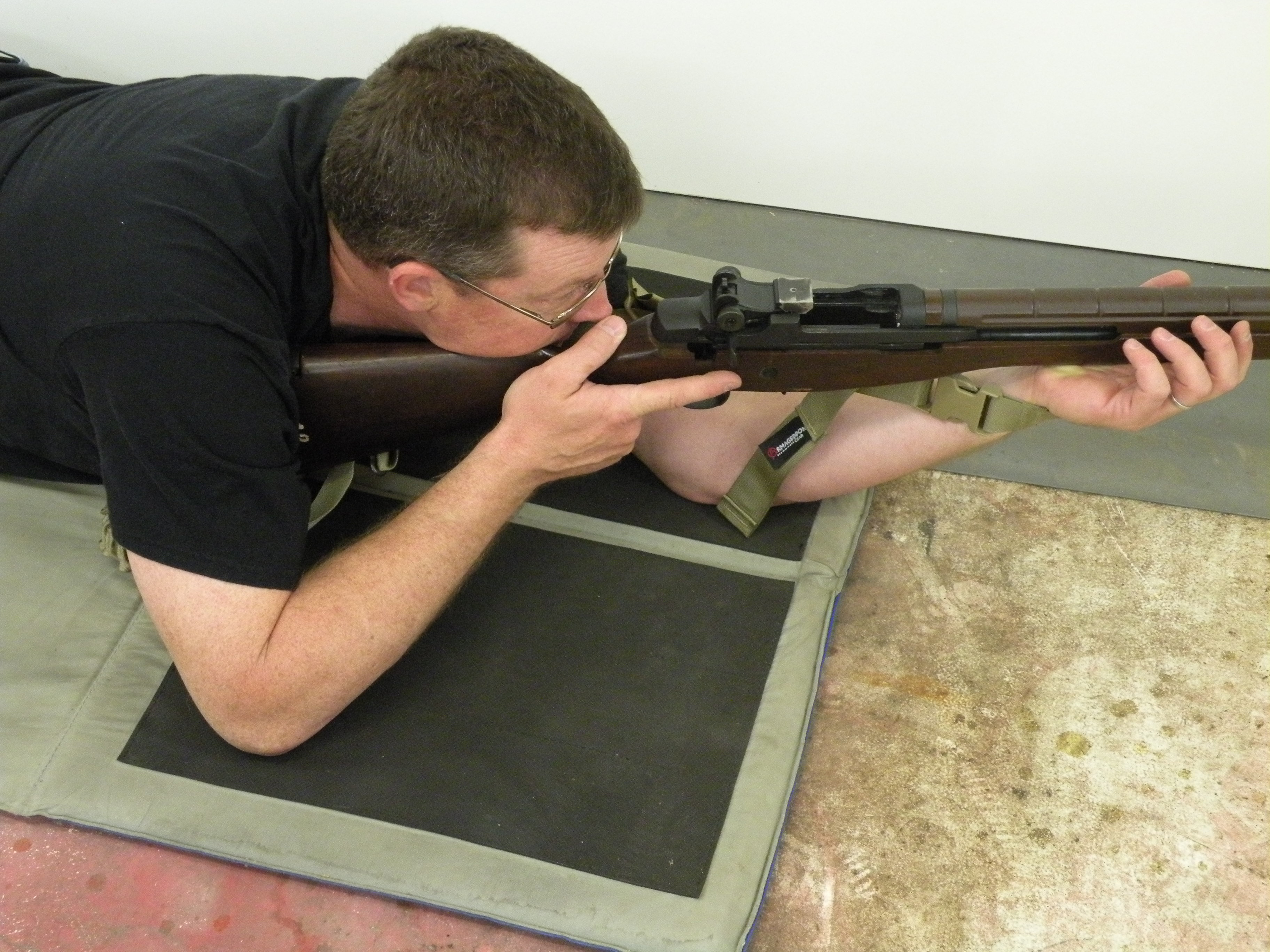

I do hope this thread brings renewed interest to prone shooting. It's deadly accurate, highly efficient, rapidly employed, and one heck of a lot of fun to steer a gun like this. Get off the bench, and have fun challenging yourself!!!! Oh, and for those folks who don't have the money for a rifle sling, I do provide you "the cheap bastard-approved", ghetto-funded, TEOTWAWKI sling. I witnessed a Russian win a Prone World Cup with this technique, and a whole bunch of "high dollar" shooters walk away from the line with their head hung low! No Sh*t. Here, for your viewing pleasure.....

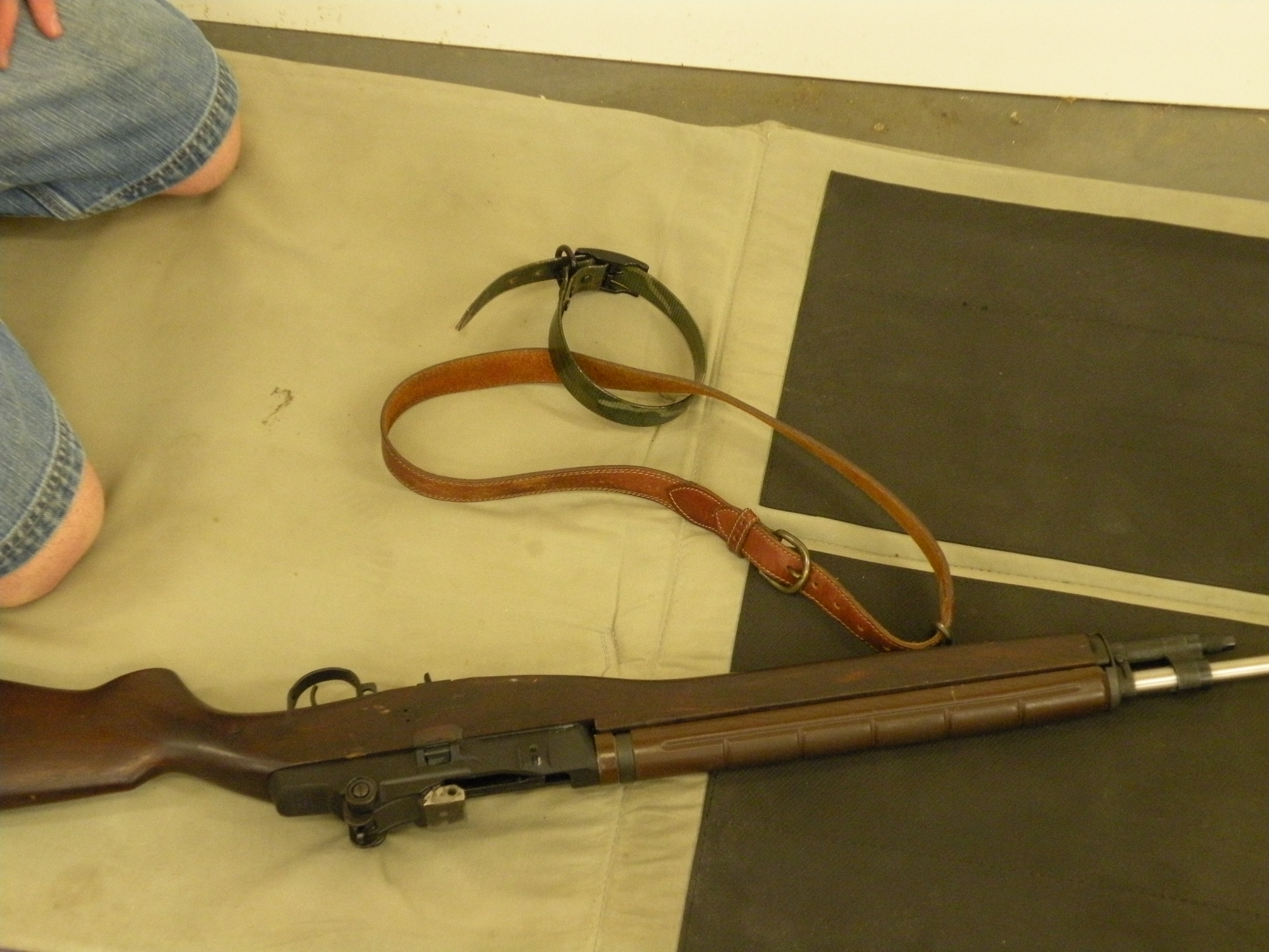

How fancy do you have to get with the sling? Will a piece o webbing affixed to the rifle be sufficient, or does it require an actual loop for your bicep to go through? Would something like the standard VTAC sling be acceptable?
Hi CJ,
I would say that a simple web sling would likely not hold its height against the upper arm. By having a cinch mechanism (forming a secondary loop), I believe a good sling will hold it's location. You'll see various adaptations of the "hold up", whether another sling formed across the back, and to the other arm, or a dog collar and a belt, or a tourniquet-type sling. I do really like the Armageddon sling. It functions both as a carry sling, as well as a full-up tactical shooting sling. High utility, low cost, and very easy to adjust.

For your Appleseed shoot get a basic GI issue cotton sling. One end should have a slide keeper and the top should be secured with a buckle. Its probably the easiest thing to use and it works. Cheap. No frills. When you learn to build your position you become the bipod.
PS - If you are a member of a shooting club/range find the guy that teaches the juniors and ask if he has any shooting coats. Most older clubs have a room of cast off coats and if you can find a used 1950s era Imperial 10X shooting coat you will have a useful peice of gear. The older Imperial 10X offers little for offhand support but it has beautiful rubber elbow cups that offer slip resistance and some pain prevention. The arm of the coat where your sling rides will have a heavy leather pulse pad - your sling can become a pulse telegraph and it gets a little annoying watching the site bounce in tune with your heartbeat.
The 10X is no comparison to a Creedmoor hardback but they are cheap, and you wont get heat stroke wearing one. The only issue I find with them is that they tend to be sized for people from the 50's - read smaller in stature circumferentially. When I see 44/46 sized coats on Ebay Im usually an active bidder. Most are brand new with the only real damage being they all seem to smell of 40 years of cigarette smoke.
pps - A shooting glove for the hand the sling wraps around is recommended for any serious sling range time. $20 at Creedmoor sports for the leather NRA one or use a canvas garden glove. The glove is only for cushioning the sling against your hand. The front hand doesnt even grip the rifle. relax your hand open your fingers and create a table for the sling to pull the rifle steady upon.
Pmclaine, good intel. I've been making the rounds at the local sporting goods stores, but it seems like most of the slings they carry are the padded, quick claw type. I did find a magpul ms3 at one place.
Also, the question about the bipod was just because I put a bipod on my 30-06 back home in Seattle, so I was curious about adding a sling into the mix, but that's pretty low on the list of priorities right now. I really just want to get the fundamentals and basics down: iron sights with either a loop sling or a "hasty" sling.
Your GI original will be found at a real surplus store or perhaps someone on here has a spare. I dont think one will cost more than $15-$20. The M16 models are black and the earlier are olive green. I think length is sufficient either will work.
I use M1907 leather but they are a little more complicated with the claw frogs.
Try not to buy a ChiCom cloth sling it will likely fail/stretch in use. Standard GI is cheap, no padding, and works. Google should turn up many offerings.
