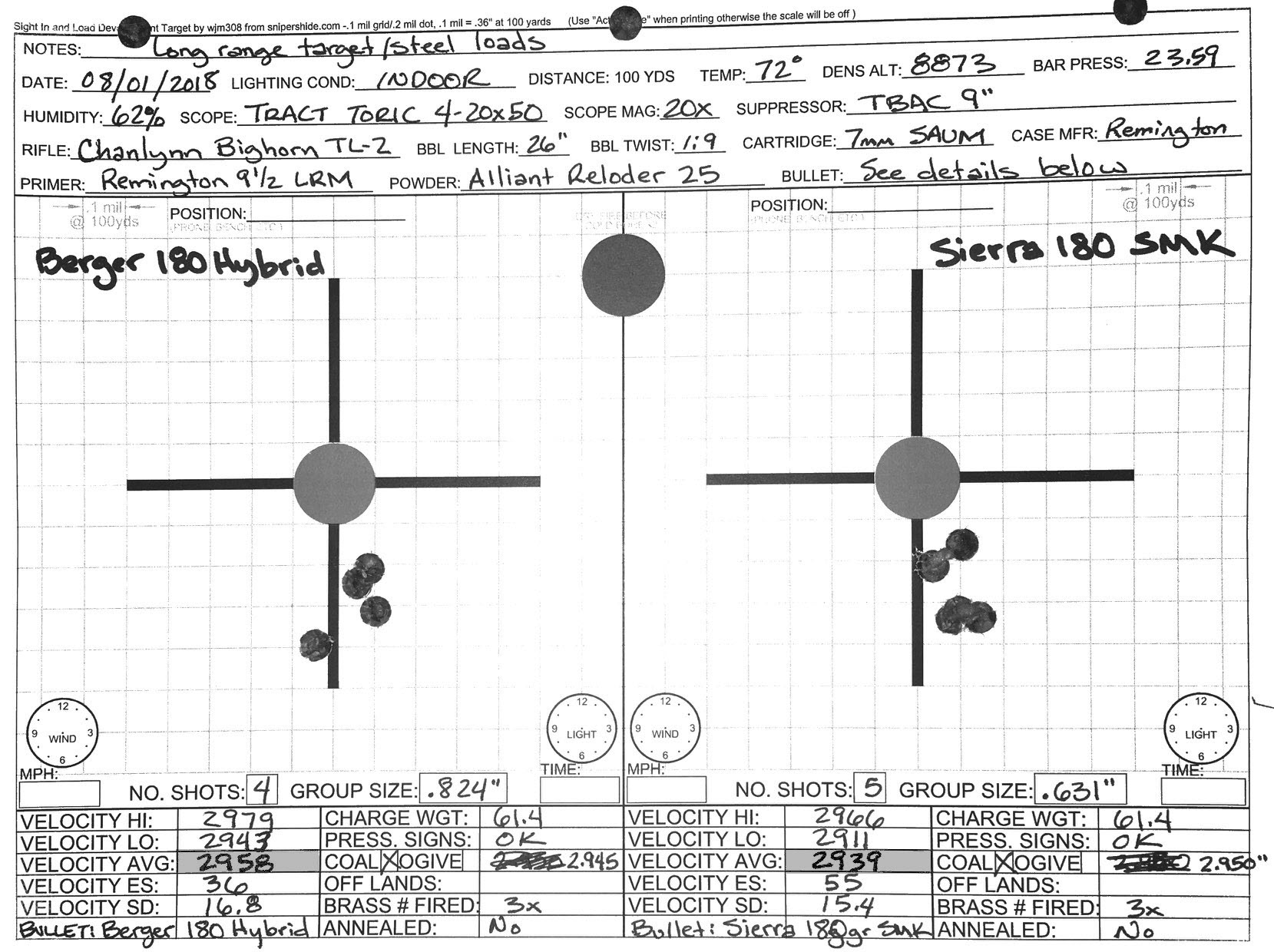

    I may need to get a new barrel soon for my SAUM and was looking at the latest PROOF is offering and saw they offer 1:9, 1:8.4 and 1:8. Maybe I missed a memo or something but 1:8.4 seems a little odd in a world of whole numbers, has the 8.4 twist been proven to show inherent better accuracy vs. other twist rates with heavy bullets or can anyone shed some light on why 8.4? Thanks
    Any change +/- .5 will get lost in the noise unless you are at the extremes. Then too slow and bullets go sideways. Too fast and bullets either don't shoot well or go poof.

    Similar to you bjay, 2958 with RL25 and 180 Hybrids out of my 7 SAUM
