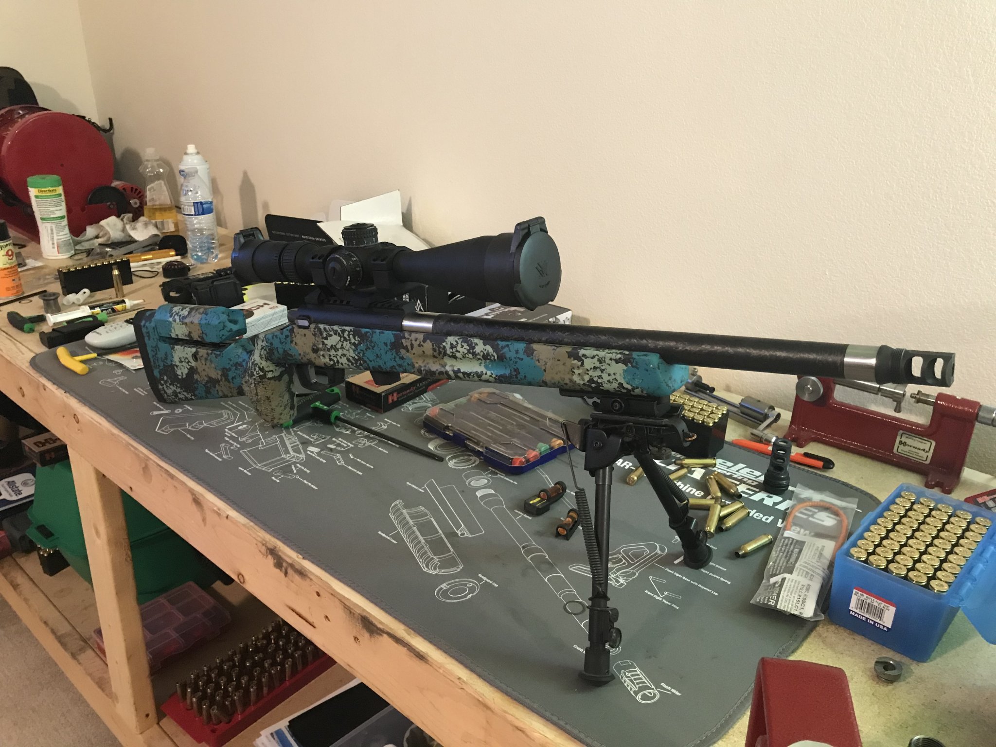

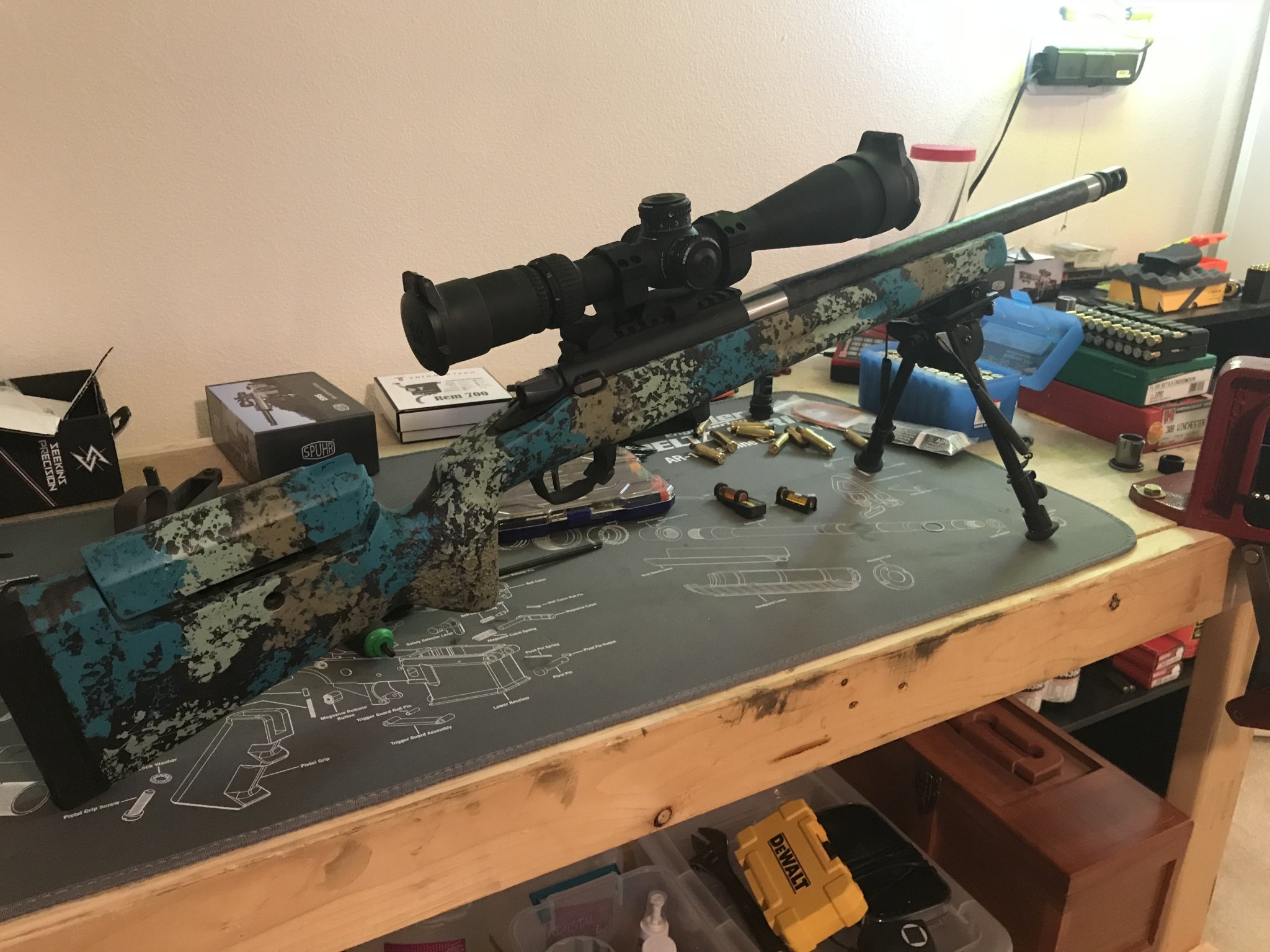

So I’ve recently purchased my first Proof barrel and paired it up with a Surgeon action. It’s chambered in 6.5 Creedmoor and I set this up for a primarily hunting rifle, then precision shooting after. My question is, how many rounds are you guys typically seeing before your groups get respectable? I have had 3 other rifles made or rebarreled, (2 in 6.5 Creedmoor, 1 in 6mm Creedmoor), and they’ve at least had sub-MOA grouping within the first 50 rounds. This particular rifle, however, is not good at all. Best 5 shot group is 1.27” after 50 rounds. 20 rounds of Hornady 140 grain A-Max, 30 rounds of Prime 130 grain. The Hornady had the better groups, but the Prime had the best velocity and the better SD. Just curious if I should start to worry, or give it more time. Any input is GREATLY appreciated.

What barrel length is that and it's that mardi gras molded color?
Ha! No, that’d be a salt Camo from Core. And it’s a 20” barrel that is exclusively shot suppressed. As far as the Smith is concerned, that’s my concern. He’s new to me, but was highly recommended by a few of my friends. So I’m gonna give it a bit, and then approaching that issue.

On another note. Light rifles don't tend to shoot to well! Manners carbon stock? What does the rifle weigh? Do you have a Atlas bipod you could use?

To the OP. The only things that I can discern by looking at your photos is: Scope is really high above barrel (mount) and your harris is unusually high below your stock. What's going on with the bipod mount? This is just knit picking.

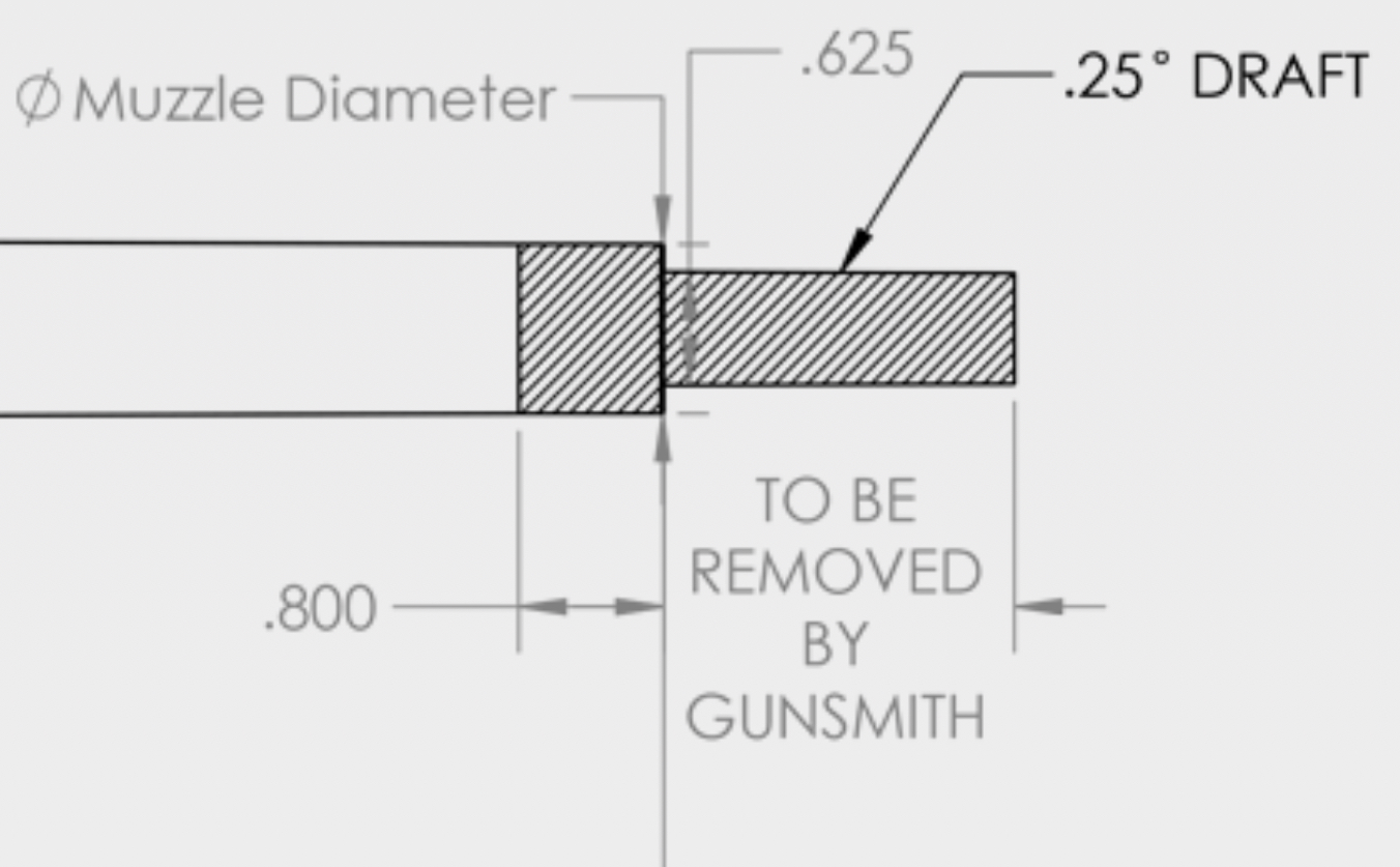

Looks like the gunsmith threaded the "dingus". I don't know what effect that would have on accuracy, if any, but Proof has a sticker that comes on these barrels from the factory that say to cut the skinny portion on the muzzle end off. It's an artifact of the carbon winding process.
I would try without the brake, if that doesn't work I'd have it crowned/rethreaded how it's supposed to be (maybe by a different guy???).

I'm inclined to agree with Ledzep. Your barrel seems to have an awful lot of metal at the muzzle end compared to many of the Proof barrels I've seen here and elsewhere. I'd see if your Smith (or perhaps Proof if they'll cut and thread) can cut back and re-thread the muzzle.
I didn't even notice that before you mentioned it but I think you're right. When I put my muzzle brake on the end of my Proof, there's hardly more than 0.5" of steel showing. It's a Heathen brake so slightly different but still.
If so, OP may want to let that gunsmith know. Proof barrels sometimes get a bad rap from people who had their gun put together by a gunsmith who isn't experienced with carbon fiber barrels.
