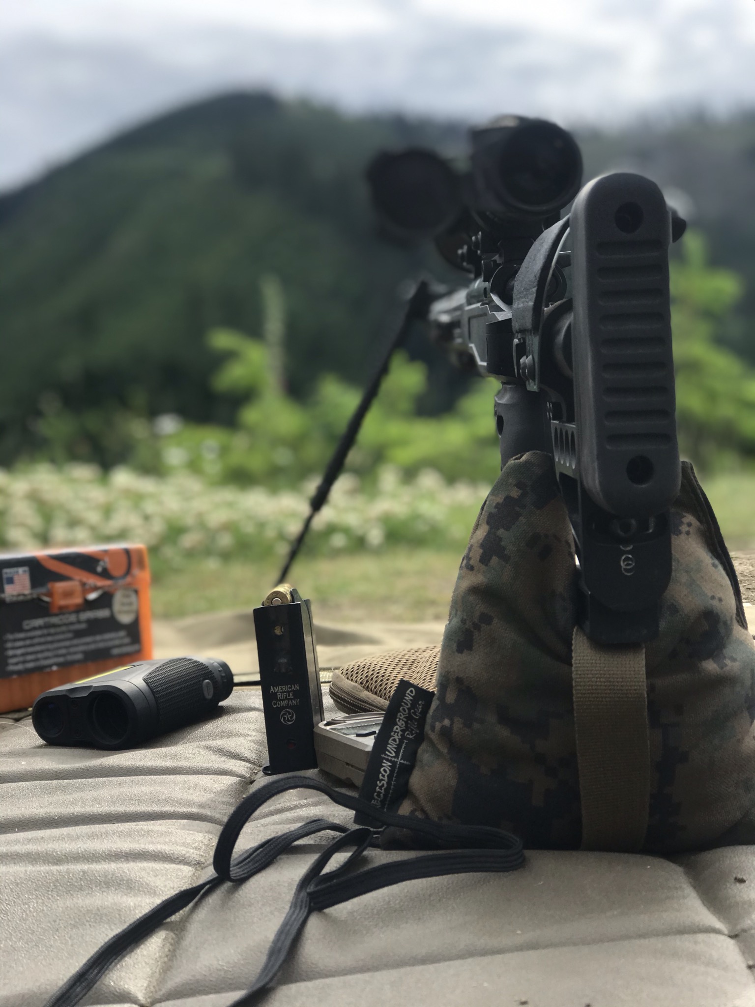

In one of the podcast, Frank makes a comment about lifting the bipods up. (I think I heard right, if not that's what I thought I heard lol) I was struggling to get a friend's 6.5 Creed Weatherby mark 5 to shoot with my normal prone position, which is as low as I can get, so I was like screw it, I'll lift my bipod and get a bigger rear bag so I have to lift my upper body off the ground Abit more. What do you know it went from shooting about 1 moa to .5 moa with this adjustment. Can anybody comment on the mechanics of proper form when shooting from a bipod in relation to heigth. Maybe I've had it wrong all my life trying to get everything low to the ground.
